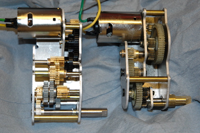

Marc,
As far as the gear boxes are concerned, I don't think you can tell just by the part number. If you can see the gear boxes, the newer have black covers (removed in my picture-left side). They are more durable and slow the tank down by about 30%, but it is still too fast for a Tiger. This should not be a real problem unless you planning to run it in battles with people who are concerned about 'scale' speed.
We run quite a few tigers in our club and most are stock. The metal tracks are nice, but can add strain to the entire drive train. You might want to try the stock tracks first. Some people love the suspension upgrade from wechoe, but its is a bit expensive. The metal barrel can be nice because you don't have to be as concerned with sanding the seam away from the plastic barrel. I had issues with the seam and the recoil unit that took me a while to figure out.

the "newer or better" gearboxes come in all tamiya tigers now. They are the ones with the black plastic covers. 1st generation gearboxes didnt have those covers and had a different gear arrangement. Those boxes would torque and self destruct over time. If you do get the metal tracks for the kit it is HIGHLY ADVISEABLE that you put a rubber bush around the rear idler/tensioner axel or there is a 95-99% chance it WILL shear one of the axels from the tension and added weight of the metal tracks. The suspension overall is very good and very rugged. personally i dont believe it needs any kind of enhancement. Personally the added expense of the "UPGRADES" for the recoil and suspension arent really that important and what they do add to the model is barely noticeable at best. IF What you pay for those upgrades and what you get in the end is worth it is up to you.
