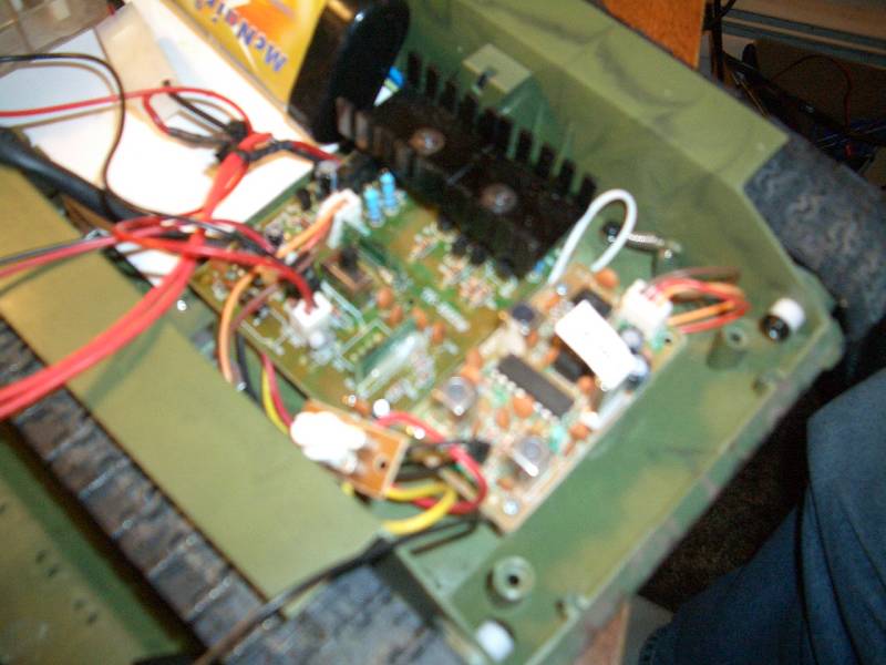

ORIGINAL: swathdiver
I fried mine too this week, twice!
Have you tried turning the boards over and putting a heat sink on them? You might be surprised.
Old 03-21-2007 | 09:49 PM
YHR's Avatar
YHR
Joined: Nov 2006
Posts: 8,976
Default RE: HL Pershing relative performance
ORIGINAL: pscartozzi
I do this all the time now. I seal up the bottom of the tank and move everything around with the heat sink up. Haven't had a problem since. If you go to a computer repair place you can buy stick on heat sinks that can improve the cooling effect. My opinion of Heng Long electronics has gone up considerably since.
Old 03-21-2007 | 10:02 PM
Perry S.'s Avatar
Joined: Jan 2007
Posts: 2,125
From: Clifton Park, NY
I just went to Radio Shack and bout a couple for $2. Blurry pic but you get the idea.

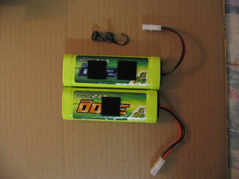

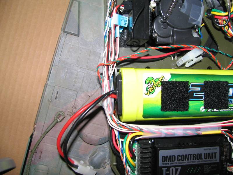

Old 03-21-2007 | 10:36 PM
CapnCrunch43's Avatar
Joined: Jan 2006
Posts: 605
From: ..., IL
The Venom 4200 (and possibly the 4600?) are a tad longer than the 3600. Just enough to where I would have to cut the battery tray in my Tam Leo 2A6 for it to fit.
That's the 4200 on top.

Perry S.'s Avatar
Joined: Jan 2007
Posts: 2,125
ORIGINAL: Harquebus
pscartozzi, YHR et al:
How do/did you attach the heat sinks? Was it easy? does Radio Shack have the press-on type?
THe heat sinks have a hole, I just drilled a hole in the aluminum HL heat sink and through-bolted with a 4-40. Make sure to use heat sink paste for good thermal contact. THe stick on types generally have more thermal resistance and I did not see any at RS.
