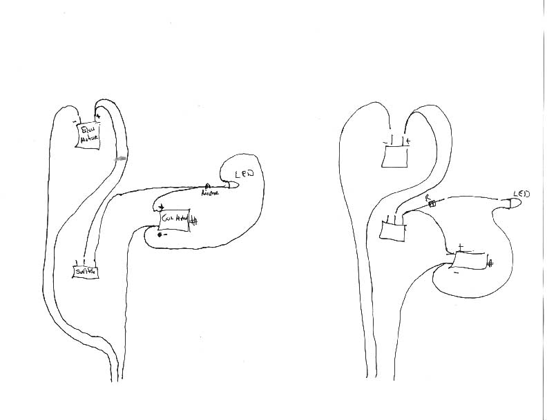

Almost finished my HL Tiger, and most wireing is complete. I need help on some of the wires though. Anyone got pics of the complete wireing inside the turret and the head lights? I've searched the forum, but there's so much stuff here.
I need to know where the headlight wires go. Also, in the turret, the little motor unit that drives the cam to raise and lower the gun, has 3 wires. 2 red ones, and a yellow one. I've connected the obvious red and yellow wires, but where does the 2nd red wire go?

I have the same questions. Does anyone have wiring layout/schematic for HL board?

I wrote it on an envelope I had laying around, let me see if I can find it and scan it for you. As for the board schematic, been trying to since I got into the hobby, no dice.

Alrighty, the diagrams are the same except for the placement of the resistor for the gun LED. Some tanks have it attached to the switch, some the LED. The wires at the bottom are typically Black, White and Red in that order. The black wire goes straight to the negative terminal on the barrel elevation motor, the red to the negative terminal on the gun motor (motor spins backwards) and the white to the positive terminal on the elevation motor.

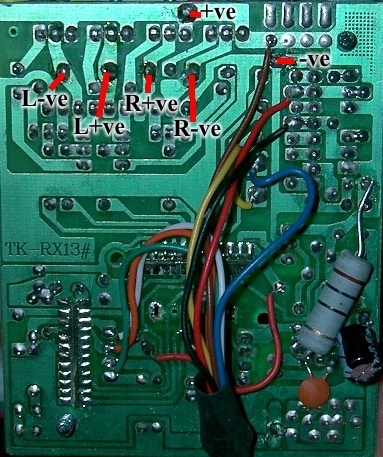

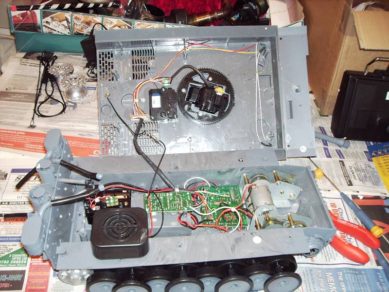

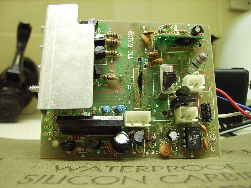

hope these might help...

Can you label the wires in the middle picture?

the wires that go through the black wire sheath all go to the multi plug
that powers the turret headlights etc as can be seen in the first pic... there are no power
or motor wires soldered to the board as yet ... the 3 wires on the right hand side
are from the volume control...

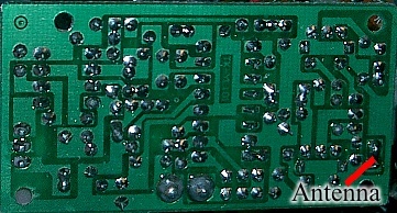

Here's some more:

Those are great pics but I could use some pics of the wires on the two boards, mainly the power connections. If anyones got them. Thanks
