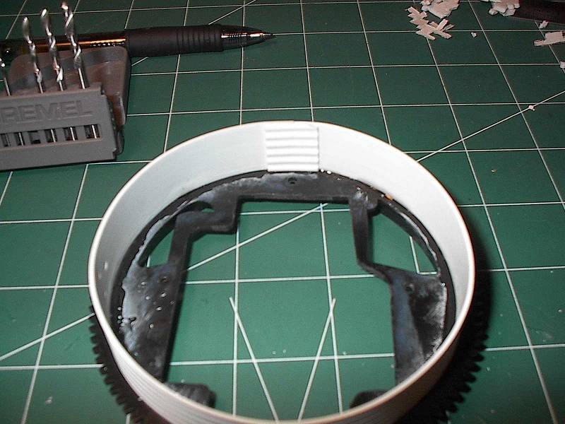

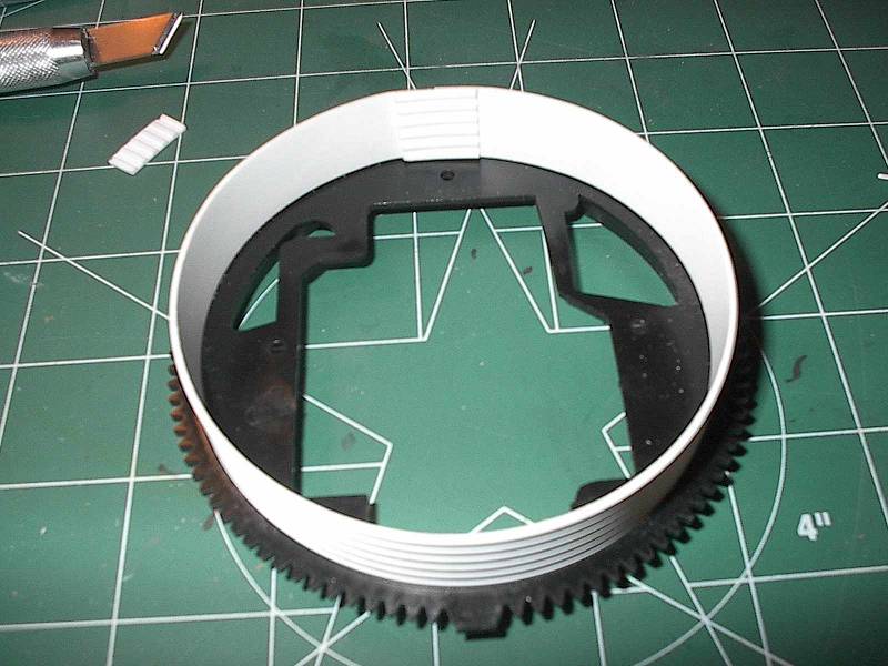

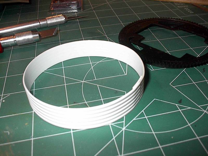

Howdy fellow tankers! Finally some progress! After quitting in despair earlier today I change my approach and conquered the beast!
Was having a hard time cutting the 1mm wide strips of copper foil with my paper cutter. Twisted the machine around, cut 1mm marks with my hobby knife and voila!
OK, about this project. My goal was to produce a simple and reliable 350 turret ring that everyone should be able to make that in addition to the 3 wires that usually go up there, two more for options. In this case, the antenna wire and battery on power for the wireless camera that will go into my M26A1 project.
[link=http://www2.towerhobbies.com/cgi-bin/wti0001p?&I=LXF857&P=7]Evergreen Styrene[/link]
[link=http://www2.towerhobbies.com/cgi-bin/wti0001p?&W=001200560&I=LXS031&P=K]Copper Foil[/link]

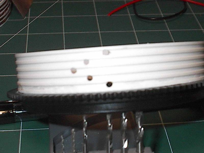

The Evergreen metal siding is used so that the rods will have a groove to ride in. This will keep them from slipping and crossing circuits when the tank is rolling backwards off that 80 degree hill you thought you could climb! In order to maintain that groove its important to keep the copper foil as thin as possible, in this case it's .005" thick. I've spent a lot of money on the wrong parts or parts that made the project more complicated, even after drawing diagrams and doing lots of research.

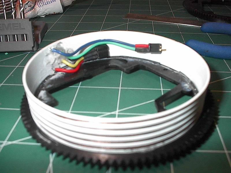

Anyhow, The ring is glued with CA to the toothed ring and then holes are drilled through the grooves for the wires to attach to the foil, they are soldered on first then the wire is slipped through the hole and the copper foil is glued with CA in place. The inside where the wire goes through the styrene is sealed with Clear RTV silicone. A 3-pin and 2-pin WS Deans connectors are used.
The copper foil will be cleaned up with the Dremel to remove any excess glue and then I'll put electricity through it again. After that I'll tackle the next other half and post the results.

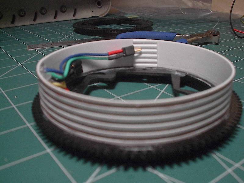

Rathead123: Power to the camera will be on as soon as you turn the tank on, before it's fired up. Am keeping the smoker. The red wire goes to the negative terminal on the gun motor right? That's because the motor spins backwards.
Amuro: The foil is on, the check out the bottom two photos.
dsketcher: The ring is wide to allow the airsoft unit to function. Remember, this mod is designed so everyone can do it.

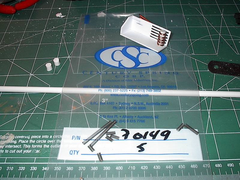

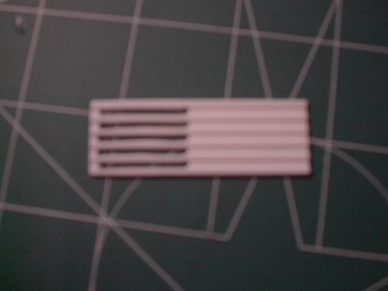

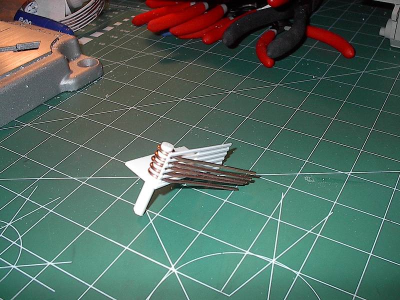

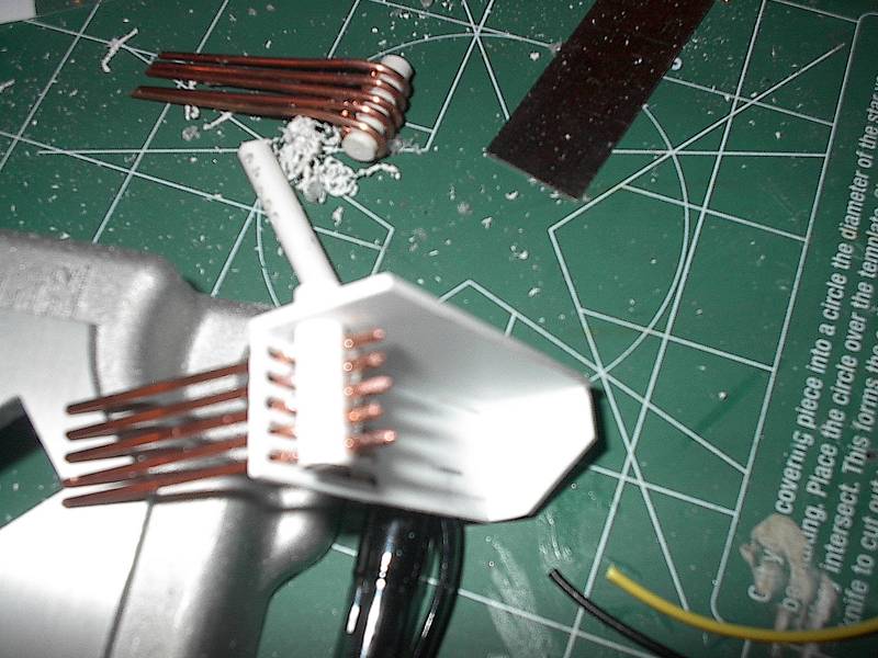

It worked perfectly! Sort of. I hooked all the wires up wrong and it wasn't until after I tore it down and reverted back to a standard setup did I finally understand that 2 of the wires were grounds and 1 positive, and that the grounds were turned on and off by the board to activate the gun and elevation unit. So the unit is complete and works quite well. I was going to install it in my 211 Tiger but the electronics took up too much internal space and I didn't have the room to have the slightly deeper ring hanging down. It will go back into another tank, just no plans at this time. Well, I'm not doing anything with my tanks at the moment or in the near future anyway.
I just used standard Great Planes medium grade CA for everything. The thin stuff runs all over the place and makes a mess. The pics aren't very good but should give you an idea how I did it, the springs were cut way down, eventually a piece of styrene was glued under all the arms and only 2 springs used to provide tension, one spring per line was too much tension.

It didn't work because I wired everything up wrong! There's a reason why I have 2 - 1gallon zip lock bags of blown up boards!
Yes, the electronics tray I built for the 211 Tiger will not accomodate the ring unless I redesign it. I have plans to ditch the airsoft unit and install an infrared battle system and recoil unit.

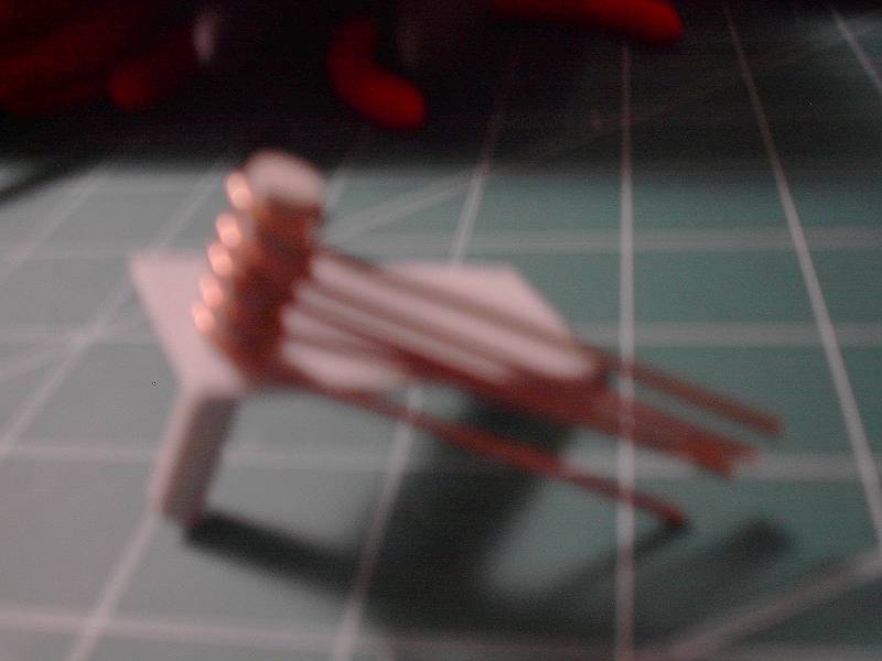

The springs kept tension on the ring so the arms wouldn't lose contact, especially when the turret turns toward to the end of the arms. Originally I had springs under each arm and the tension put too much strain on the turret motor so I removed all but 2 and shortened them a little.
Not shown is where I soldered wires and connectors to the arms where they wrapped around the support. I wasn't big on taking pictures back then, and pretty bad a taking them too!

I put a piece of styrene between the spring and arms so nothing would short out. Just used CA glue to keep everything in place.
I think the depth was 5/8" for 6 power lines. Each groove was spaced by .125". The link to Tower Hobbies still works.

No, the friction was from having too many springs pushing the arms into the grooves, especially when the turret motor turned backwards. Removing all but 2 springs provided enough tension to keep the arms in contact and allowed the turret to move freely.
