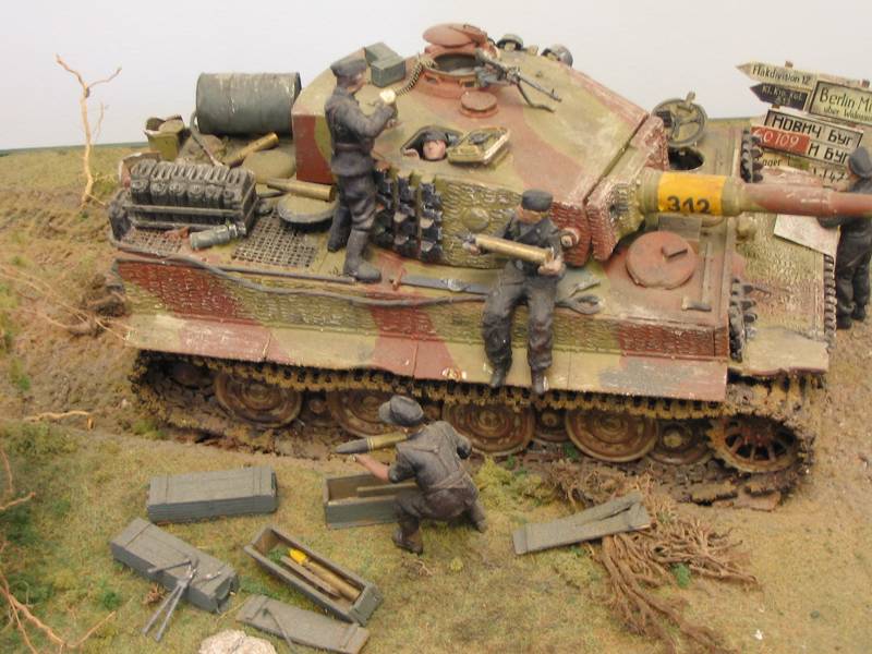

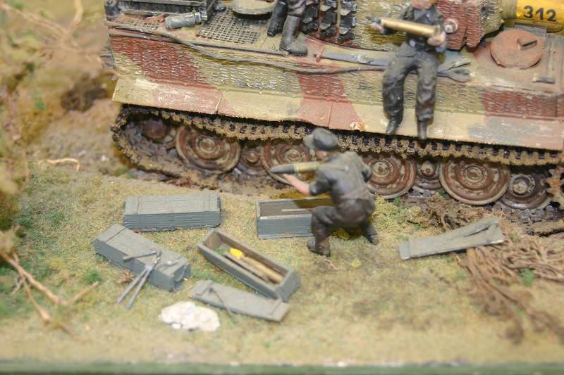

Zimmerit was a cement-like paste applied to German armor in WW II for protection against magnetic mines. Any reference books on German Panzers will show it on many tanks, mostly Pz IV, Panther and Tiger family. There are a couple sites in Germany and England that sell the zimmert kits that you can glue on to the tank. Otherwise you can use modelling paste and smear it an yourself, then use a screwdriver blade and make the marks. I just got one of the stick-on kits in the mail yesterday and it looks nice, but haven't had time to put it on yet. Here's a couple photos of a 1;35 Tiger 1 model with paste and screwdriver work.

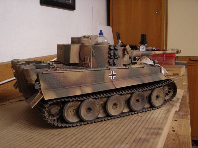

Here is a picture of my Tiger. I used Tamiya putty and a comb. The putty is a solvent and softens the plastic and the comb scores the zimmeritt pattern. Most like their zimm to be more obvious or "stand-outish" than this though.
Welcome to the boards. Most guys here expect you to do a basic search before asking questions like this. Some topics have been covered ad nauseum.
