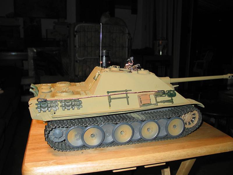

Has anyone else besides me used the combat circuit offered by Tankhobby?
Here is the URL http://pages.cthome.net/chioc/index.htm
With the latest upgrades the system is even easier to install than before. The kill/shutdown relay connections now just solder directly to the circuit board no additional electronic parts required.
It comes complete with the IR dector board which has 4 IR sensors mounted, along with a hit indicator LED, I understand that another update is planned to make the hit LEDs easier to see in bright daylight conditions.
The only parts that are not supplied are the sound module and amplifier/speaker. Thease are off the shelf units and cost around $20 total to add.
I have setup and used a total of 4 such units and compeated in the club battles. They are Tamiya compatible which means that they will take and give hits to Tamiya equipped tanks.
The only flaw that is noticed right away is that the Tankhobby unit does not degrade the throttle when hit, the excellent points are that rate of fire and number of hits are indpendantly set. Also there is no automatic restart, this requires user interface.(must manually push the reset button to restart)

I'm working on a connection that will allow using the Tamiya TBU (apple) with the system. This way one doesn't need to figure out a way to mount the detectors and hit LED. It will require the purchase of the TBU separately and utilize just the apple portion.
As far as reducing the speed that is a little more complicated as there are several ways to do it and problems with each. Most people using non Tamiya tanks will use the electronics that came with the tank or a separate ESC. They all differ, in addition the motors may be different, whether stock or aftermarket ones are used. So to design something to reduce speed by 25% or 50% becomes complicated. I will need to look and test more.
Bumping this to see if any updates are available, I remember RealZardoz was talking about a Tamiya compatible system he was working on. Anyone hear from him or any other new IR systems?
I have performed the Tamiya TBU interface with the Tankhobby combat circuit following Nick's instructions and the setup works just fine.
No problems have been encountered so far. Tests continue, and live fire exercises being planned soon as well.
