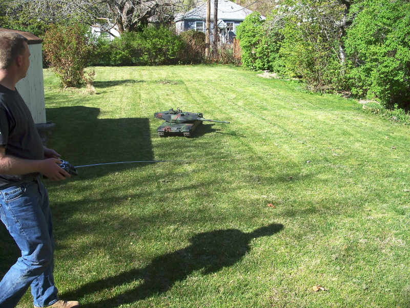

Earlier this week i finally got my replacement tracks in and gotr the Leopard going again. While it was down i rechained the drive motors with a more robust chain and refined the tension adjustment on it. Touched up some paint spots and installed the simfire device on the turret. It was near the 70s here in Salt Lake City and the perfect day to take the Leopard out for a run. I went to the mudhole nearby and had a good run there. No track issues. But i forgot the camera and the tanks batteries ran out. So i brought her home and charger her back up. My wife took these pics while i was driving. She also snapped a shot of it next to the 21cent 1/9 M1A2. Its amazing the size difference between the scales.
Enjoy!
Video to come soon too

I wouldnt blame mark. He just sells the stuff ita all made in russia. The Leo/Challenger2 tracks are problematic in that they are multipart assemblies like the real thing. a pad and 3 linkers for each full track link. The pins are quite tight honestly. Its the linkers that work loose or crack. Mine had a peculiar issue which aggrivated the problem but that is fixed and i havent had a problem since. Just check over the tracks before and after each run and give them a little look while its running. I wish the end linkers worked more like the real thing where a bolt in the center of it clamped it tight onto each pin.

Well the problem was the track catching on the front idler mount then being forced under and bending the pin. This was then shearing the pin through the track itself. I dremeled out the offending area and havent had an issue since.
To keep the linkers on i just hit each one with some CA glue and let it soak in. This tightened up the tolerance fine. I just do an inspection before and after every run and reglue the 3 or 4 linlers/pins that show signs of shifting.
