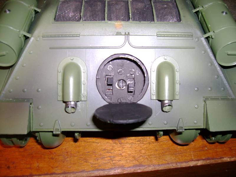

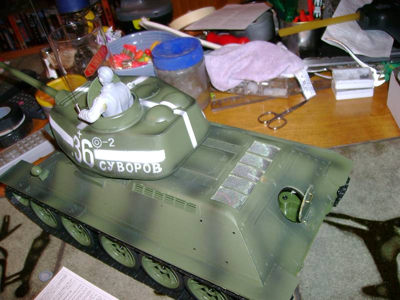

Hi - since im still waiting for my uppgrades to my Jagdpanther ( metal tracks S/S uppgrade ) , so I have been starting out with my T34 a bit , fist I placed some fiberoptic in the Mg ( is there supposed to be a Mg in the turret as well ??? ) , and that was a bit hard since the original barrel is about 2 mm in diameter ( tough job making a hole there ) .
I have also started to open a few hatches - comandercupola , the rear engine hatch ( gonna place all the switches there ) , and im planning to open the other hatch on the trurret .
I replaced the fake plastic mesh on the engine with some real mesh - looks so much better...
I also made the comande , and Im working on the driver ...
A happy surise was that the drivers hach did open ( did not know that )
Planning to get the Hl gun in there later + the S/S uppgrade .... Im waiting for metal tracks and metal suspension - bit suprised that the drive whell dont seem to be avalible in metal ... bit worried about durability with plastic drivewheel and metal tracks ...

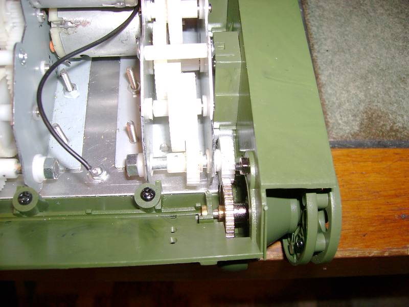

Hi

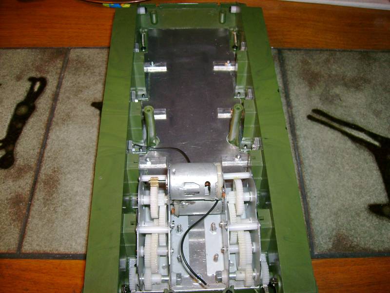

Have now done some remodelling on My T34/85 - after checking pscartozzis Su-100 thread ... I got some ispiration ..
I did some chassie stiffening ,and since I already had one pare spare HL gear box I decided to try and use it -(metal upgrade to be done later ) .
Im also gonna change the turret gearboxes , it did not sound any better with 7,2 volts running them so.... the turret gearboxes sounds like when my cats are fighting with foxes at night ....

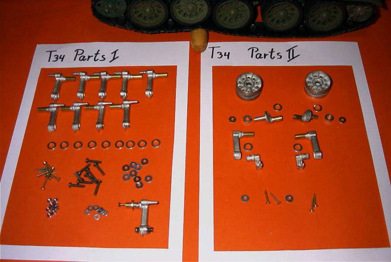

Hi just recived the metalsuspension from e-bay , but I only got set 1 [&o] - was under the impression that both was included in the auction ( my german is nos that good - used a online translator ) .... so I have just asked the seller how to get set 2 .... hope I can get it soon ...

This is where I got it - but that was only set 1 .... I have asked the seller - and he could deliver set 2 as well ( for more money naturally ) .... for some reason he delivered 1 extra pair of suspensionarms in set 1 ...

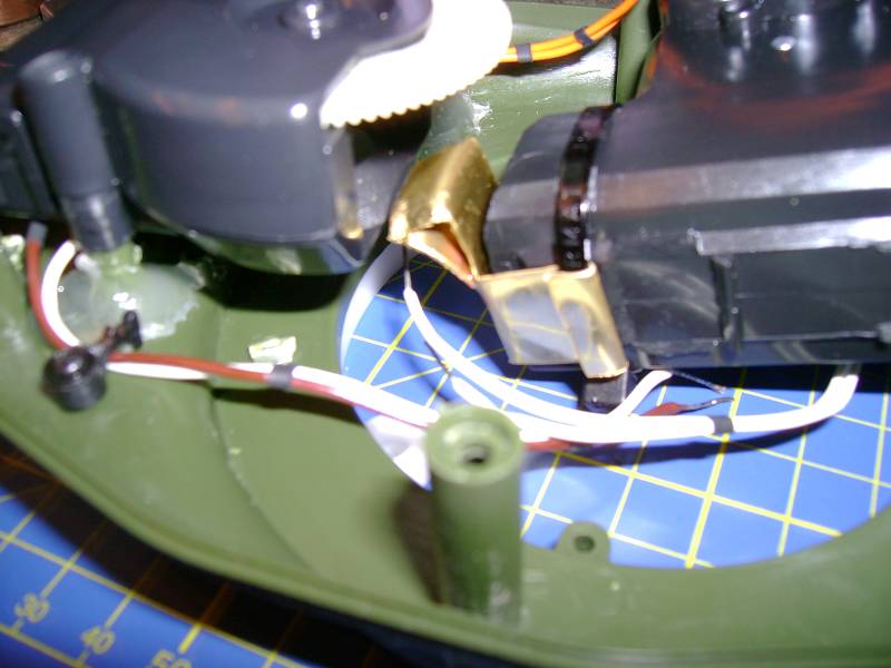

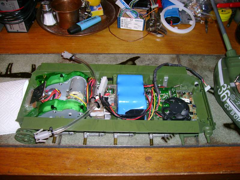

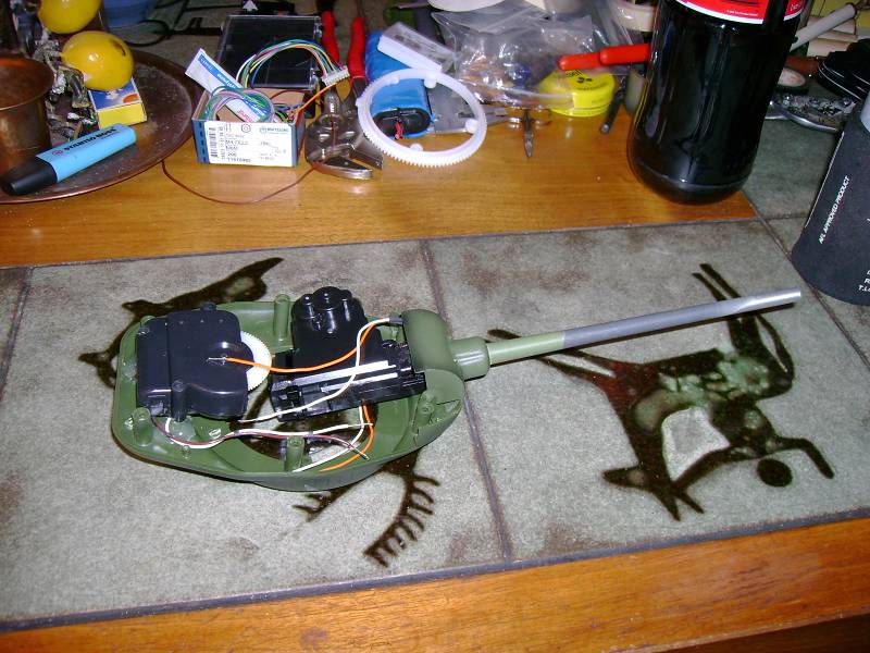

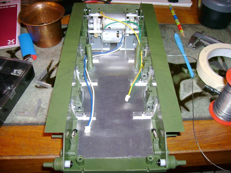

Hi - I have now done some more All the electronics is now at its place and in working order ......
It sure got tight , so I had to flip the gun to the side ( to make more room in the lower hull ) , and I had to make some remodelling on it to make it fit - cut away a lot of plastic ....
Changed all the turret gears to HL - sounds much better ...
I also placed a cpu fan on the boards ( air intake trough drivers hatch ) , it got so tight in there so im a bit worried about the heat ...
Made my own 7,2 v battery - the standard one just would not fit in there ...
The smoker was a bit tricky , had to place it behind the gears , and since the exhaust is on the upperhull I had to make it possible to take apart ...
I had to place the speaker on the rear engine grill , so I had to make a separate 2 pin connector for the speaker - don wanna have to unscrew the board every time I open the tank ...
Planning to make a separate 3 pin connector for the turret as well - for easy accsess ...... did the T34 have a parralell turret MG ???
Have yet to do the connection between the lower and upper hull , but all the led:s , turret motors , firingmotor is tested and working as it should ...
I still have to do the pellet feeding for the gun , and place the gunswitch , but Im pretty sure how Im gonna do it - have to open the other hatch on the turret ...
Have yet to recive the second set for the suspension , but Im not in a hurry - its summer time ....
