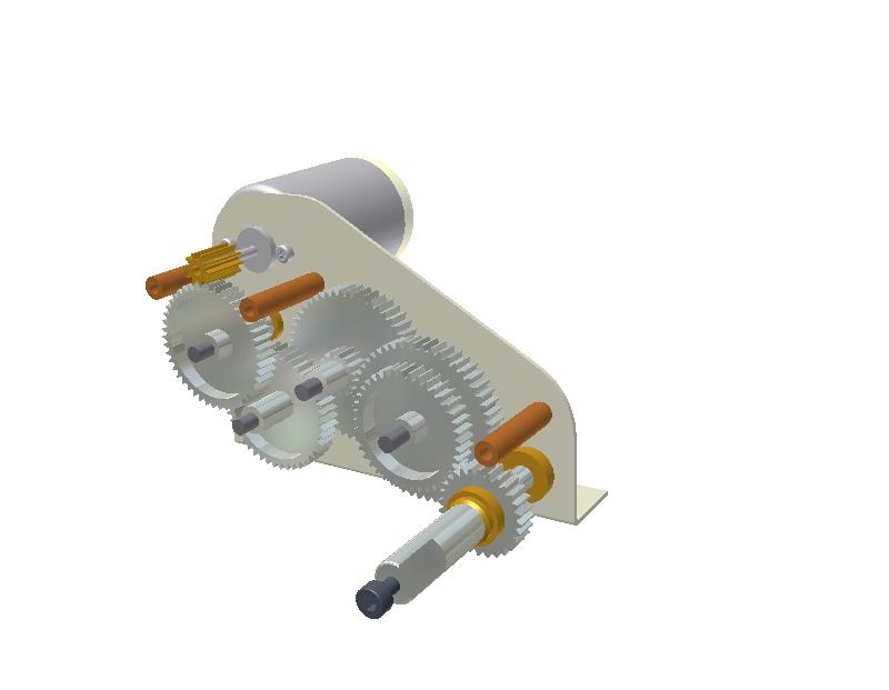

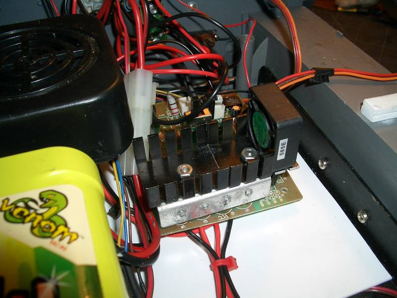

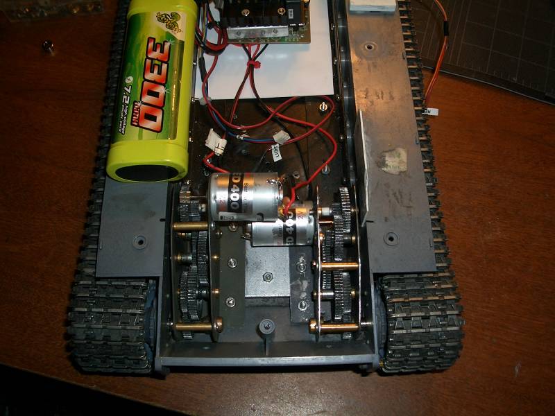

Finished upgrading the drivetrain in my Heng Long Tiger. I made custom gearboxes which I added another 3:1 reduction gear. I used all HL metal gears and made the sheet metal parts. Adding the extra gear reduces the strain on the motor which I hope will let me use bigger motors without blowing the electronics. These are Speed 400 motors, 7.2 V. Added a heat sink and fan to the HL elec's to give them every chance. rest of the drive train is metal tracks, arms, rear axle and new springs.
Great torque and a more realistic speed. Let you know how the elec's hold out.

I get my torque from the gearboxes like one should, since I have a 3:1 reduction I need the higher speed. I wouldn't say 400's have more rev's and less torque across the board. Many different variations depending on magnets, windings, brushes, etc. THese ones have more torque and speed than the stock HL 380's
Forgot to add, anytime you replace a cheap Chinese knock-off with a Japanese or German motor, expect huge differences.

Only one thing if those speed 400 have advanced timing on the endbell wich i think they might then your tank won't run properly when turning and spinning the motors will be turning at much different RPM and it will cause the motors to fight against each other causing one of them to draw much more current... May blow something out?

Shen, might be right about the timing but I just made it through my 3rd charge and everything seems to be holding together. Hard driving too. No trim needed so I think I will be alright on the timing issue. Let you know how long it holds out.

If you look at the CAD model above you will see that the first two gears off the pinion are the same. The first one is the modified one. I had to cut off the 'stand-off' part then push the pin through the gear and re-add the standoff to the other side. If you look at the pic's you can follow what I am talking about.
Hope that helps.

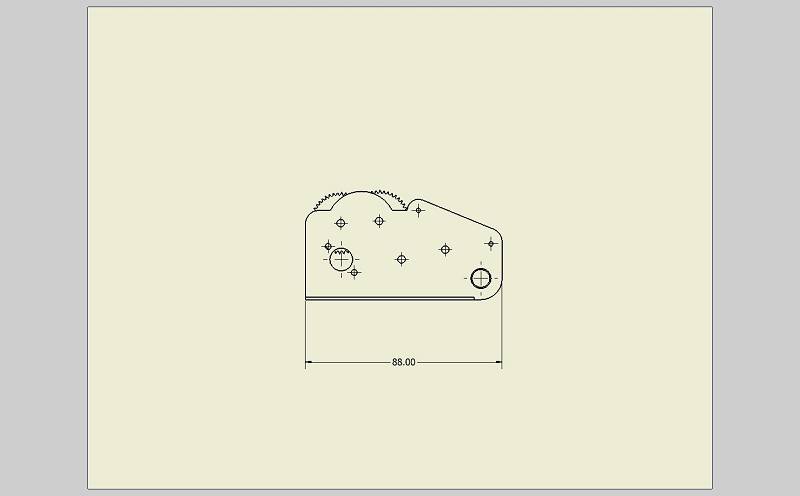

If you had the CAD drawings and were willing to share, perhaps you could convert/scale them to size and release a PDF of the sideview of the two sides of each gearbox. Then people could print it out (and hopefully it will print out at the right scale being a PDF), tape them to a piece of sheet metal, and have a template for drilling, cutting and bending.
Might not fit every tank, but it would save some others having to experiment with dimensions themselves.

I need to make some changes to the CAD models as I made some on the fly changes. In the mean time, here is a side view of one of the GB's. If someone is really interested in trying this I will have to spend a night getting the drawings in proper order. You should be able to print it to scale. I put a dim on it so you can check.
