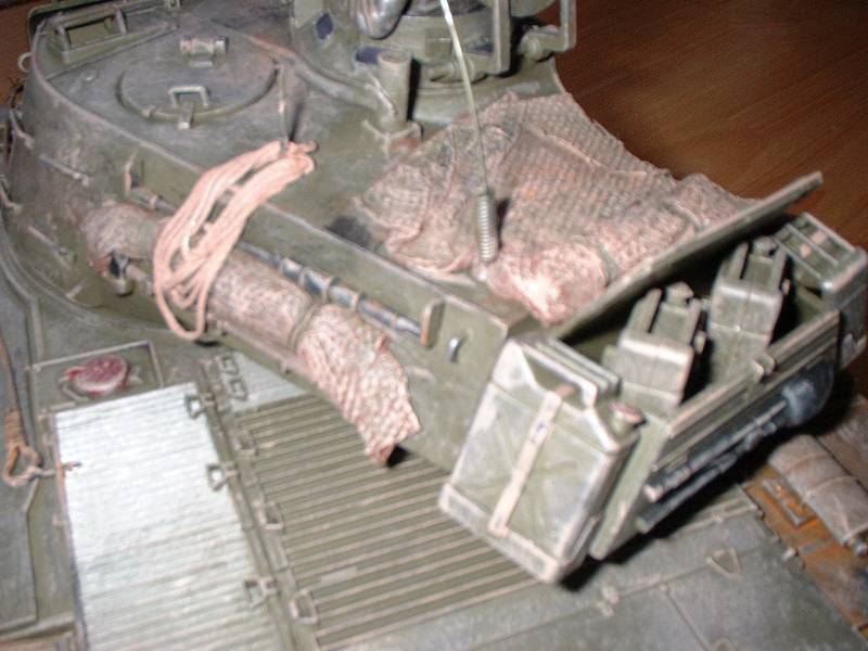

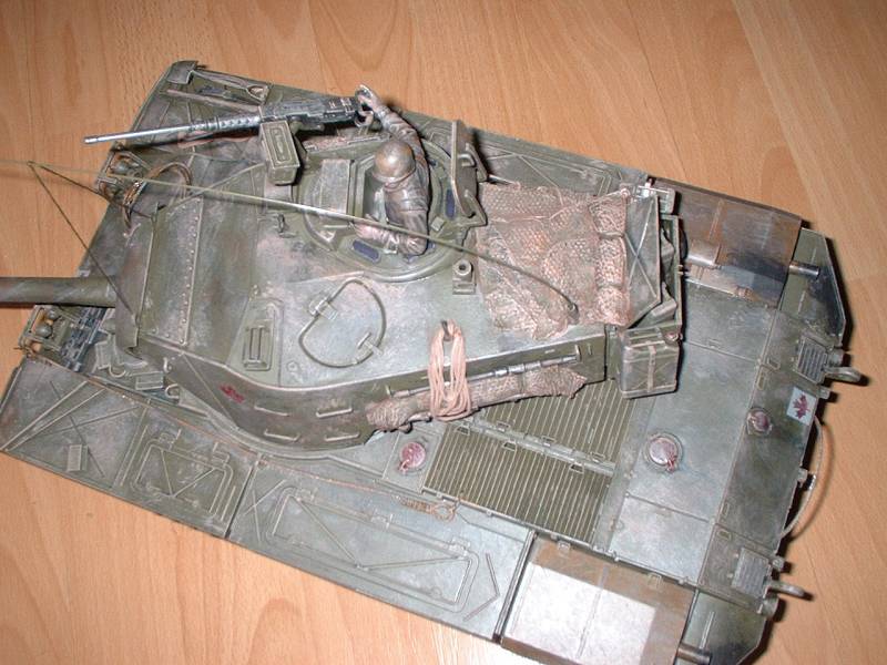

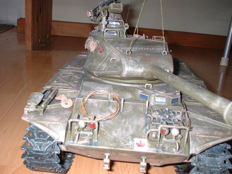

Old 03-12-2008 | 04:40 PM
Joined: May 2007
Posts: 37
From: bear river, NS, CANADA
Default RE: walker bulldog
Hi there, yep the bulldog is one of my favourites too, in fact i have just finished (well till i think of something else to do to it) another bulldog, with metal gearboxes, metal tracks etc, delivered undamaged from mato, if i can remember how to post pics i will add some to show you how it came out, cheers, CC
