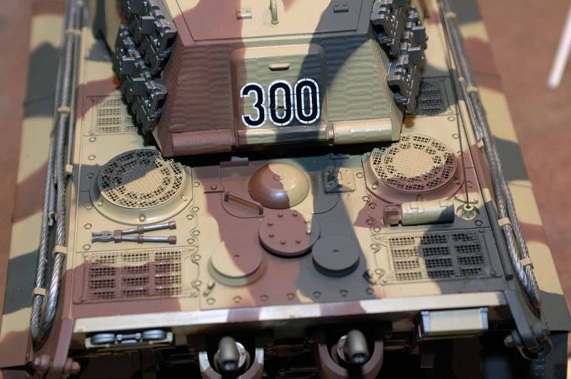

Here's some pics of my KT. I just addded the photo etched grilles and tha's all I'm doing to it.
