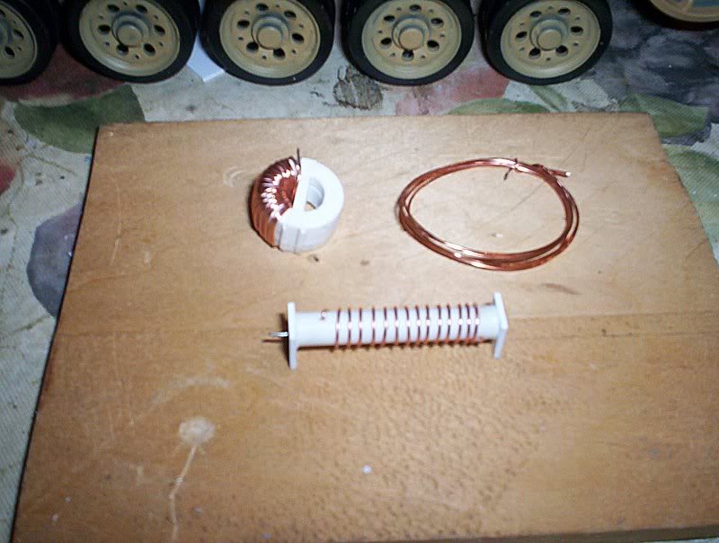

Want to eliminate the long out of scale antenna that comes with the HL RC tanks? Well after talking to my brother the "HAM" nut he said why not just replace the antenna with an internal antenna and proceeded to explain to me how to do it. Here's what he said " just measure the section of antenna you want to replce then cut a section of laquered copper wire like you would find in a choke or coil from an old radio or power supply the same length as the anteena that comes with the tank. So I tried what he said and "HOT DAM!" worked like a charm. I place the tank at one end of the house and tested it out works perfectly. I could start and stop the tank activate the machine gun, the cannon fire drive train responded as it should. I paced off the distance from the tank to the transmitter and was 20 good paces which would be approximately 60ft. Here is how I did it:
1. I measured the antenna and it measured 13-1/16"
2. I cut a section of the laquered wire to that length
3 I took a piece of 1/4" hollow styrene tubeing 1-5/8" long drill a tiny hole near the one end.
4. I inserted the one end of the copper insulated wire into the hole and brought the end out of the end of the tube approximately 1/4-3/8".
5. I then wound the wire around the tubeing and secured the other end to the tubeing with some cyano
6. I then glued short standoff's on either end feeding the end of the wire through the one end
7. When the glue had dried I then un-soldered the antenna wire where it is soldered to the anntena stub keeping the 2 sections of black wire.
8. I then soldered the end of the black antenna wire to the end of the coil and tack glued it to the right inside panel of the hull.
Then I was test time... and it passed with flying colors.

Pic 1 This shows the coil I used to get the laquered wire from I took the coil out of an old AT computer power supply. This pic shows the top view of the coil
Pic 2 side view of the same coil

Here are the links to my pics on my photobucket;
http://i2.photobucket.com/albums/y18...enna-mod01.jpg
Pic 2 side view of the same coil. coil length is 1-5/8" long and 1/4" diameter
http://i2.photobucket.com/albums/y18...enna-mod02.jpg

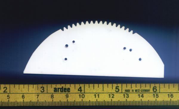

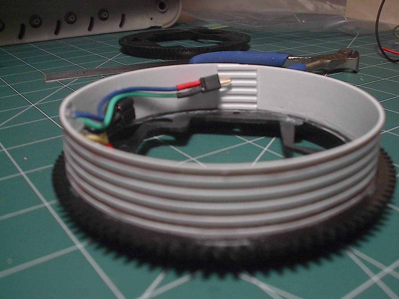

Here's how I solved the 360+ degree rotation. I made a pattern of the teeth on the turret ring gear and then cut new teeth in the ring gear where the tab was to stop the turret from rotateing any further. Now my turret can keep on rotateing till I either stop it or it twists the wires off. I re-made a quick movie with my Kodak Easy Share digital camera not the best for shooting video but you can see the turret in action. And the turret motor does have enough strength to bend the antenna over since I moved it to the correct location. In the pic of the template I included a section of tape measure to show the actual size of the pattern
Pattern
Modified Turret Ring Gear
Turret in motion
http://s2.photobucket.com/albums/y18...t=rotating.flv
I will be doing this modification to my PzrIII L as well... Nice to fool the other guy into thinking you can only rotate the turret so far when he sneaks up behind you and you rotate and whammo you nail him

Swathdriver have you seen the three ring solder wire fix for turret rotation, its fixed to the geared turret rotation gear. It is a simple idea, similar in some ways to what you have done
