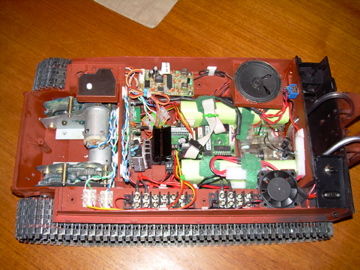

I was hoping that a few experienced builders could post some pictures or diagrams of the way you keep all your wires organized and neat. I have read the build threads and have a few ideas from those but have a few questions as a result.
On most build threads the boards are turned to allow for cooling, how you them secure them in the tank? Build something or simply screw directly into the plastic?
Where do you buy the small clips and velco?
Any and all info would be great!
Thanks!!!

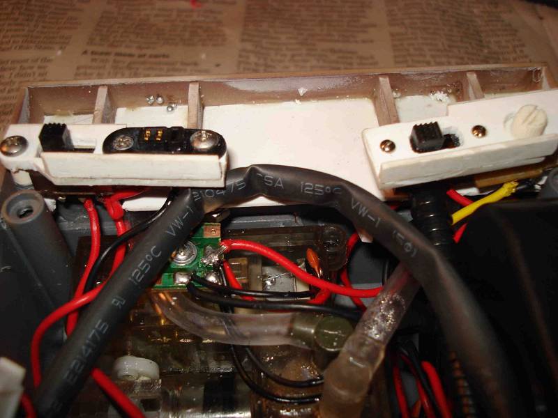

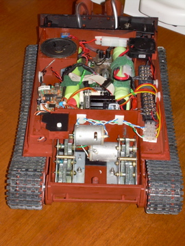

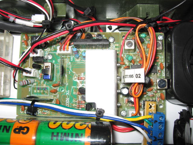

I use small wire ties and hot glue after I'm sure of there placement

I build a false floor and have all the wires run under that. You end up with a tidy interior.

YHR on your front firewall you have a bunch of connectors, where did you get those?

Those terminal strip's are available just about everywhere that sells electrical stuff. You can cut them to the amount of terminals you need (the ones I buy come in a strip of 12, different sizes available)

zip ties, 1/4" wire loom, and those little terminal blocks that HL uses for the smokers. I bring the battery power to the terminal block, then power the board, fans and accessories off of that. I use very small fan that can blow on and cool boards in stock location on PZIII, Pershing, and Tiger. Less lazy solution for Pershing and Tiger hulls is to build a dedicated electronics tray but those tanks of mine don't need them yet.

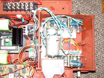

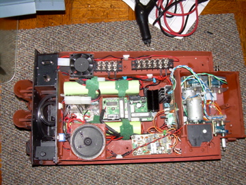

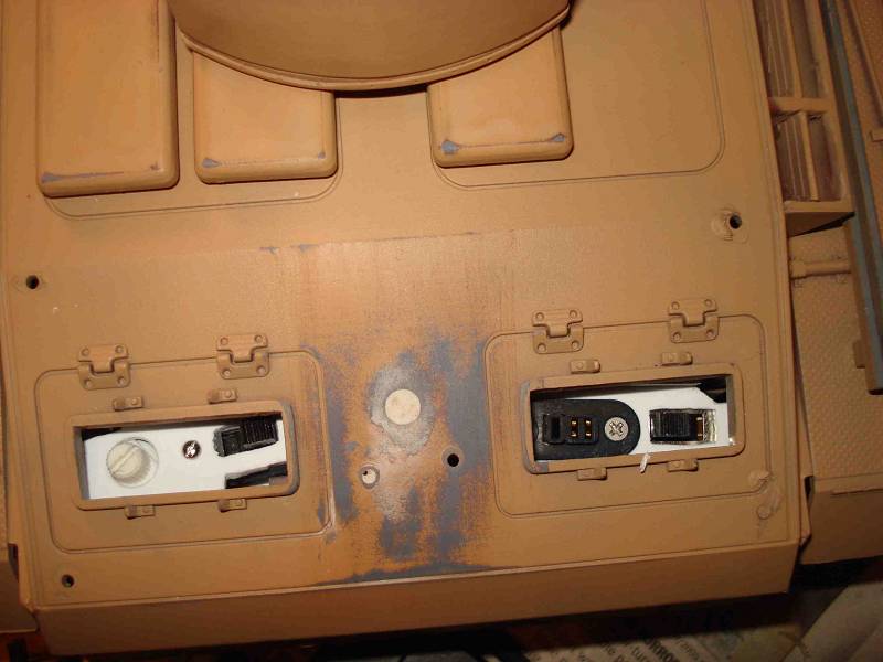

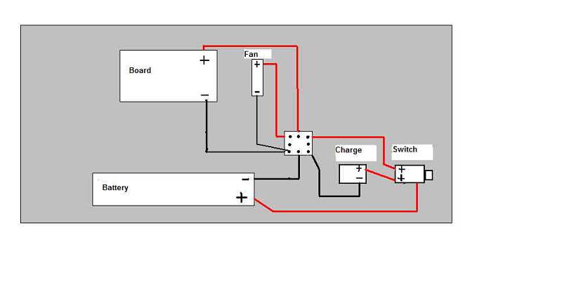

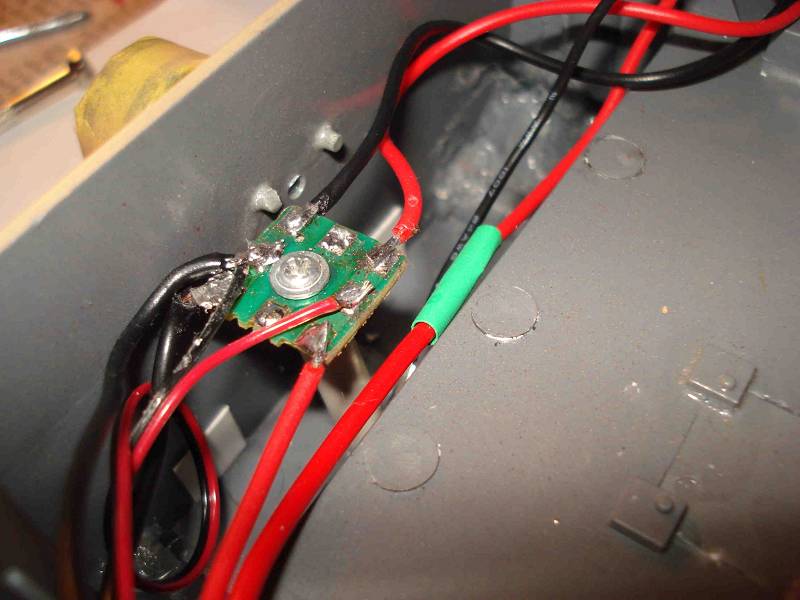

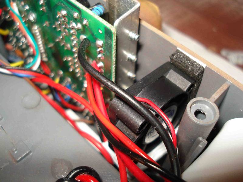

Bill and Oliver, I'm no expert! I learned like Bill says, by hurting my wallet and blowing up boards! I've got more burned up boards then most guys have tanks!
Attached are some pictures before using the loom of my PZIII project. The wiring diagram is for the lower hull and can be used for all tanks, the only additions you have to make are for the taillights if your tank has them.
I did my last M26A1, Tiger and Panther this same way. The Tiger and Panther didn't get remote charge jacks.
Working on Walker BullDog now, It will be wired the same way with charge port and switches in the back, might do 360 turret and Pzrwest Antenna coil. It will also have provisions for the wireless camera to be mounted on top of the mantlet as in real life. Haven't taken too many pictures of that one yet, still in pieces.

Always draw a detailed wiring diagram of the tank before taking anything apart, lower hull, upper hull and turret. That way you won't wire up something backward and melt a wire or blow something up and you can improve or add to the design. Do you have spare smokers laying around? Those little junctions are more compact then I've seen others use and FREE!

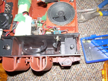

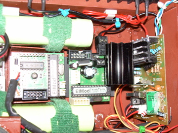

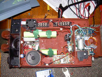

Here are some pictures of my FULL tiger...

I got 3600... have no worry swath... 2 to be exact!
I think I might use LIPO for future projects.. like a PZIII more room!
Wait till you see the upper turret wiring in the works now!
If you check my Gruppe Fehrmann F01 Thread you will see the ElMod is set up so it is removable and transferable with ease to other tanks....

Oraculo...
Check out the firewall..... its high enough and it acts as an engine, gear box compartment wall.. and\ I can greese teh gear boxes THROUGH the front hatch.
