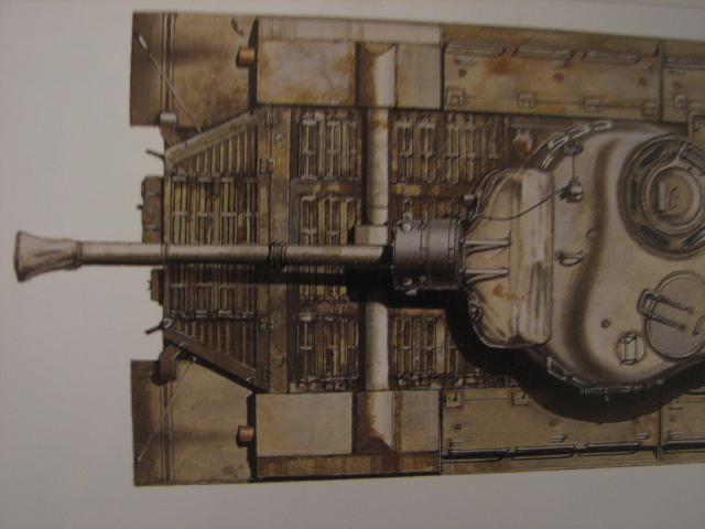

Don't really know on WW II, but since they only entered combat in ETO in April 45, they only had 5 months to put up with them...they are a royal "extreme discomfort in the posterior", and they just get in the way, road trash gets caught up in them and they get snagged on heavy bushes or shot up. Just have to look at the many photos and decide what unit you want to do. In Korea, some units took them off immediately, some removed the front and rear sections, and the Marines showed us the trick on folding up the center pieces to stow more MG ammo. None of our M-46s had them.
On that idea of fitting a dozer to an M-45...none of them had a dozer. Only 187 made and used only in korea as infantry support. Stilll, a neat tank and not a tough conversion.
Here's a view of the back deck of an M-46 and a view of the sprocket showing elevated position and addition of compensating idler wheel. Big diff between ther 26 and 46. 47 was identical to the 46.

many thanks bill
think i will go for the m45 and use artistic licence and stick a dozer blade on the front
i now it's not correct but hey thats the point of having a scale model if you can't do what you want with it
a bit like the hobart funnies
even the m46 conversion doesn't look to daunting apart from the re-location of the sprocket wheel and idler
but if i went that far might as well do an m60

might just get away with the back deck as i see what you mean all those grills[&o][&o][][]
the exhaust doesn't look a big headache,Is it similar to the bulldog but with it starting in the centre and working out to the mufflers

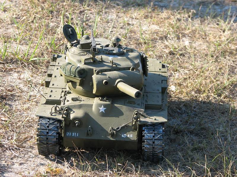

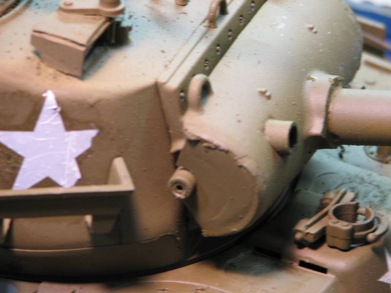

I'll get some '46 back deck shots in the next couple days. Hre;'s some views of my M-45.

disregard photo #3 travel lock...it was wrong and I changed it and built a correct one that works by inserting a pin through it and an eye at the base of the mantlet. Pic shows the side of the beefed up mantlet. Here's a couple more showing the TC's cal 50 mount on the gunner's periscope shield. Same as m-46.

If you want an ARV, how about something different like this:
http://www.jedsite.info/tanks-papa/p...t12-intro.html
And here's what the M45's barrel really looks like:
http://www.jedsite.info/tanks-papa/p...m45-intro.html
The Sherman 105 barrel is way too big for this vehicle.
HTH
Jeff

Is it possible that the canvas cover is making the 105 barrel appear shorter than it really is? The barrel on the M45 photo in the Vanguard book looks a lot longer (and more like the one on the Sherman).

It's not so much the length but more the guage of the barrel and also the pics I have seen (the 'drawing' I used is a bad example) the end of the barrel is slightly tapered. I've never been a big fan of the stock Tamiya 105mm barrel. It's just too thick.
Not a personal attack, just an opinion.

Ah well, you have the advantage of me there. The only photograph I have access too has a cover on the muzzle, so I can't see the taper. I will bow to your greater knowledge.

hey bill can i add that is one nice m45 conversion you've got there hope my 46 is half as good[8D][8D][8D]

On the M-45, I'm not sure many even had a convas mantlet cover. None that I recall in Korea had covers, other that the partial mantlet side canvas as they had all been converted from older M-26s. But I have a photo of a post war training area that shows M-45's with a full mantlet cover like the M-46. Th M-45 mantlet was thicker with an added inch or two of armor, so the canvas would have to be custom made for that tank. My 105 howitzer was made from a Vietnam era radio antenna and is the correct length with a slight taper, but just may possubly be a slight fraction too thick.
