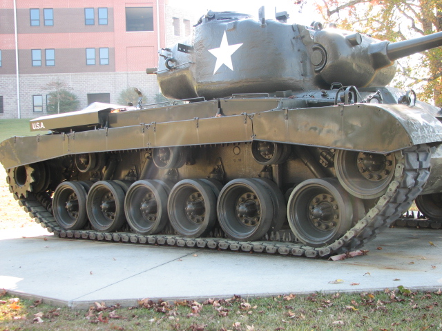

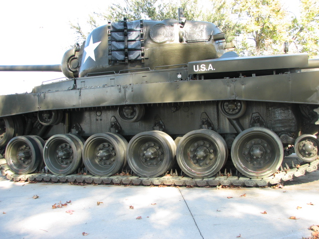

Here's the M-46 pic. May have to send them 4 at a time. Note this has been modified in removing the 2d and 4th return roller and the pistol port has been welded over....why???? Note also that this has the original sand/dust shields and you can plainly see how the center sections fold up.
ID:	803083   Click image for larger version
ID:	803084   Click image for larger version
ID:	803085   Click image for larger version
ID:	803086   Click image for larger version

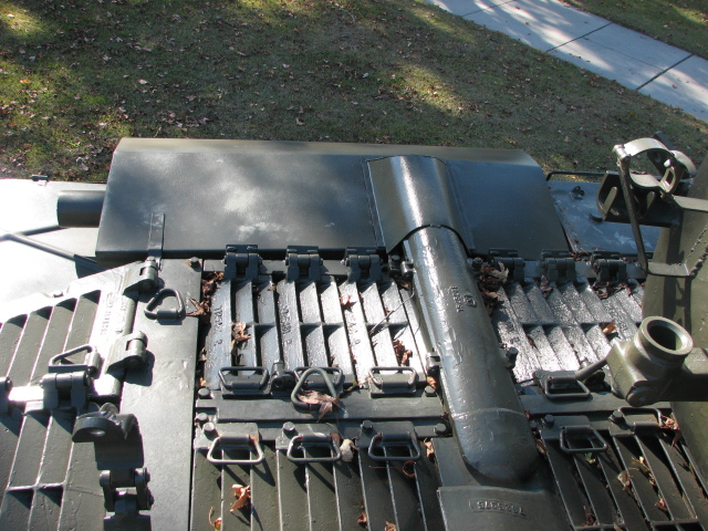

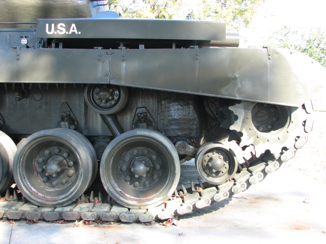

OK, they all took...something blinked with the computer so hope it didn't kill this post....will send it anyhow and see....if closer pics are needed, i can take. When the Museum is settled....ther are moving back in next week after renovation....I would like to get the key, traverse the turret to the side, sweep the leaves off and shoot the back deck complete.
Bill

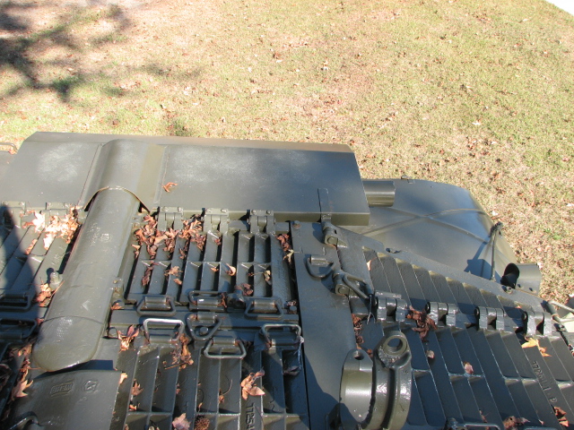

ID:	803089   Click image for larger version
ID:	803090   Click image for larger version
ID:	803091   Click image for larger version
ID:	803092   Click image for larger version
ID:	803093   Click image for larger version
ID:	803094   Click image for larger version

just noticed the compensating idler is missing from the right side. [X(]Strange...Also the spare tracks are mounted backwards...the chevrons should be facing the tank....with the center guides on this side, the crew would have to dismantle the tracks and move the center guides to the other direction[:@]....this was probably done for show. [:'(]

WOW bill many many thanks for those photo's
did notice the right side comp idler missing thought it was my eye's LOL
the back deck does look like it's gonna be a fun job thought of doing it in thin brass sheet for ease of the louvres.
The exhaust and rear plate look relatively straight forward[X(][X(]
the only real dramatic change being the change in drive and the positioning (to make em work with the stock boxes)

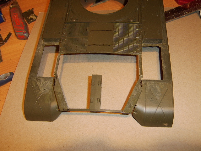

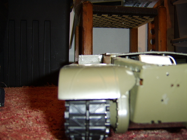

a couple of pics of the W.I.P on the back deck
ID:	822293   Click image for larger version

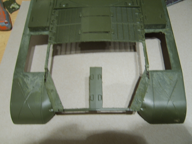

rough layout of the new deck

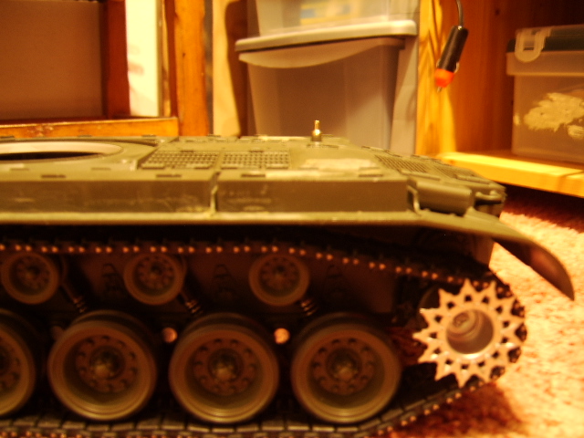

just a couple of differences between the m26 and m46
from the pics ive seen the rear fender on the 46 is straight as the m26 has a bend down to the rear also was the rear panel higher on the 46 as it looks that way to me [sm=spinnyeyes.gif]
must only be a couple of inches but still higher than the 26
also making the rear engine deck flatter on the m46

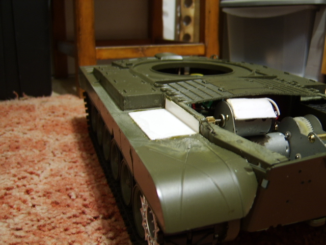

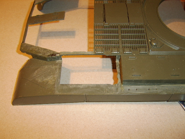

an update on the m46
got the sides sorted and filled with plasticard
straightened the mudgaurd on the rear where the exhausts will sit
last pic is a "before" to show the difference
