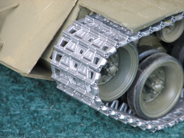

SUPER PERSHING ALSO REPORTING. New t-81 tracks came in today, so i dropped everything and got them installed. [sm=teeth_smile.gif]They look and run really great.[sm=thumbs_up.gif]
Problem and I have discussed this with Willy, is that the tracks come with a pin inserted from the inside with no way to use a pin to punch it out. [:@] I had to remove a link from eacxh track to get the right fit...and was unable to make any pins move at all.
It was necessarry to to cut one link from each track with a Dremmel saw...but the tracks come with 6 spares, so no sweat
The super-duper P is now running on the original type shoes and looks great. Good investment[

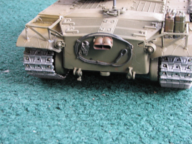

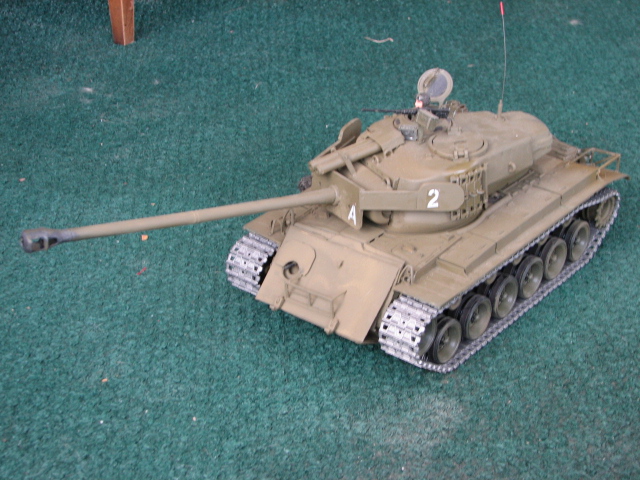

Super Pershing T-81 tracks

One note on the Impact tracks...the sprockets are made for Tamiya, where the shaft has two flat areas in the hub. The HL only has one, so it merely entails using a Dremmel and burr off one of the flat lobes to round it off to fit the HL shaft. I did the same with mt T-84 tracks on the M-26A1, takes about 10 minutes and it slips right on.

I certainly hope you're going to remove that antenna from the engine deck. They never had them mounted there on any Pershing and certainly not the Super Pershing!
And the travel lock you have is more for the M26A1, not the Super Pershing. The Super Pershing was located on the rear and much larger than the T26E3.
And those tracks need some weathering or at least some paint. I've never seen silver tracks on any Pershing.
HTH
