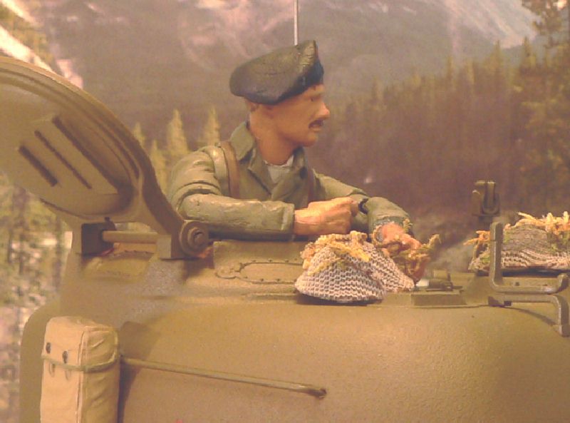

Merry Christmas to all in 2007. Next week be sure to share with us what you received under the tree!!!
This brings us to the last SNFF before Christmas. Guess wha my subject matter is? Yep the Sherman.
I have a couple of crew members now, and am about to start to weather the tank. Here is the last look at fresh paint.

YHR:
The loader looks like on of the other crewmen just poured hot coffee down the back of his shorts (or did something more rude that isn't postable)
Is it my imagination, or does your commander look like the Cuban commander from 'Red Dawn' ? Want me to post a pic of him, cause I have the movie on DVD. Think its the moustache...
and don't take the comments wrong... very well done, wish I could do figs half that well... and I have ~way~ too many in storage to do myself! (Tamiya, Verlinden and a few Kirin)

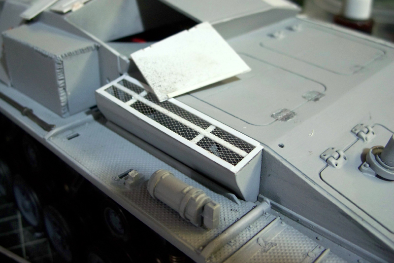

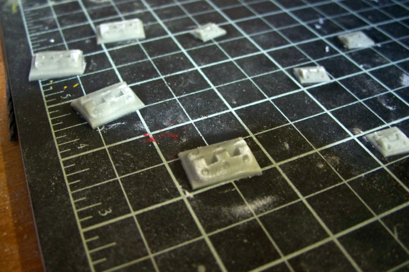

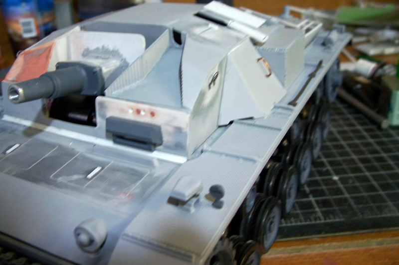

Did some more work on my Stug 3B today. almost ready for paint. Actually i have detailed more since these pics were taken. I have also copied some hinges for the missing ones on the rear deck and for the transmission covers on the front. The drivers vision port has been added as have the shrouded headlights. I will be giving this Stug Wittmans markings.

Leo, how do you make your own hinges?
Everything Looks great!!

I use Aves Apoxie sculpt and press it on to the model. Using baby powder as a release i let the aves sit on the model until it hardens. Pop it off and you have a good hinge copy. Then put some powder on the aves mold and press more aves into it. Remove, let cure and BANG good detail hinge copy.

YHR, Sherman VC looks good. You should install periscopes in the TC and driver/BOG hatches to complete it. The loader looks like he chambered the wrong thing in the 17 pounder. [:@]

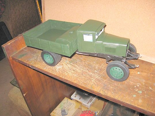

Still a lo-o-ong way to go---but here's a couple pictures of the "kitbashed" ZIS-5v 3Ton Russian WW2 Cargo Truck I mentioned in reply to Swathy's query about making "static" Transport for the Battlefoeld:

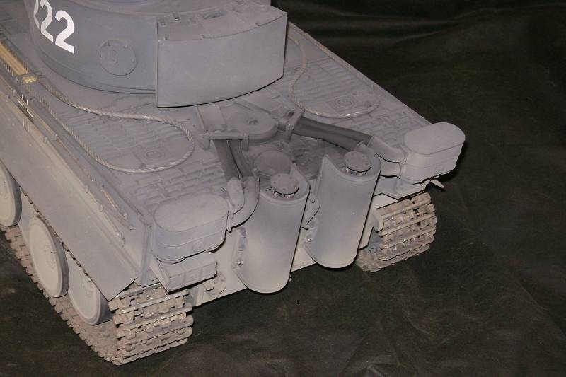

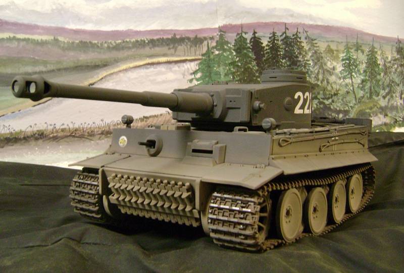

Hi,
New updates.

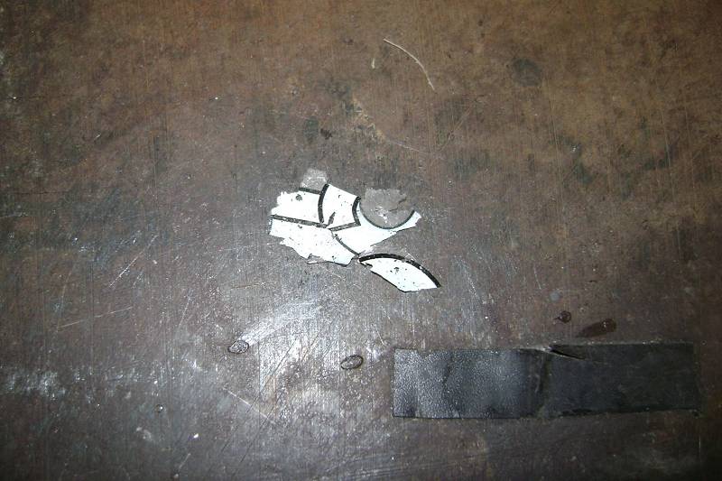

Put on some decals and done some weathering and painting. I didn’t like the “glossy” area between the turret numbers. So I tried to fix that…the result can be seen in the second pic. I’m too embarrassed to tell you how that happened.. Well, I decided to paint the numbers by my self. You have to judge if it went well.
Regards Jake

Hi Jakeand
Nice looking Tiger. Those darn shiney press on decals are the first things guys upgrade. The painted on numbers look great. 1/16 is large enough for you to do stencils, and even hand paint lettering. Nice Job and thanks for contributing.
I like your picture composure as well

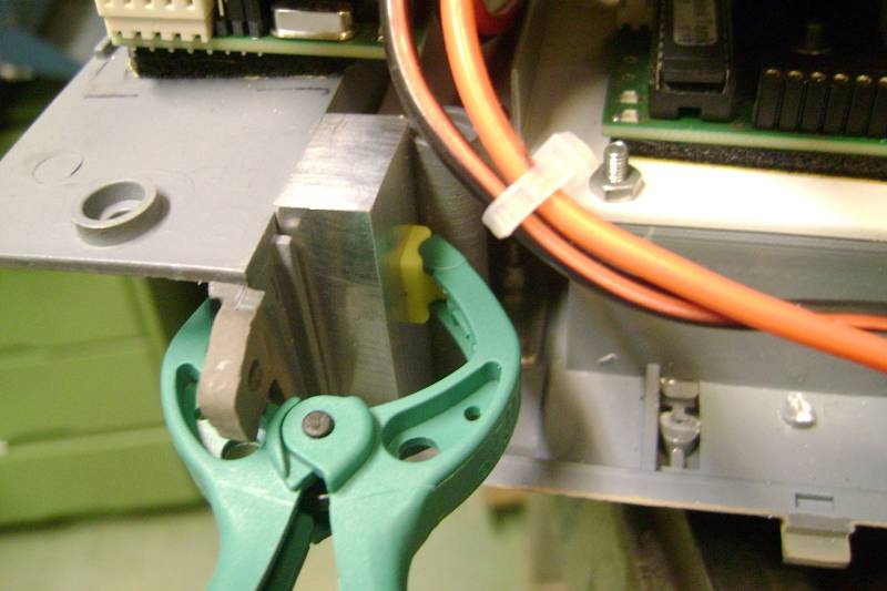

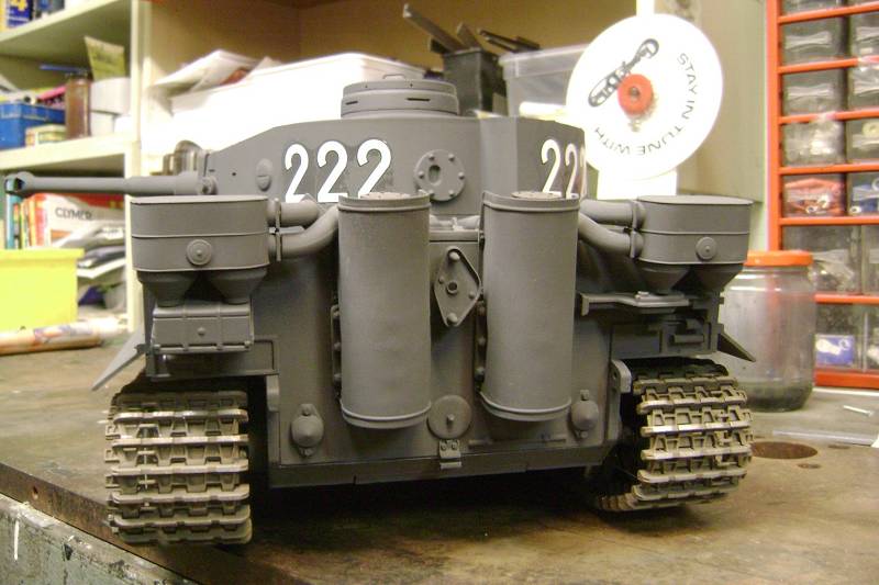

Thx YHR,
Well, this is my first tank and my first try with a paintbrush, so I think the result was better than I expected.

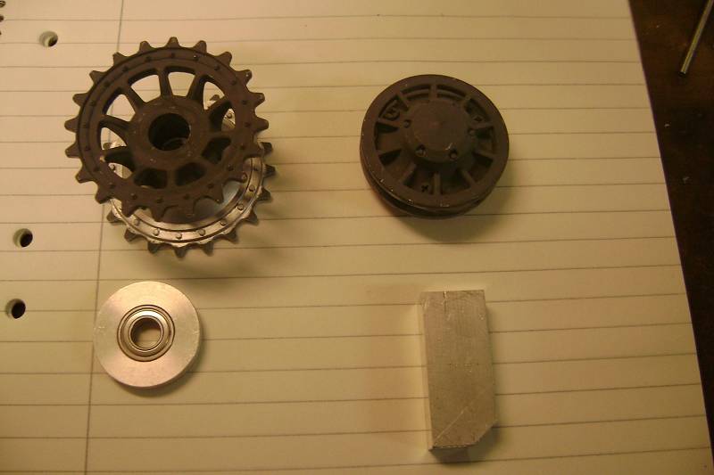

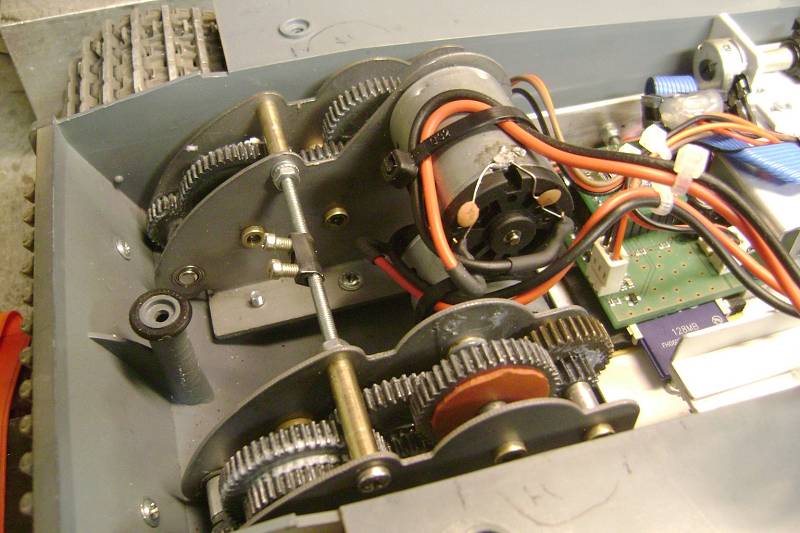

Next step will be adjustable idler wheels and bearings for the drive shafts. A great THX to the forum members for many ideas and solutions for this matter.
Will also test my new gearboxes, more pics and details later.
Regards Jake
