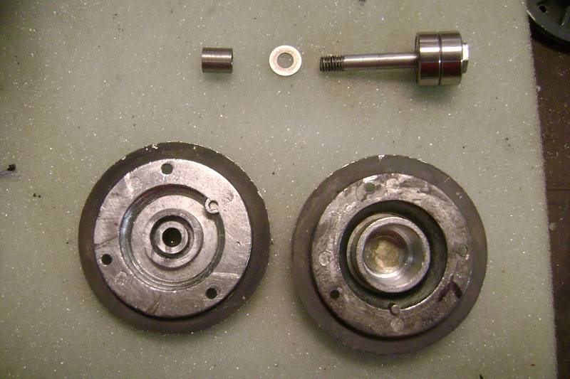

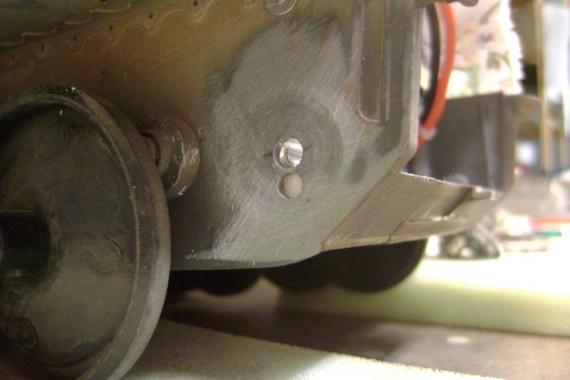

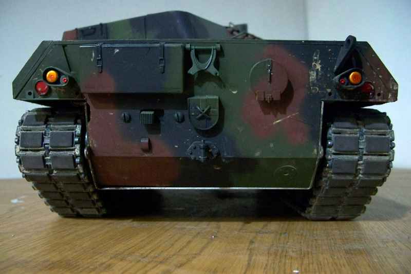

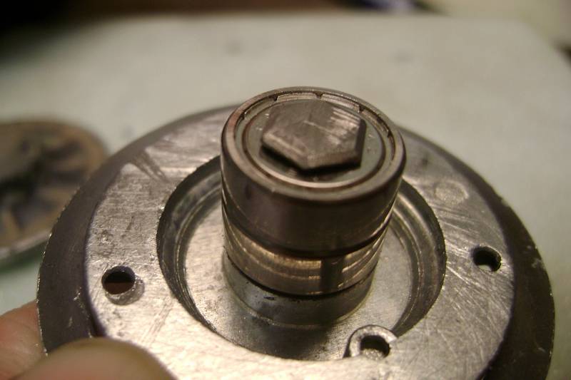

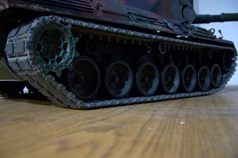

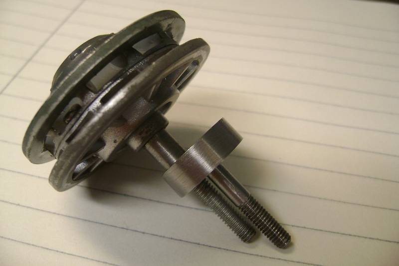

Hi,
Last work from 2007
Relocated antenna , and idler wheel mod.
Roller bearings are FAG 624Z

jakeand. There's a lot of electronics in that tiger. What are the upgrades and what does the micro-switch on the rear panel do ?.
It's looking good to me and that idler gear mod looks strong.

@Wacky & gigant
Yes El-Mod is correct. Graupner MC14 and El-Mod Prop (connect El-Mod to Graupner receiver), Booster (motors), Tls (turret, light, shoot) and Blaster2 (sound)
Switch is for mains on/off/ and charging, actuated by a piano wire (not seen) not very practical, maybe I relocate it later.
Yes the idler is quite strong, maybe too strong putting the stress to next weak point, gearboxes and then to hull and then to…..well, time will tell.
Regards Jake
