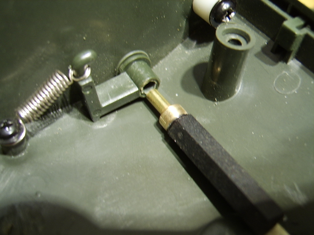

next photo shows how bad it was being pulled out by the spring

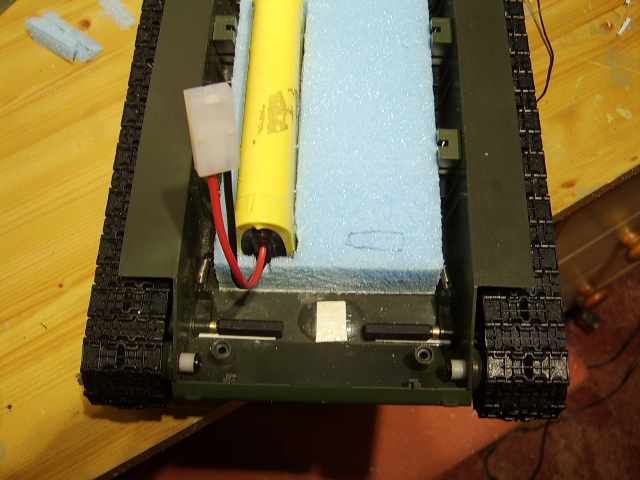

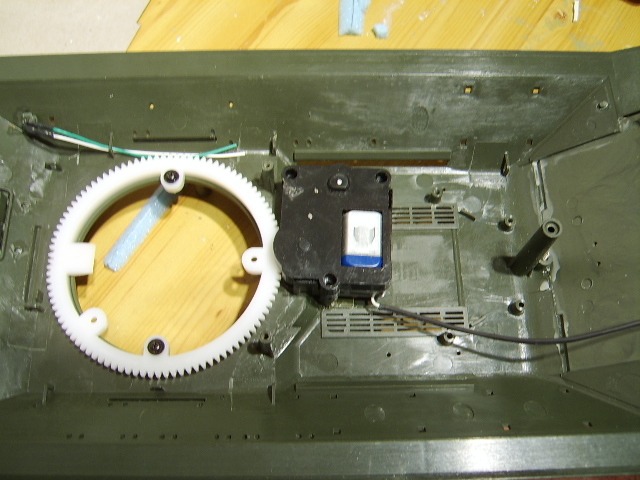

some more work done today got the heng long turret motor in
cut the hard foam and plastic floor strengthener cut and installed (temporary)
installed a dry run on the electronics ready to cut the placement holes in the foam
new attempt at an improved smoker with cpu fan instead of the noisey power draining plunger (will see how this goes as i'm not sure on the smoker yet)

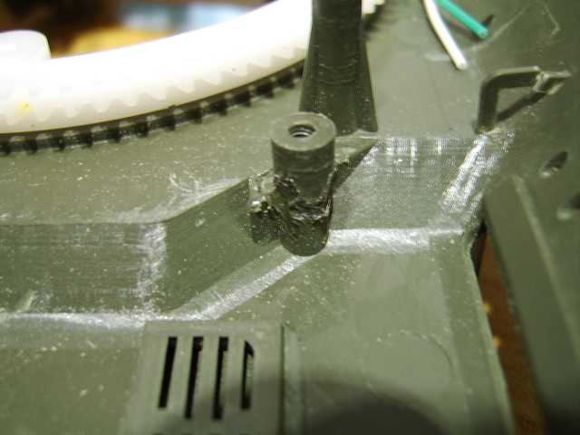

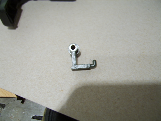

A quick tip on the turret motor dont remove as i did the post nearest the turret ring as it's the other two that need it and it'll save you some glue

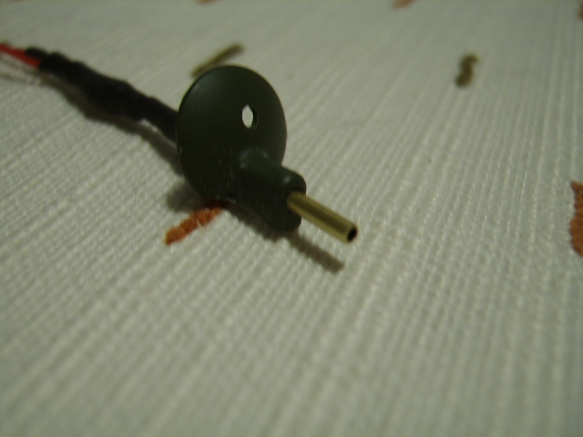

update
re-built the hull M.G with a brass rod for the barrel and fibre optics

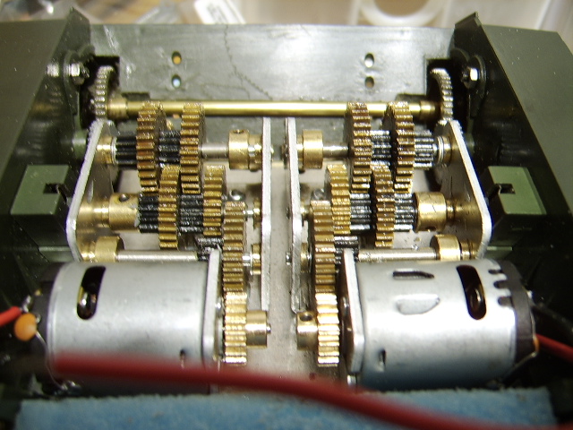

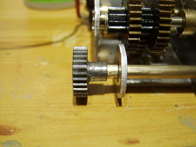

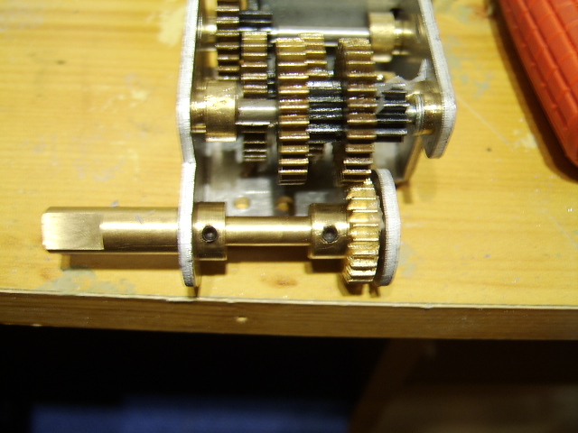

didnt like the metal replacement wsn gears and box setup so opted for the new stug/PZIII ones instead
first up strip the old bits out of the t34
next remove the H/l style drive shaft
then fabricate a new drive shaft and fit a h/l metal gearbox final gear off of the main drive shaft to fit to the wsn one
The rest are pretty much self explanatory
hope you like
Rob

Looks very good Rob, something I may need to do myself someday.
Thanks, Gary
Old 02-07-2008 | 04:48 AM
Banned
Joined: Jan 2007
Posts: 1,707
From: swindon, UNITED KINGDOM
Default RE: T34 build
thanks gary
infact the conversion is easier IMHO than fitting the metal gear upgrade set[X(]
O.K a bit more work involved and expense but at least the gearbox wont try and self destruct every time you hit the "go stick"

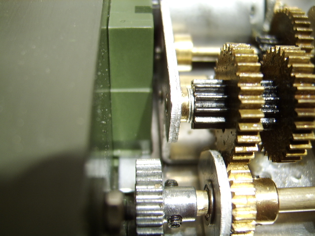

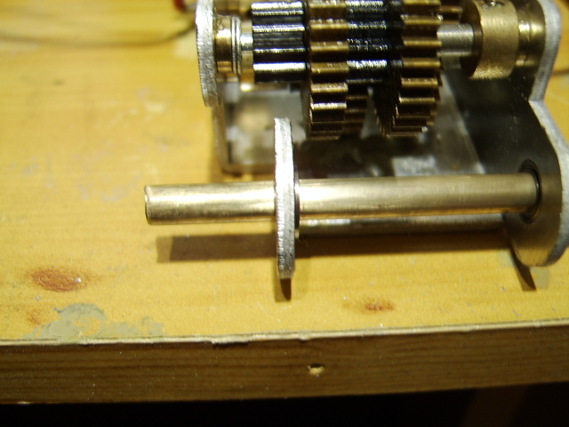

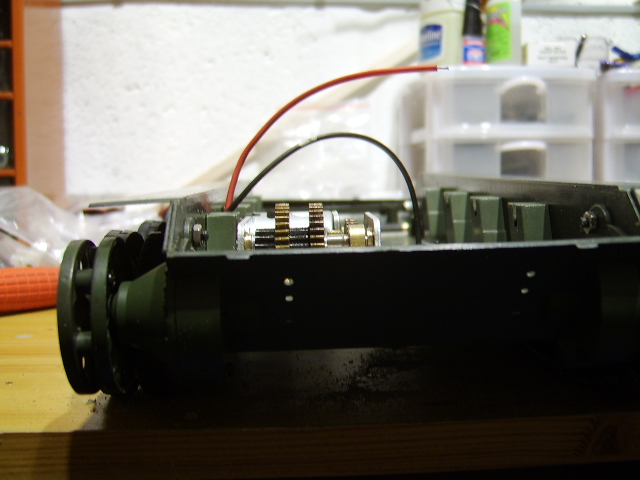

fitted the rear brace for the sprocket gears made from brass tube.Had to dremel a channel out of the rear for this to fit man that was scary
The last couple of pics show the room after the box is fitted (height)

Wow, super strong setup! This tank will run everywhere!

really impressed with these boxes they are worlds apart from the original h/ls
not sure if they are as good as tamiyas but time may tell
