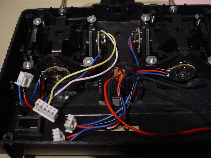

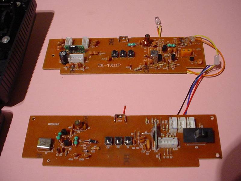

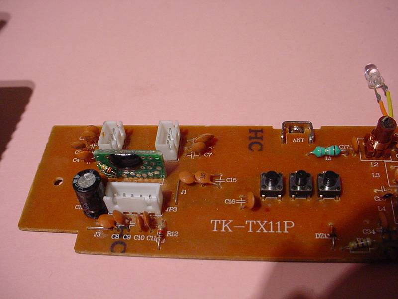

Some supporting pics.....
Pic one shows the Tx inside plug set up
Pic two is comparison of the two boards (newer S&S at the top marked as TX11P)
Pic three is old board showing the four sockets
Pic four is new board showing the three sockets available.

Mike you will need the right hand joy stick from an s+s controller because of the sliders this plugs into the 2 smaller sockets
the left hand stick large plug will have to be modified to accept the five red,white,yellow,black and blue wires from the left hand stick see pic
That said I'td be less of a head stress to buy another controller/tank
