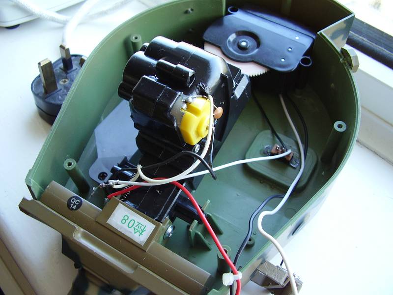

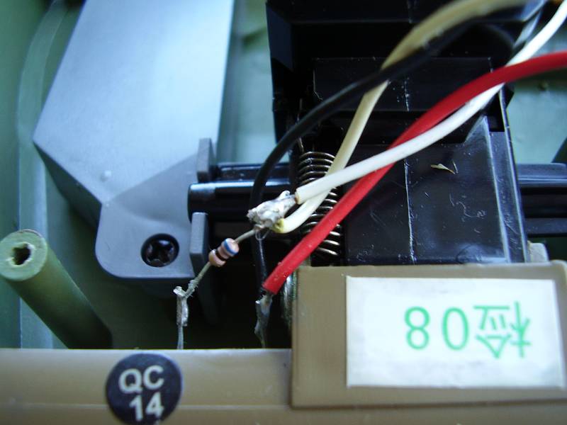

don't want to but in while whackwheels is helping but i just happen to have a few photos taken while working on a tiger,
i'll try to post them if they don' t appear, sorry
regards jack.

Its the red wire in your pictures thats the culprit. That go to the red firing led?

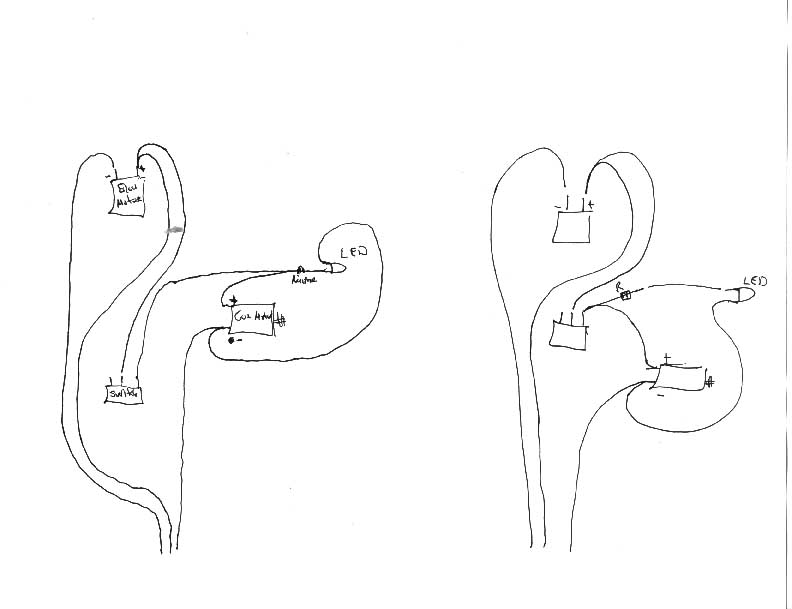

Here's my infamous turret wiring diagram. These are the two ways I've seen the turrets wired up. There is no standardization of colors. The ground wires are the control wires, everything gets power, the grounds are turned on and off by the electronics.

yes, it's soldered to a black wire and both go onto 1 led of the red led
