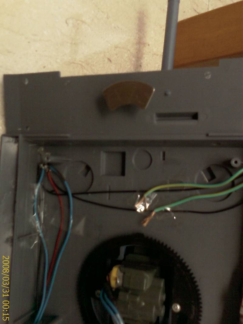

HL Tank assembly uses tapping screws and since I always like to assemble and disassemble my tank, I will ruin the mountings some day.
I was thinking of a few solutions so that I can get rid of the screws and still mount my tank's top in place but none has been as elegant and simple as this one using a pair of magnet from a dead PC Hard Disk.
So now I can remove the top without the removing any screws.
Any other approach to this problem?

Wow, I can't think of a better approach than yours. For those of you that don't know those magnets are very capable of holding it together. The only thing I would wonder is how good is the seal. Depending on where you drive it you may or may not want to put a gasket or a rubber tube around the edges. It occurs to me that the rubber tubing used to set screens would work great.

Did the same with vecro, 2 months later, cracked hull in half at front of engine mount, and suspension on tiger I, good luck, top and bottom screwed together makes the hull stronger, without that support it twists the hull the before suspension works!!!!!!!!!!!!!!!!!

I am not planning to drive over water yet, but maybe I will do that some day later when I have more time.
Where do you run your tank? Any other modifications? Probably adding reinforcement will be a good idea since I am losing some torsional rigidity

I live in florida, we have sand here that is sort of fine, and when I saw these cracks, the tank had been used in sand about three times maybe 1 hour each time. If you take top off, and put it on carpet, or any surface with good traction, you will see the twist when turning, it twists up on the powered side.

You probably need some horizontal brace for the hull for "torsional rigidity", that engineering lingo cos I am studying Mech Engineering.
The tank without the top is like a shoe box without its cover and it will be easier to twist.

I have a couple tanks approaching 3 years old. All the cheap screws wore out and were replaced with quality SS ones from my local hardware store. All the holes are fine. Like Slotcsx says, screwing the tank together is necessary to strengthen it.
Wait, I remember that some of the holes on the bottom of my M26A1(oldest tank) turret stripped out. I filled them with wood putty filler, let it dry, drilled a new hole down the middle and then screwed it together again. Been apart a few times since no problems.
