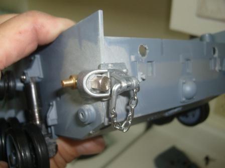

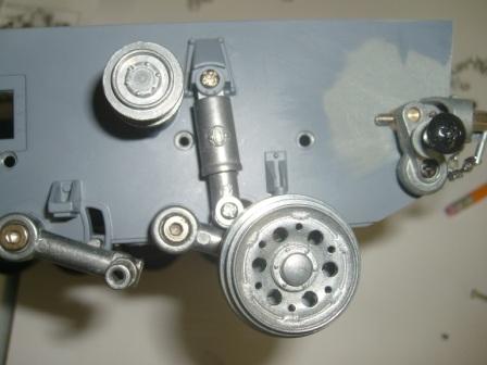

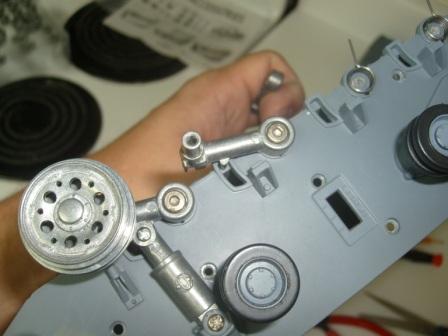

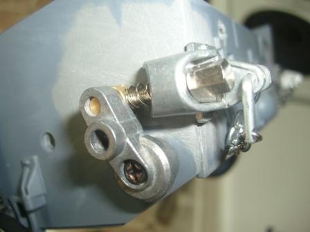

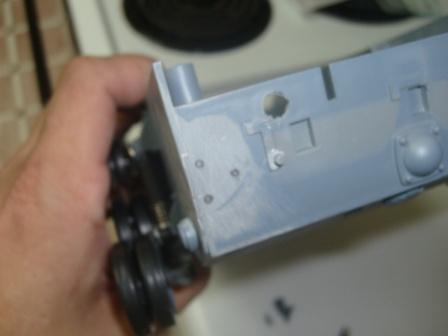

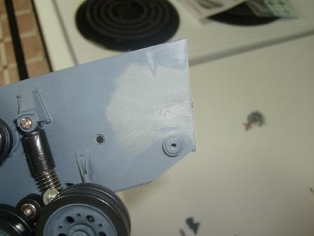

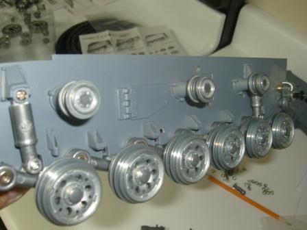

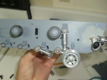

I finally got a chance to work some more on my tank, so I took a few pictures as I went along. So far, I installed the metal tension adjusters, metal swing arms, road wheels, return rollers, sprockets and idlers. I also put a plastic plate in the floor of the hull. The smoke dischargers were not too fun due to the fact that the screws and nuts are so tiny, but they are together.

You raising the return rollers and using the metal ones Slick?

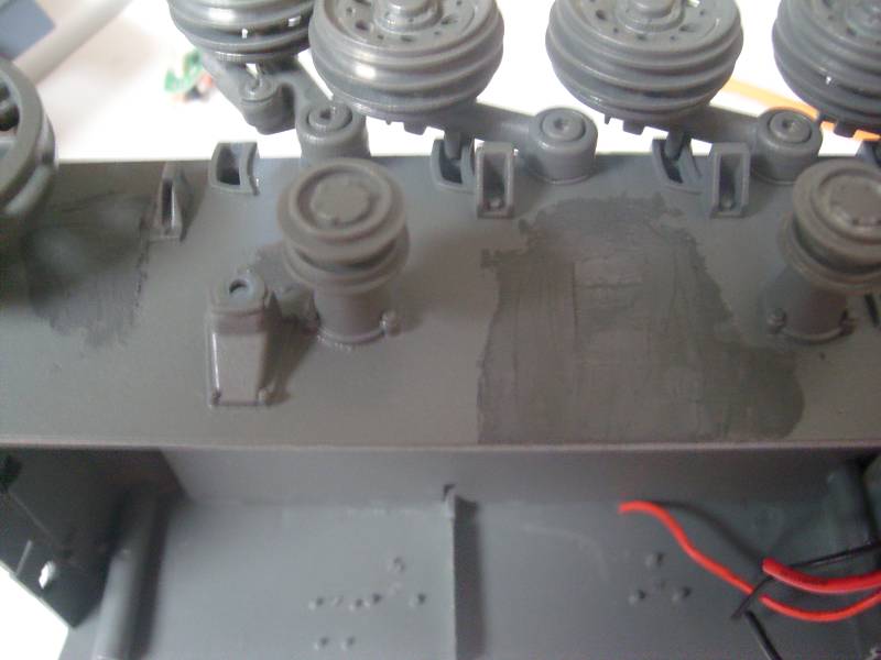

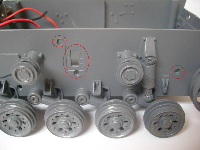

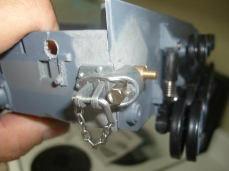

James, I am using metal rollers, but I honestly did not know that they needed to be raised. [] Are they glaringly too low on the HL Panzer III? I guess I never noticed, but it would be fairly easy to correct at this stage....if I don't break them trying to get'em off!
What is a good way to fill these holes? [sm=confused.gif]

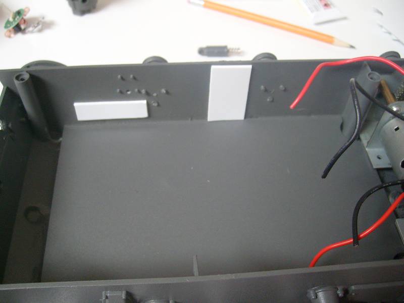

Heng Longs use PVC plastic. Use that plastic plumbing glue and glue a piece of plastic behind the hole. Then use autobody spot putty to fill in the void and sand smooth. Works really well.

Thanks for the tip on filling the holes. I wil have to go searching for autobody spot putty, tomorrow. [sm=thumbs_up.gif]

I dug around in my tool box and came up with plastic card to CA to the inside of the hull and muffler repair putty to fill the holes. I will sleep with my fingers crossed tonight.

I think it was Gigantohawk that first noticed that the rollers were a little low. He referenced a posting on RC-Panzerketten where they raised the first one 3mm and the rear ones 4mm. He posted pics and talked about it on his build.
You've done already what I was going to suggest, using the styrene to fill the switch hole and putty (I use Great Planes) to fill the smaller ones. I also have some wood filler that I use occaisionally too. Looks good!

icecreamslick Hi, your build looks fantastic. I've not signed in recently and must have missed it when I have.
The return rollers are too low, the values are Front 2mm, Middle 4mm and rear 3mm. However I've recently raised the drive sprocket and rear idler, so I'm going to relook at those values.
I got this link from panzerketten. There is some amazing PZIII detail work in the post and not just the rollers either.

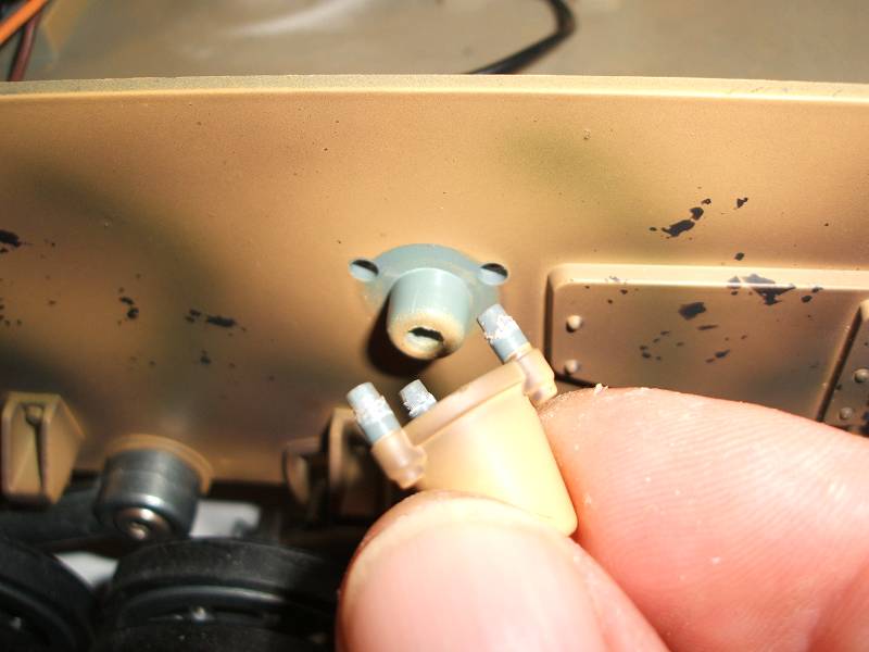

Will you be using metal return-roller mounts? I have them and they were a right PITA because the plastic ones had to be cut off (too much glue).

Pazerfaust77, I think I was lucky with mine. All I had to do was scrape off the glue blobs on the pins inside the hull and the mounts just came away.

Then you were very lucky! I sanded down the mounts on the inside but the things were still solid. I had to cut off the mount and re-drill the holes. It was that bad.= [:@]

To remove mine, I didn't cut ant thin, remove outer roller, then with a small clamp, clamp the metal shaft and 3 little inner pegs together, this forces off the plastic without any damage cleanly.
