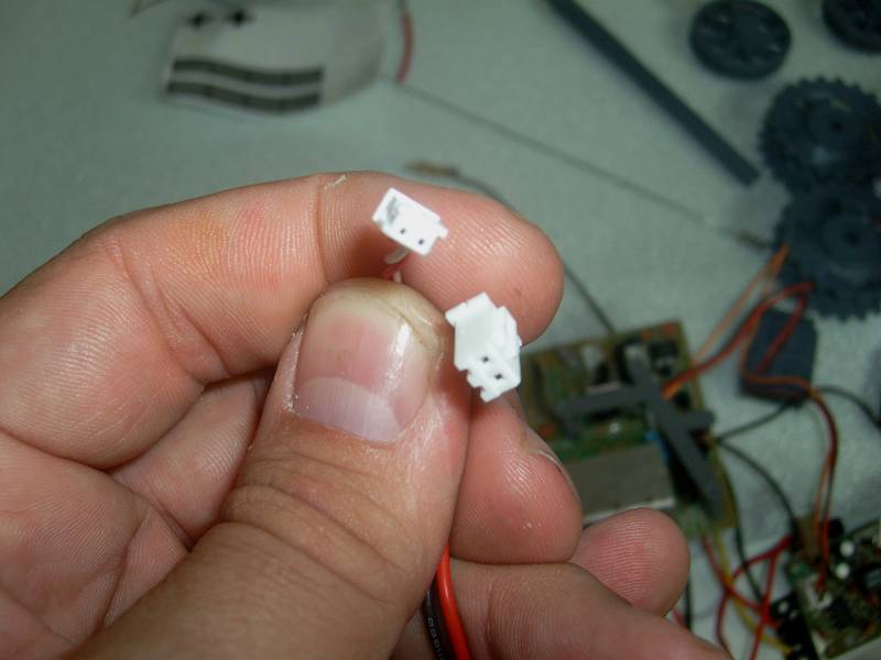

Can you measure the plug end and tell me the pin spacing, it will either be 2.5mm (0.1" or 2mm. I suspect its 2.5mm. To confirm, WITH THE BATTERIES REMOVED!, will the plug fit any of the TK-13RX# sockets?
Simon,
It looks as though the pin holes are 2mm apart, rather than 2.5mm. The emitter plug will not fit into the TK-13RX board and it is clearly smaller than a Hen Long plug, as well. Maybe you can tell something from these pictures. []

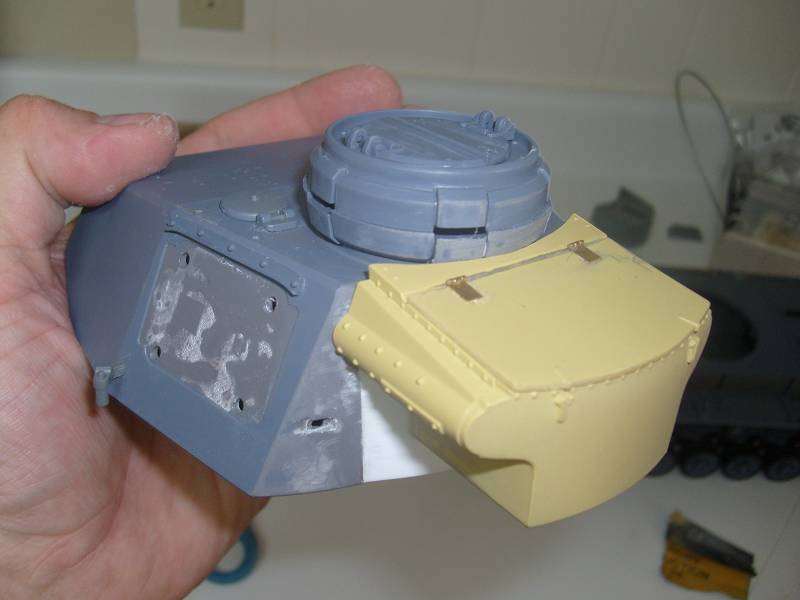

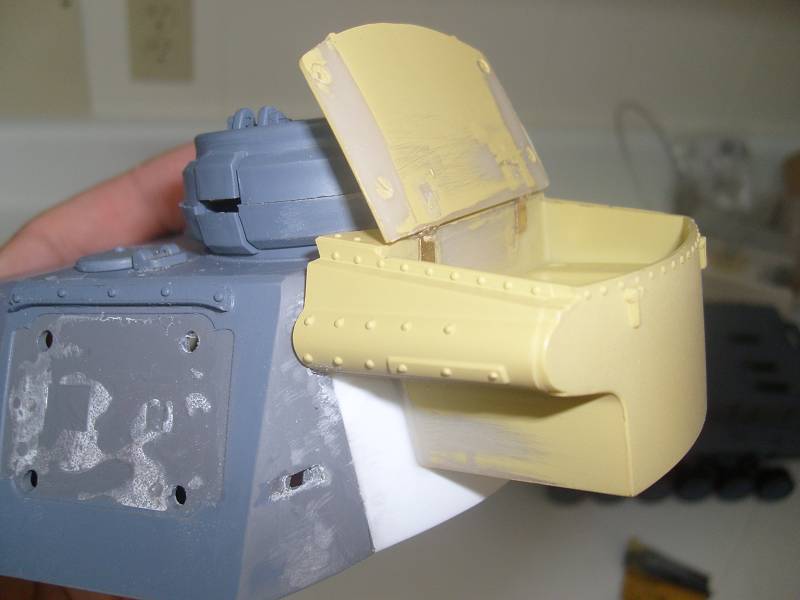

Here is where I ended with this stupid, stupid storage box. [:'(] Those tiny hinges are a tension headache in the making and I never did get the shape of the box to fit the back of the turret as well as I would have liked. If I had paid attention to the lower part of the turret when making the plastic card back plate (rather than setting it aside), I would have realized that the shape of my plate was not quite right. But noooo. I thought the new box was incorrect and decided to Dremel it to the shape of my turret modification. [:@]
Oh well, at least it is done. Sure my fingernails are glued to my fingers. Sure there is a small gap on the hinge side of the new lid. Naturally, the turret and storage box are poorly mated....but I'm finished with it! Finally, I can stop cursing and allow my shoulders to ease back down and relax.

Old 04-05-2008 | 03:35 PM

Default RE: Panzer III Extensive Upgrade
My sincere apologies icecreamslick, I scanned the thread from the bottom up and mistook your pickys as the same as you posted last time! OK I agree it does look like 2 pin 2mm plug. I think I've got all the bits in the loft, If you want I'll knock a lead up, see if it fits OK in by cannon, if so forward it to you? The down side is the 3mm Leds aren't as powerful as 5mm ones. But I think that what you have got is a slightly older generation, so it may well all balance out. Provided the LED is close to the end of the barrel there should be no issue with how wide an angle it works over.
Yours Simon M.
It looks good, some days it seems like nothing will fit or work right, but then it all comes together in the end. Nice work.

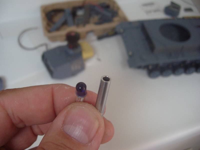

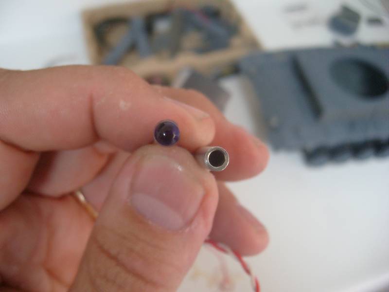

Simon, it is fantastic that you would custom build this LED emitter for me (and I will gladly send money for your work), but there may be a problem. The barrel bore is the same diameter from end to end, but I think it is too narrow for even a 3mm LED. [] I would hate for you to go to all of that trouble and then it still not fit down the tube.
Take a look at these pictures and see what you think.
ID:	922506   Click image for larger version
The 3mm can be reduced down, if required, I used to do this sort of thing when odd specials were required for my job in a prototype section. The 5mm were always a bit more of a pain, this is because the 3mm leds' legs are quite a bit closer. Re the barrel, I'm sure mine is identical to yours, So I'll try out on mine first.
Yours Simon M.

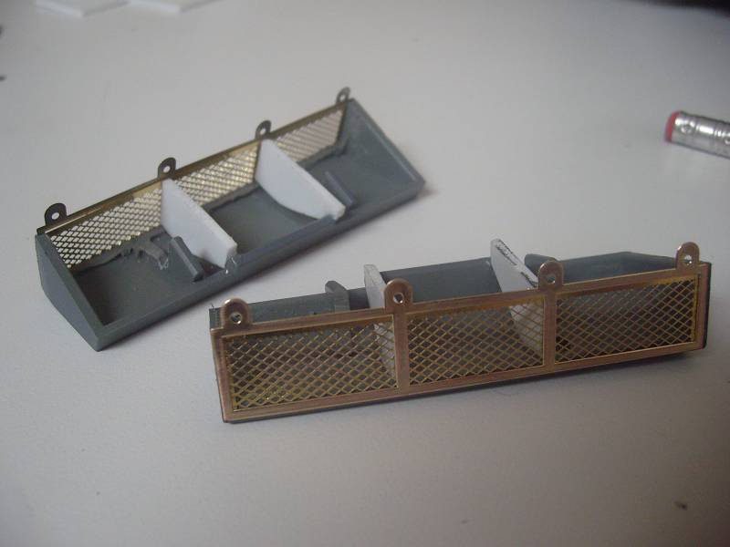

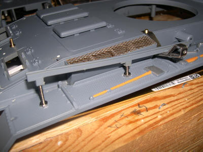

I installed the grill covers and the mailman brought me some more of the metal parts I've been waiting for. [sm=thumbs_up.gif] It looks like I will get to install the new tension adjusters, suspension, wheels, sprockets and idlers tonight. [8D]

HI iceceamslick glad to here doug is still making the schurzen problem solved looking good
regards pete
