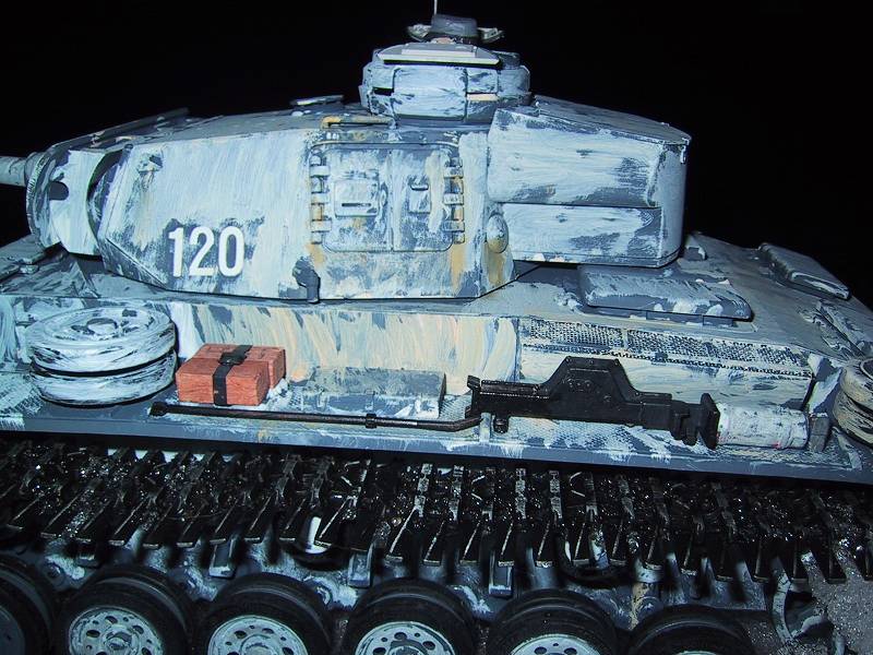

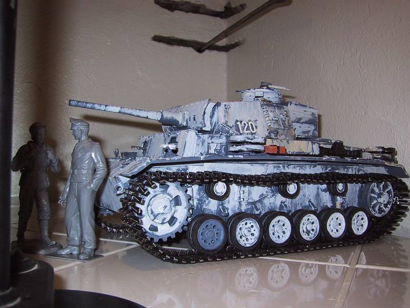

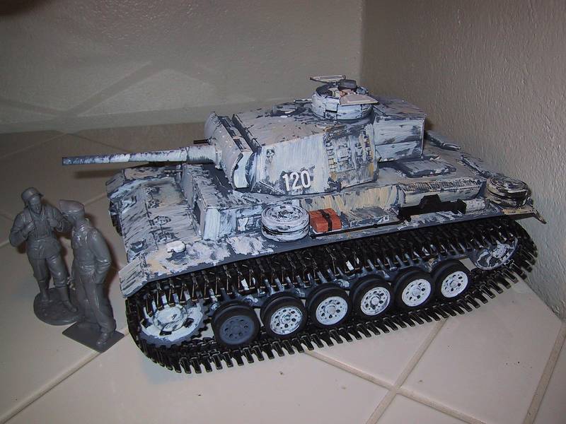

Sunday Night Foto Fun(SNFF) is here again. IF there is something you have been working on but haven't posted yet,(or maybe you have) here is a chance to blast off a quick picture and show us. Do your part to keep the troops motivated.
I hope I don't stand to anyones toes (YHR?) to put this message a day earlier and by myself. But I cant wait until tomorrow and with my short memory, I would probably forget to post my achievement again.
So, here is my first almost ready PZ III. I have made story for it too:
Model Panzer III L
Year January 1943
Delivered to Eastern Front - Stalingrad
Unit Abteilung 103 (white 120)
Commander of unit Josef Zintl (black 100) - survivor of the Stalingrad campaign
Combat history:
- get blasted three of left side wheels at drive to front line.
- disappeared at first battle - destiny unknown.

Nice ride! Now show us some pictures out in the snow!

OOOOOOOOO!!!!
love the whitewash
winterkettens!!![:-] did i say it right?[&:] can you use that in the sand or maybe a mudbog?
i like how the track sags but tried that to my tiger the track always jumps when i run it or make turns[:'(]

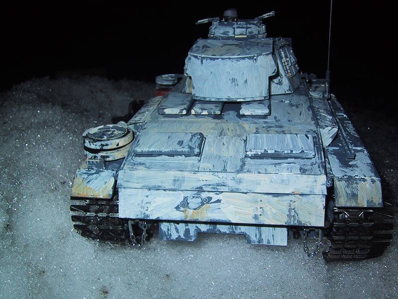

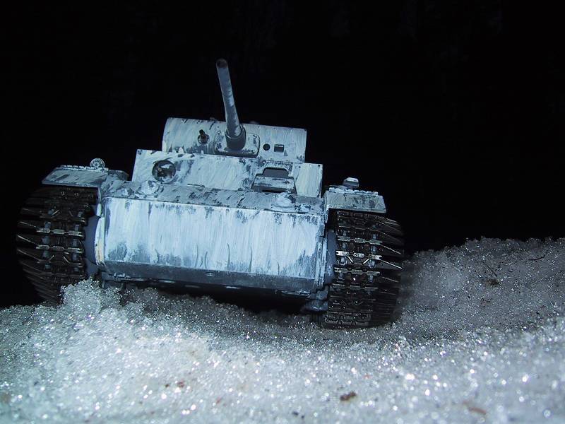

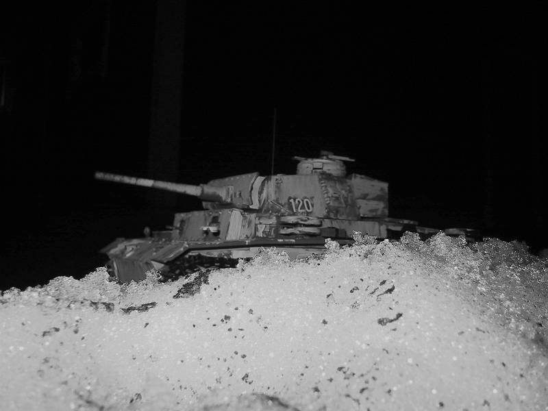

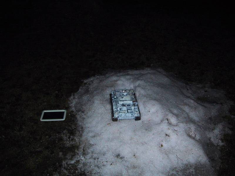

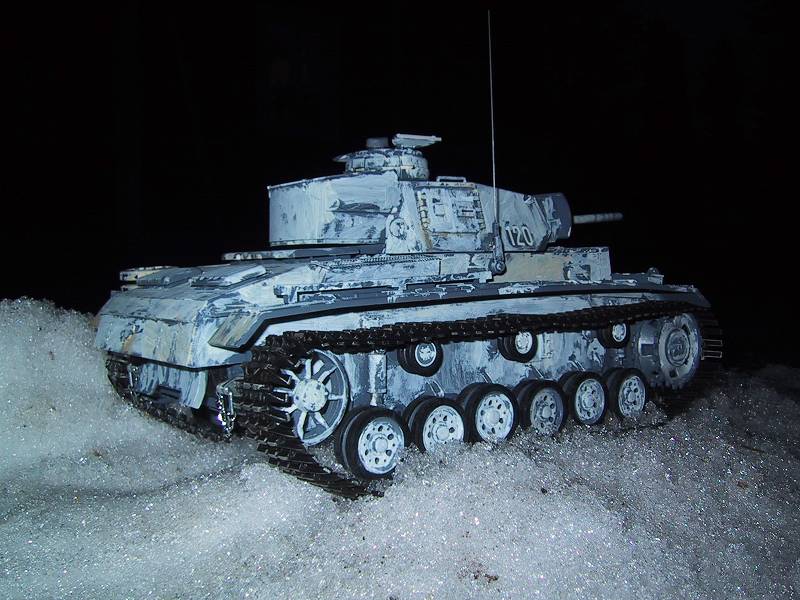

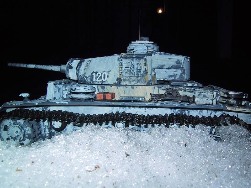

Hi Swathdiver
Here You are: Pictures in snow
It take some time, but i managed to find ONE little pile of snow. Or more like ice, as You can see from pictures.
mizuinu:
Thanks for compliments. As I wrote, this is my first attempt to paint and customise a tank. And yes - winterkettens is what they are called. But You should put more power to that letter r, when pronouncing it - then it sounds more German *joke*
I will let You know how they acted in sand and mud as soon as get change to "brake it in". Maybe tomorrow - at least I hope...

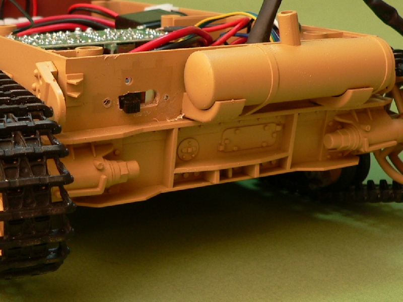

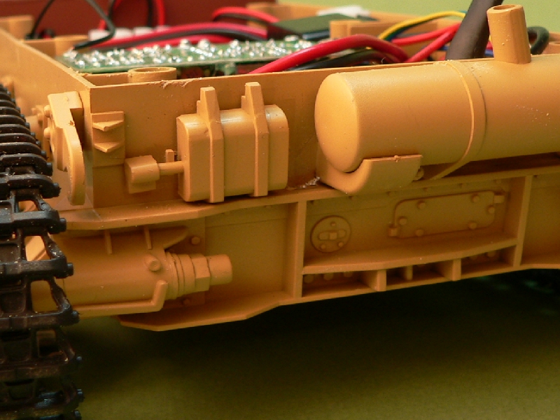

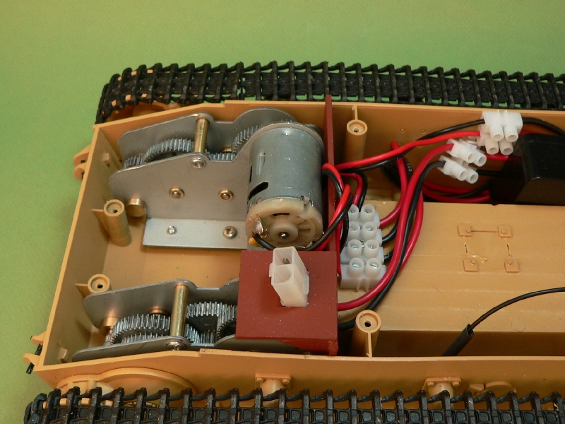

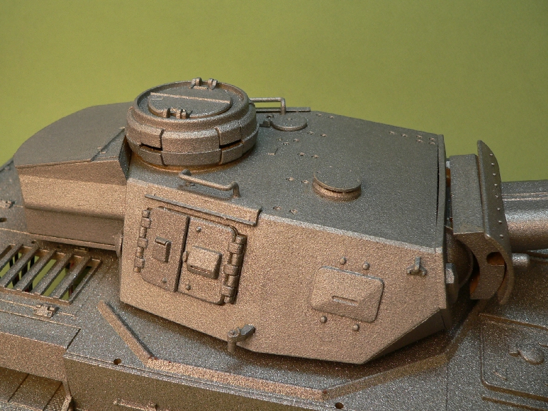

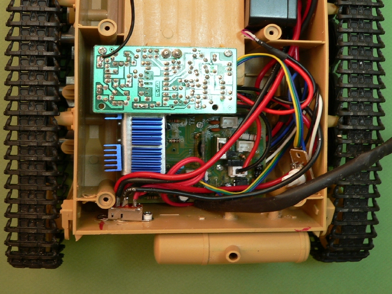

I got my Panzer IV , and after making sure everyhing worked. I gutted the wiring and rewired it. Took out the smoker and added an I pod speaker.
I moved the on off switch to the back and hid under that thingamajigi on the back, You slide it left or right to turn on the tank. I opened up a front hatch and mounted the charging jack under it.

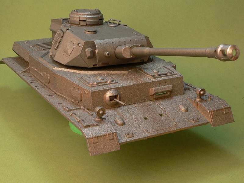

Added a 7.5 cm cannon, ran the IR wiring and installed a IR emitter in the mantlet. Can't see it because it has been masked off and painted over
I then painted it metalic, which will then get a coat of primer followed by Panzer Gray.
More to follow

Outstanding white wash / weathering, it looks realistic, and those are some coool tracks, it's on the list for the Panzer III!

Thank You blitzkrieg65 for Your supportive words.
I was only trying to emulate the look of paint, that has painted with brooms in hurry.
The idea was that paintjob was done same time as others were changing those three wheels. That why jack, woodblocks and crowbar was not painted. As was not the first wheel either.

I like that rough surface look and colour of it.
It is almost pity to cover it. Didn't they ever put tank into battle even without primer? It would be quite challenging rust-operation - I think
About that 7,5cm cannon, is it possible to have measures of it? As I would like to convert mine to J-version.
Oh, and that on/off switch -idea is brilliant.

IT has been primed, painted and weathered. The bare, "steel" never saw the light of day!!!!!.
The rough texture works fine for cast parts, but is actually too rough for machined steel. I take wet 400 grit sandpaper and knock down the texture before applying the primer. I just bought a spray can of something called, "Hammered steel" that might be better for an unpainted tank. My Bulldog has never been modified, and I might experiment with this hammered steel finish on it.

Where did you get the metallic paint? Is that some sort of Rustoleum?

It is paint for plastic lawn furniture. I think it is made by Krylon.

So, do you use that to create texture. It does create an interesting look.

Yes, between this and the suede texture primer colored paint.

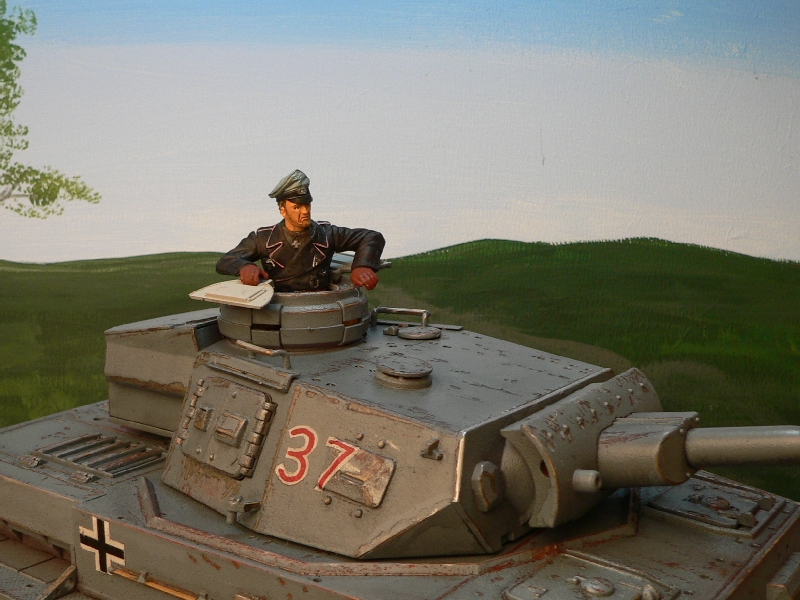

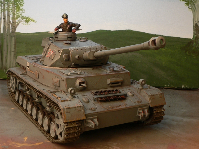

I posed the tank and shot some more pictures. I found something at home depot that works like Dullcoat. It is from Rustoleum and it is called window frosting. You are supposed to use on bathroom windows to give you privacy. Works great as a dull barrier.

Very nice YHR. What barrel is that, or is it home made???
I have yet to get in the pzIV's, but when we do it will be way down on the list of things to do. I still can't wait to get mine!
YHR, you must have a bunch of time on your hands to get your projects done that quick?

An understanding wife, and the fact that we are between season's means, I have some time to work on a tank.
Yes the bbl is fashioned out of brass. The airsoft on this tank is the best yet. I don't know if they have done something, but this thing really shoots hard.
971wright asked about secondary armor. I have no plans for this.
