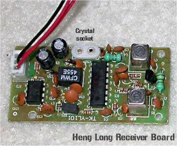

Just looking of a pic of one on ebay and I think I can see where the crystal fits.

Below is a pic of the HL Receiver board, the smaller of the two boards needed for "S&S". It is powered by the data cable, provides input signals to the main function board, and the antenna also attaches to this board.
I have fitted an RX14 S&S set into my 1/350 scale Bismarck, proportional speed in the water is nice for small areas
