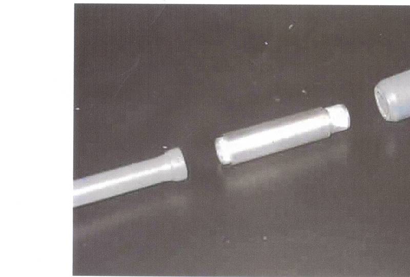

Does anyone know if the HL inner airsoft barrel will fit through these metal barrel extensions? I would hate to get it, cut the outer barrel and find out the airsoft won't work with it.
$8.00 on that auction site

it just fits. If your inner barrel is any thicker (like the madbull) I had to drill mine out out. I did get one awhile back (I assume its the same maker) Now I just make my own using brass tubes .

My Systema barrels went right through. guess the Mad Bulls coating makes for the difference.

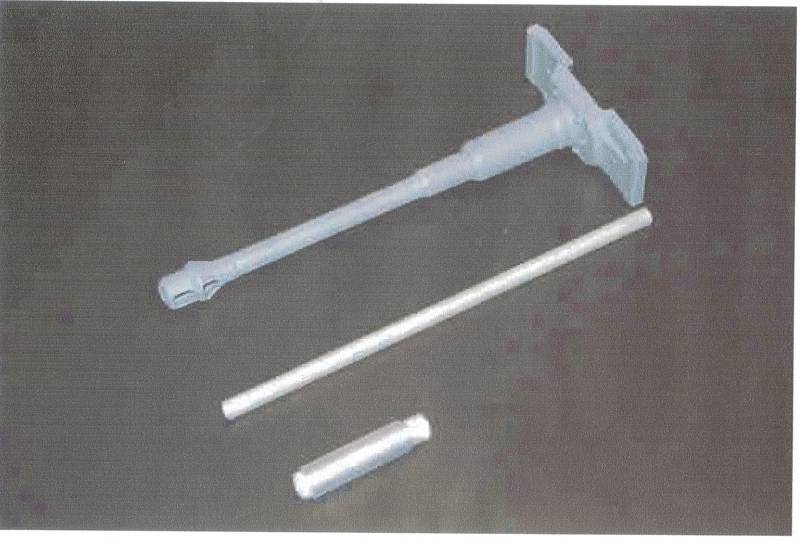

hi,
this is all i have, hope it's some help
regards jack.
ID:	992936   Click image for larger version

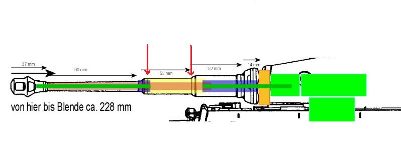

cmryan... Looks like you are new here. Welcome abord! Here a link to another forum [hope it isn't a rules violation] and it shows a lot of good step by step information on getting inside your tank and doing some of the cosmetic mods to make your tank more accurate. The FAQ section here is also very helpful. This will help getting the outer barrel off to work on. I have read of a couple people cutting the outer barrel to lengthen it while the tanks was still assembled and while doing so cut into and ruined the inner airsoft barrel, so I don't know if I'd try it. I guess you could do it with a fine hand saw, and imagine they were using a high speed Dremel cutter of something.
Once cut the metal extension piece looks like it should slide in. The knurled ends should hold it in place and a few drops of super glue would probably be a good idea. Here's a pic showing what the barrel should be and where to cut.
Hope this helps,
http://www.rcgroups.com/forums/showthread.php?t=743482

Great link and diagram Ern, and nice pics Jack. Thanks to both of you.

You don't need an inner barrel the same lengh as the outer. You do have to bore out the inner lip by the muzzle brake. If your airsoft unit fires hard enough then the bb won't touch the outer barrel. You will have to secure the inner barrel to your airsoft unit. I just put a small screw on the top of my gun's airsoft unit to secure the barrel.
