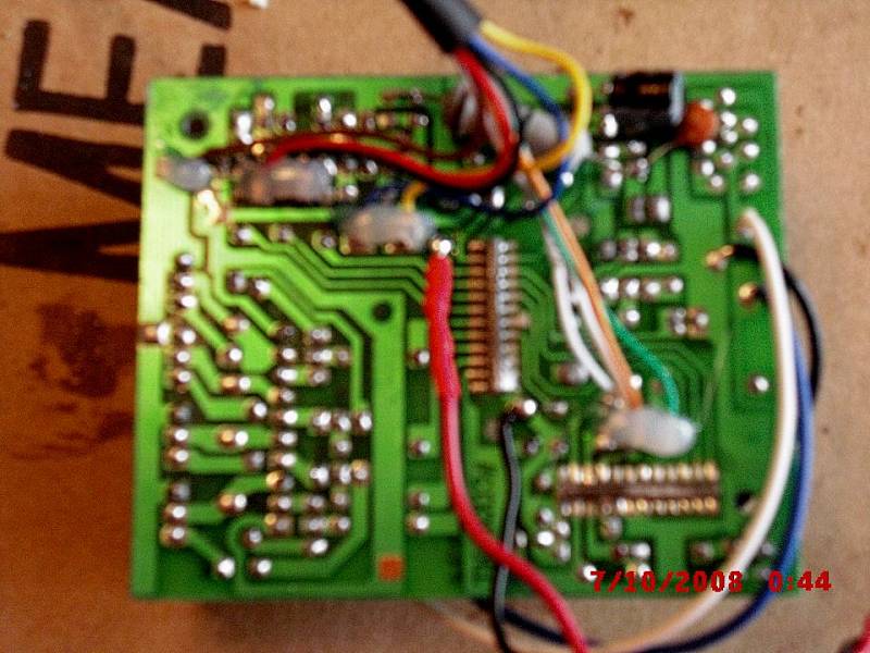

I install the Blitz superflash! 2 LEDs with a 75 ohm resitor on the Hot leg atteched to the points below!

Blitz's suggestion works good, as long as you don't enable the block recoil function. If you want to disable the track recoil, you either need to use a DBC-RC2HL (which has a flash) or you could tack on a LED FET driver that's triggered by the fire sound output. Haven't tried it yet, but it's possible.

Panther G I am just combining two LED's a red and yellow to make the flash look yellow from the front and red from the sides!
Here is another picture of the direct points to connect to, as it was brought to my attention the yesterday not all boards had an alternative spot for the pos side of the LED! It can be tricky so David's idea to attach to the Fet on Davids DBC board is one will have to test out!

Ken if you disabled the recoil when using the DBC that is correct you will not get the flash! but also the attachment place where you have the positive line must only touch the third leg or it will short out on the the legs next to it and can wreck the sound board! David has some ideas of where to attach at a different spot on one of the fets! I cannot test this this week but I will try to get this tested, orrr maybe YHR or david can confirm??
