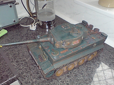

Is it me or is the El-Mod site the most confusing place on planet Earth?
I have a Heng Long Tiger 1. Full Metal options fitted eg tracks, gearboxes, suspension, hatches etc etc. It weighs a ton!
I am trying to figure out how much I need to spend to convert it to the ElMod system so that I get the sound, proportional speed and turret rotation, whilst keeping the airsoft gun, and if possible the smoke unit? I cannot figure out what I should be buying??
Just to complicate matters I would dearly love to get hold of the Creeping Death Tiger Turret so that I get an airsoft gun, plus laser with extended barrel and recoil.
On top of that I am looking at fitting some decent motors. Though only if they improve on the whitecaps that are currently installed.
I am happy to buy a new tx.
(I daren't mention that I am also an old fossil from the UK who works in IT, I still have trouble with a video remote??).
Can anyone list the parts I need, and the cost either direct from ElMod or the U.S. I would be very grateful.
Hoping there is someone out there willing to take pity on a befuddled Brit!

hi ,you would need the thinktank booster hl/m, thinktank tls and the thinktank blaster 2, comes to about £170, i got mine from blitz rctankwars.com, but he wont be getting any hl chips in till dec, but he has the prop version on the shelf

Why buy a recoil unit when you can buy the whole turret with upgraded gun etc from Creeping Death??? It makes no sense. I just ordered one.
