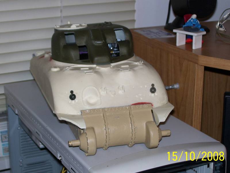

well gotsome work done on the skink as some parts have come in here are the results
the new hull had to have the inside shaved back 1/16 of an inch all the way around to fit the sherman hull corectly if you done trim it the hull rided on top of the aluminum hull and I wanted it to sit corectly over the hull
I reshaped the fenders and attached them to the hull and when you place the upper hull on every thing lines up perfect
you also need to trimm the lower hull at the rear flaps 1/8 of an inch so the upper hull will sit over the rear flaps

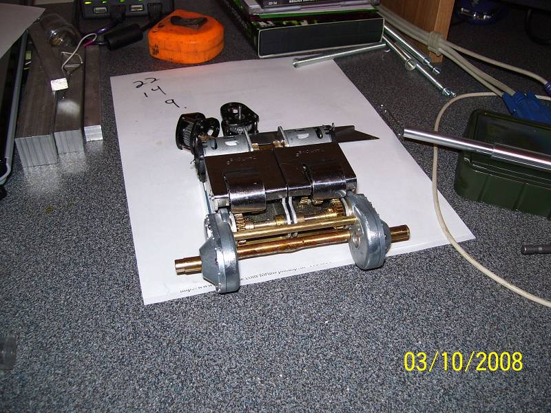

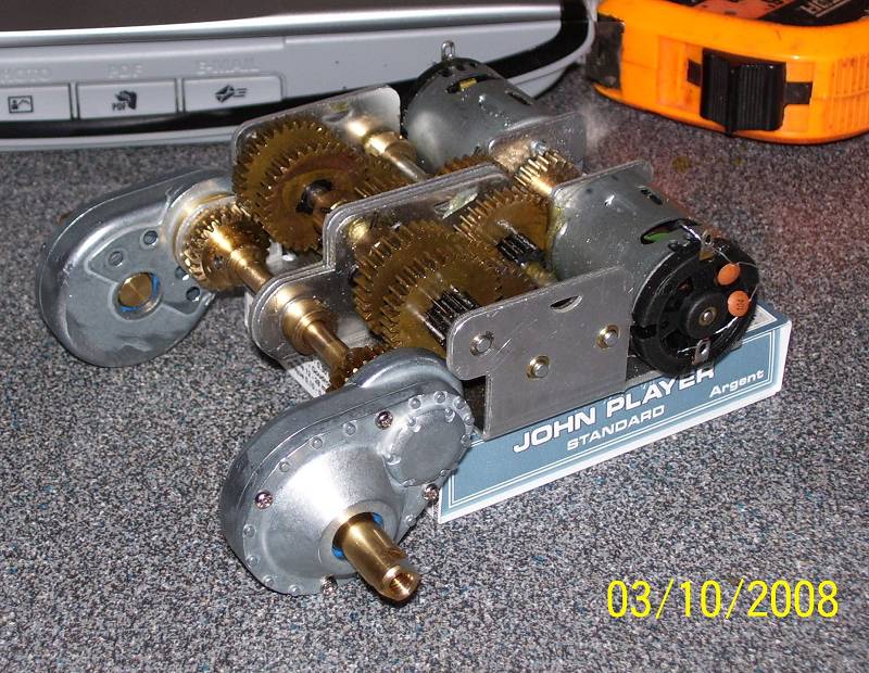

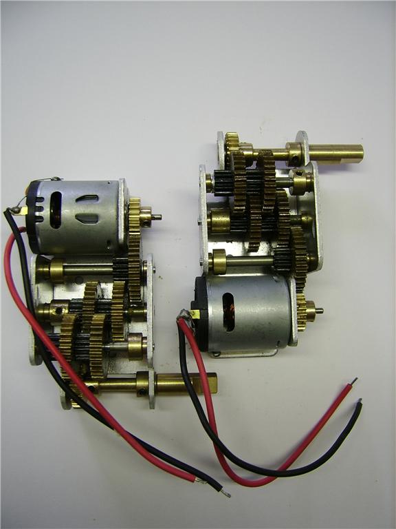

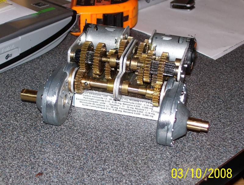

Default RE: skink

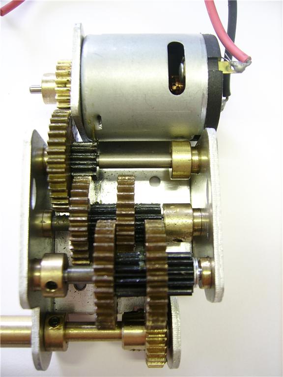

Great topic for a conversion. Can you give me a few pointers on the "bolt nose" transmission cover and gearbox setup? I was looking at you sexton page and what I gleamed is you used a pershing final drive setup? Was that the tamiya final drive?
Old 10-16-2008 | 11:52 AM
bubbajoexx's Avatar
Joined: Jul 2008
Posts: 803
From: toronto, ON, CANADA
Default RE: skink

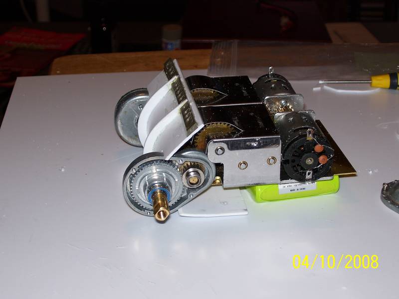

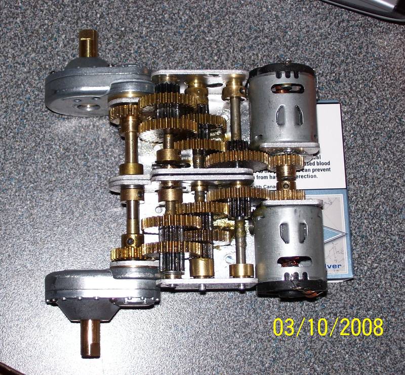

the drive is made of tamtoy and tamiya pershing out drives this can only be done using tamtoy gear boxes as the are the only dirve with the needed offset to mount the outdrives to

Default RE: skink
I see the concept, did you have to do any mods to the gearboxes themselves? The outdrives look fixed in position.
Old 10-16-2008 | 01:37 PM
bubbajoexx's Avatar
Joined: Jul 2008
Posts: 803
Default RE: skink
the original out put shafts are tuned doown to equal size IE the large end turned to 5 mm the the shaft is reversed in the housing the the outside end flatened on each side to except the pershing driven gear the the gear cases float on the gearbox with 2 tierods conecting the 2 together right and left the an ancore plate made of brass is attached to the lowwer rod the bolted to the tamtoy gearboxes this make every thing one piece and stablizes the outdrives and keeps them perfectly allined

Can you show one of the outdrive cases opened so we can see how ya attached it to the TamToy gearboxes?

Now you got me thinking this route might be easier than the T34 metal gears + TamToy heavy duty boxes + DT gearbox mods.
What it cost ya for the Pershing outdrive components? I'd be balancing it against the T34 gears and DT mods...

28 dollars for the pair of outdrives

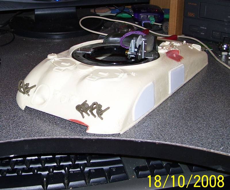

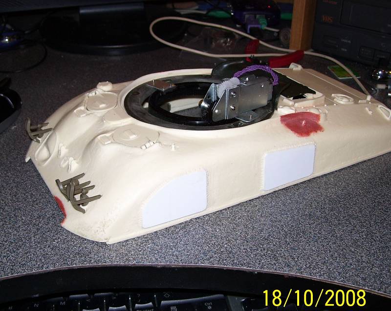

finaly got around to puting some of the smaller parts on the skink hull I use the early head lights and tail lamps and brill the holes needed for the tamiya lights then I use window glue to film over the lights to glass them over then paint acordingly added side armour plates and put weld beads around them using MR putty light cages horn rear engine hatch next will be building the fenders for the side front and rear

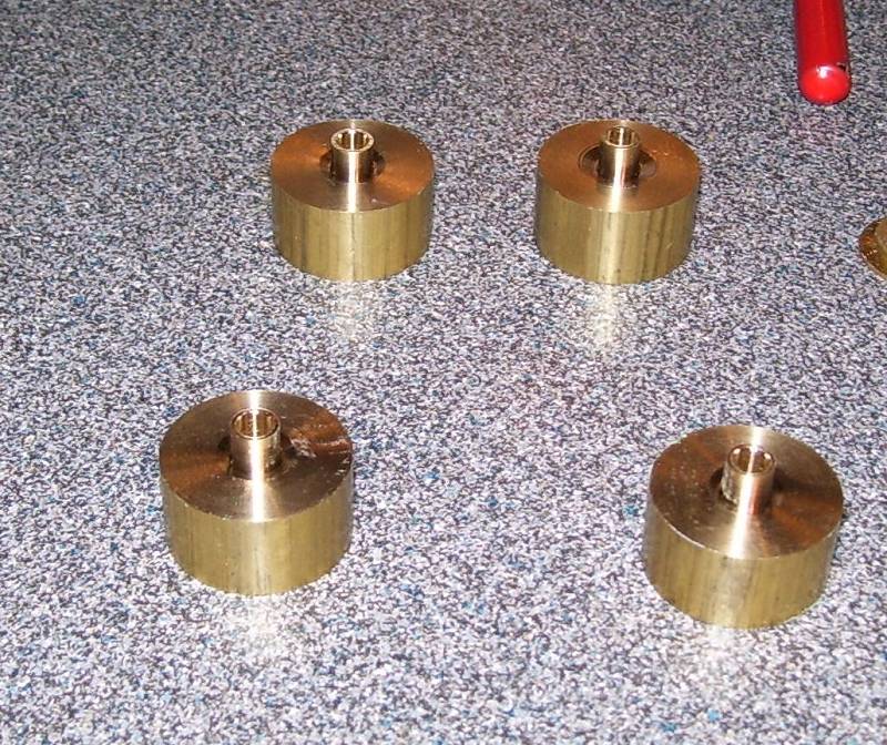

started to build the machine gun 20mm rollers to insert into the turret they will be full up down movement and synked in and out as fired
these brass rollers will be shafted together and mounted into a rottor block attached to the turret base as well as drilled and barrel slides installed ito each one then I will cut the barrels to fit into the slides
