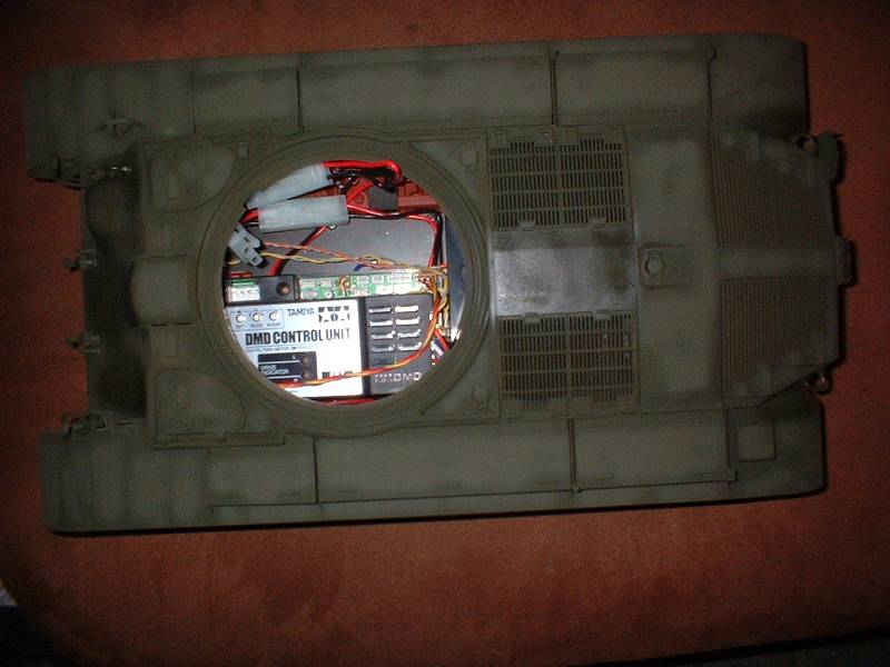

Very cool, look forward to your spin on it! Can you show the inside of that beast?

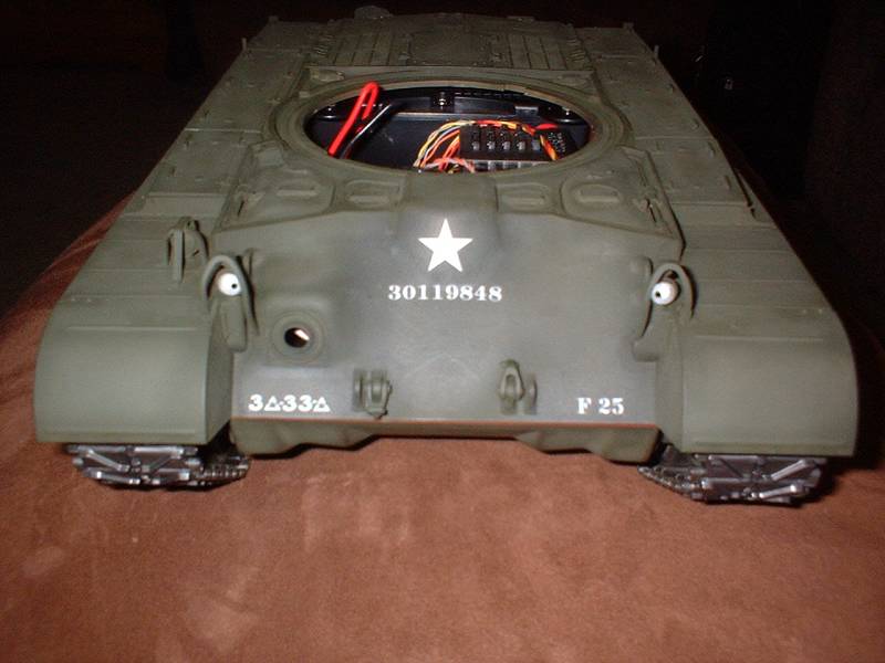

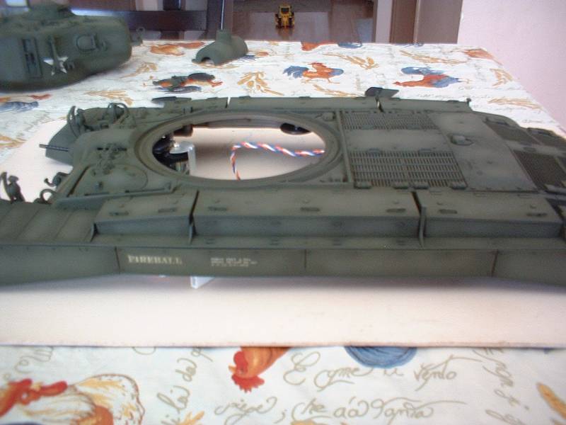

Now that I take another look at it, I can see many hatches that I should've opened up. I like the rear engine hatches opened up by Pete. Regrettably I have glued the h*** out of mine. I'm afraid they're on there for good. The stowage bins on the fenders would've been cool too, but oh well. I'll save all that for the KT which is on deck.
By the way, I was looking up some pictures of the Pershing in WWII to get the markings right, as I don't always trust the Tamiya suggestions, but have not found good pics showing the markings used for the time period, especially those used by 3AD in Cologne. I couldn't confirm any of the markings that Tamiya suggests. Can anyone recommend a book or website?

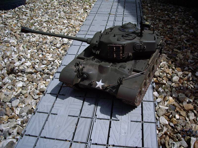

Mig as far as i can tell the tamiya are almost spot on,
but they did not use the LIFT HERE on the front of the germany ones and can not see the white star on the right hand side ie under the comanders cupola it would appear that the rest is correct to the best of my knowledge, i hope this is of some help, unless anybody knows
they thing different.

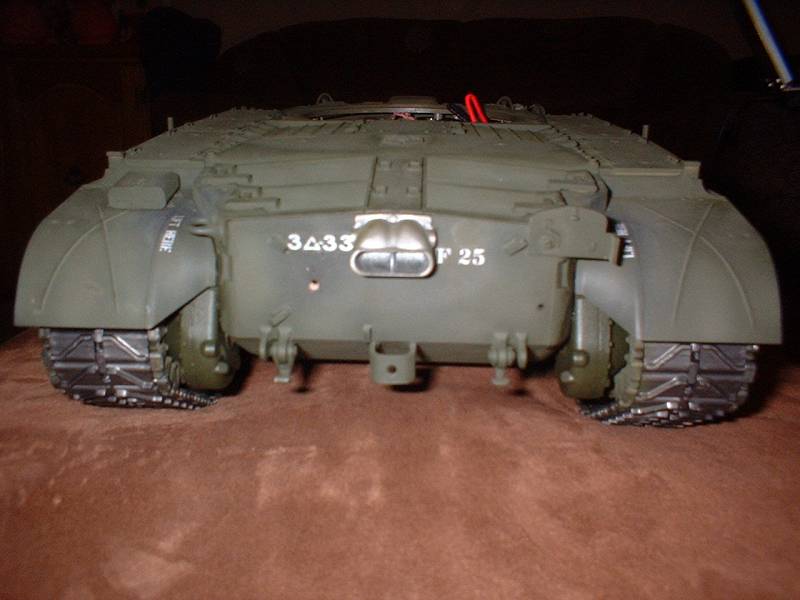

hasty note the tank in the Cologne pics shows that, it may have painted out its front star and added its number
right across the blower cover on the front glacis, also this tank had larger numbers on the side skirt,
more or less above the second rear wheel.

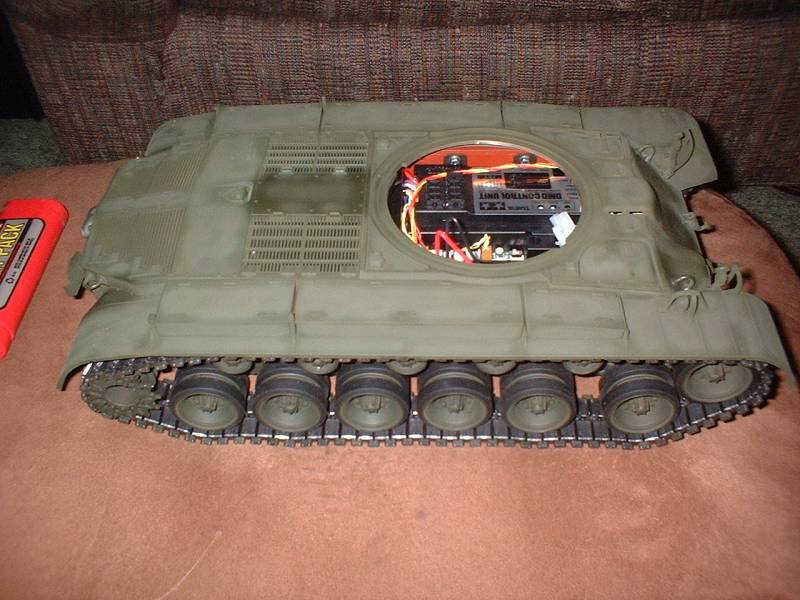

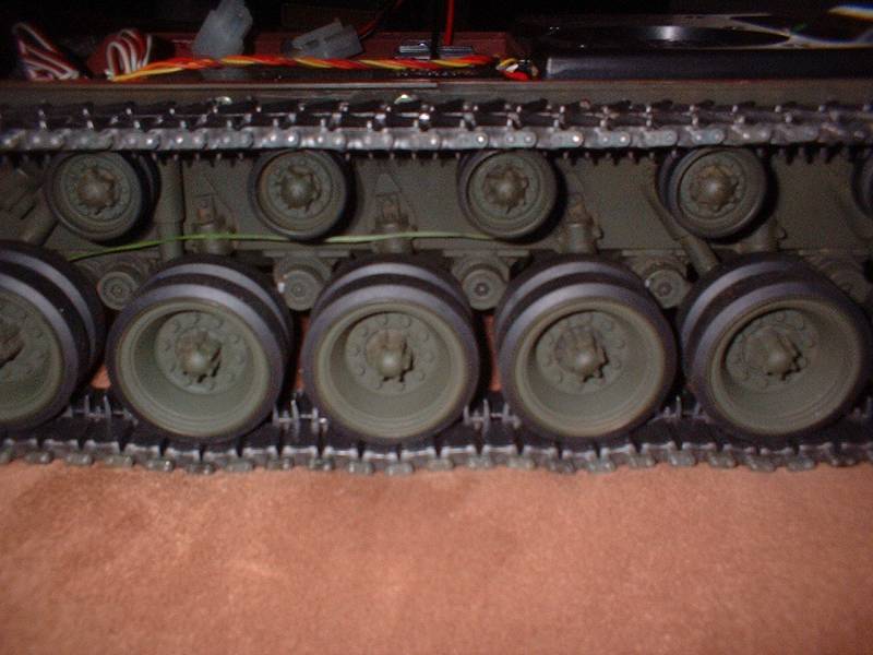

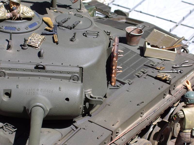

I finally got around to applying the decals to my Pershing and starting on some weathering. I used some "sprues" from an old PE set to replace plastic tow cable holders that came with the kit. I'll be making a cable later. Still looking around to see if the WWII Pershing had any periscope cover guards anyone know? I checked out the price for the pershing book, but at $80 on ebay, I'm priced out of it. I found some pics of the Cologne Pershing here:

Thanks for all the feedback, guys. I was up in Canada for a week earning the $$ for building my tanks (and maybe eating), so I haven't had time for posting anything. I have done a little research regarding correcting the Pershing to the Cologne tank. From what I can tell in the pictures I've seen, the WWII Pershings didn't have the telephone box on the rear of the hull, so I'll have to remove the backing plate I've attached. I will also, unfotunately have to add the tie downs on the fenders and storage boxes. I'm not sure what to do about the oversized blower housing other than blanking out two of the four vents on either side. It's kind of hard to tell the difference in the Cologne film I'm using for my primary reference. I also see that the tracks supplied by Tamyia are Korean War types (T-81?), but I figured I'd wear these out and replace them with the proper steel tracks (T-66?).
I'd like to open the driver's periscope. It would be hard for him to drive buttoned up without that!
I really regret having glued the engine deck hatches shut. I want to wire a switch and plug for recharging the battery through the assistant driver's hatch. It would be a pain to have to remove the turret every time I want to recharge the battery. I know I've seen it done here on the forum. Does anyone know how to wire the switch so I don't have to disconnect the battery from the DMD each time?
BTW, I started this thread after having assembled some of the tank. I had replaced the bushings with sealed ball bearings already. I will deal with the TBU and the turret once I finish with the hull!

I used a double switch with two rows of three pins and wired the battery to the middle two and the recharge plug to one end set and the DMD to the other. If the switch is set in one position it connects the battery to the DMD and in the other position connects the recharge socket and isolates the DMD. I hope this is understandable as I know what I am trying to describe but maybe not describing it well.

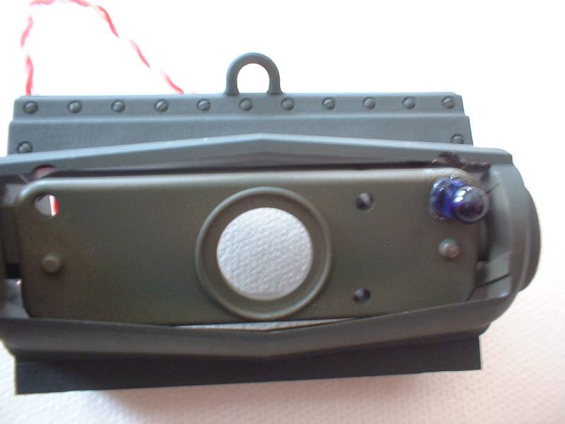

I had to abandon my project for a while but have come back to it with a vengeance. I ended up not hiding the TBU but I did hide the IR transmitter behind the mantlet. I also epoxied the clutch in the turret traverse gears. After trying to fit a switch for the charge/discharge cable to the battery, I decided there wouldn't be enough room in the cramped hul for a switch and all the wiring. Here are some more pics. I think I'll finish all the detailing work this week.
