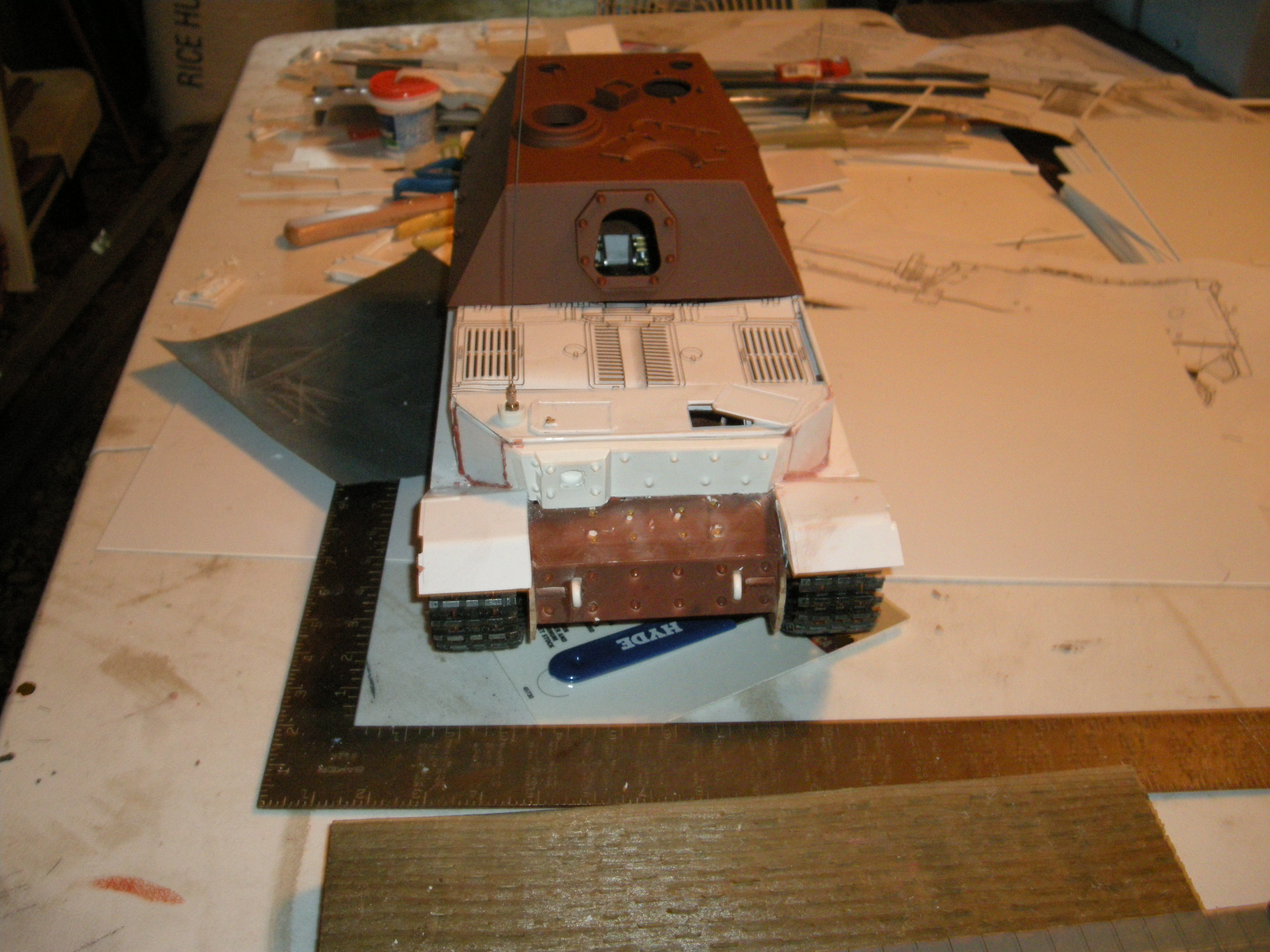

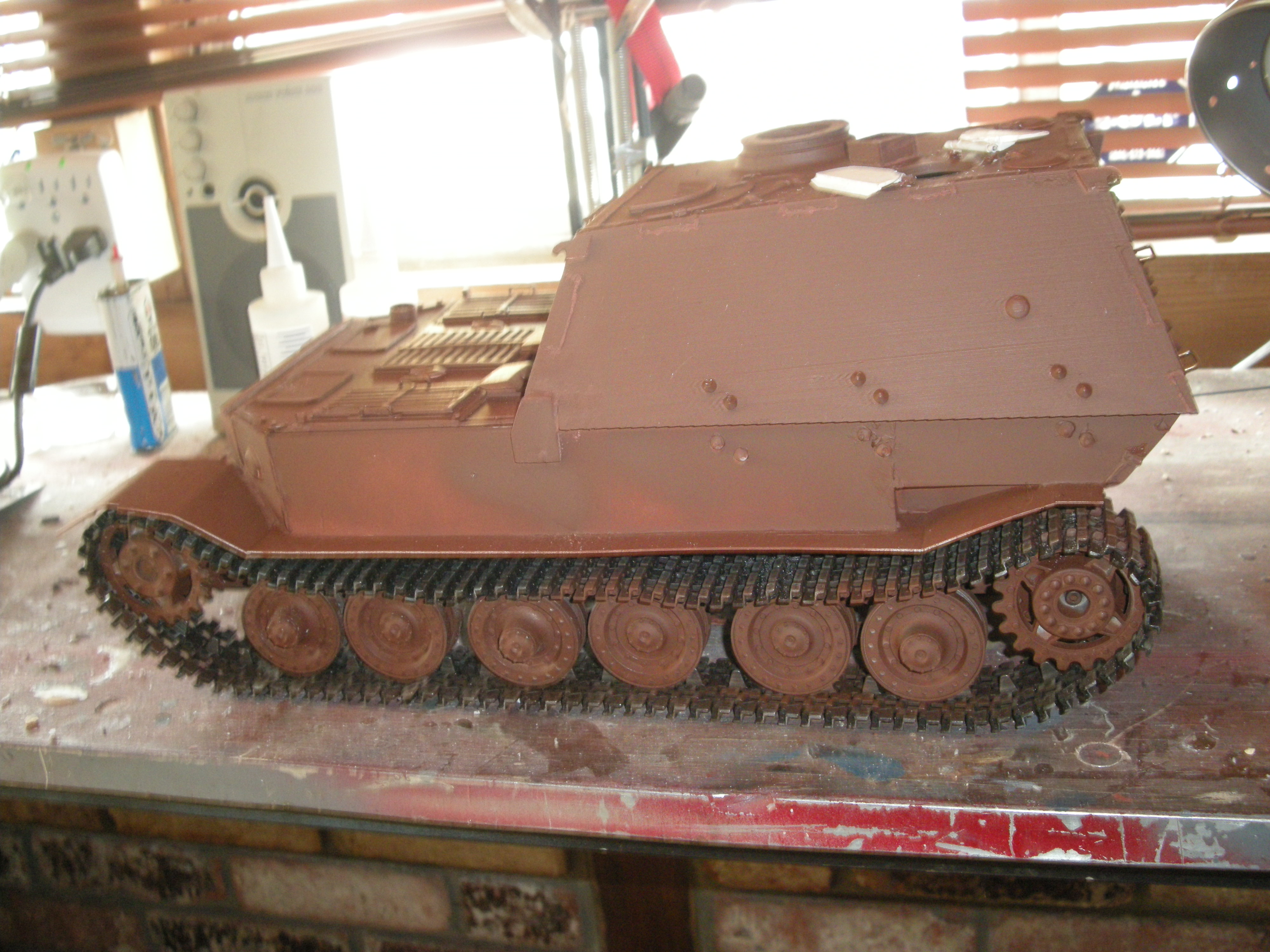

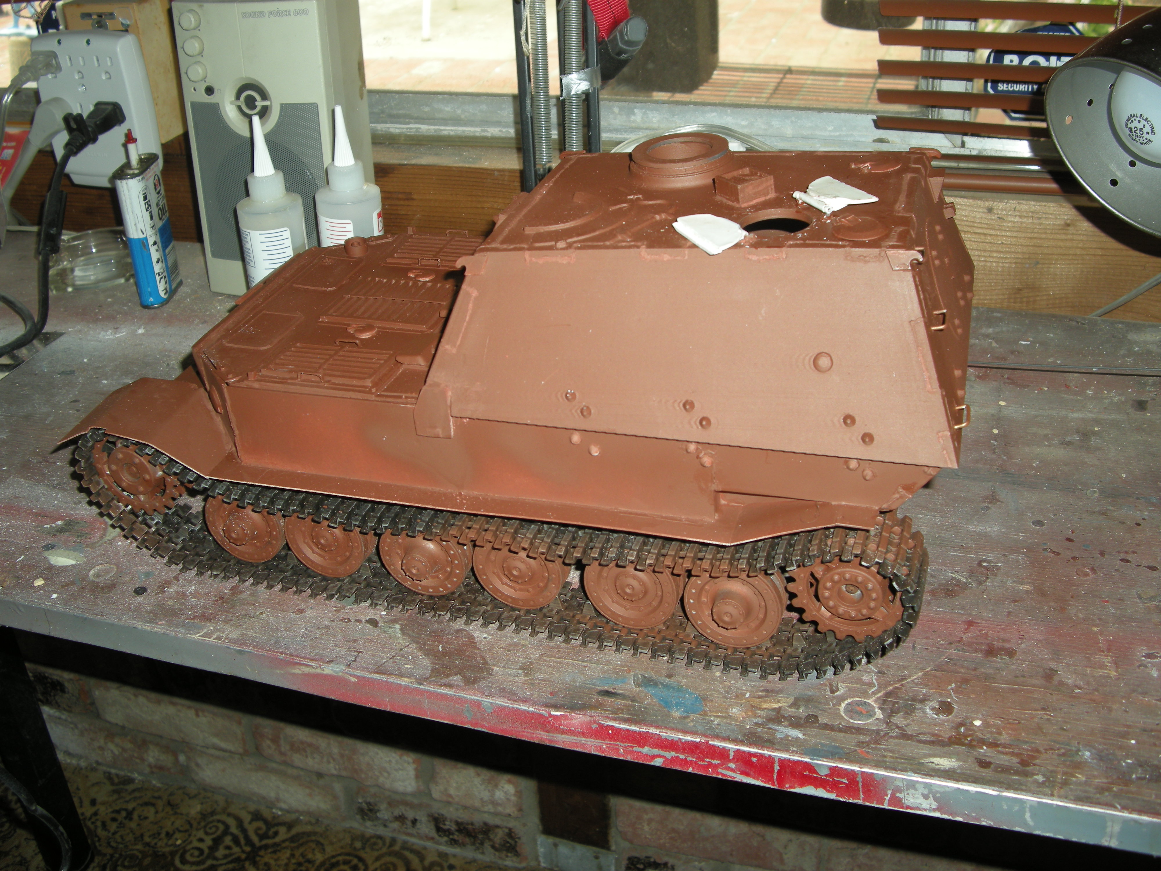

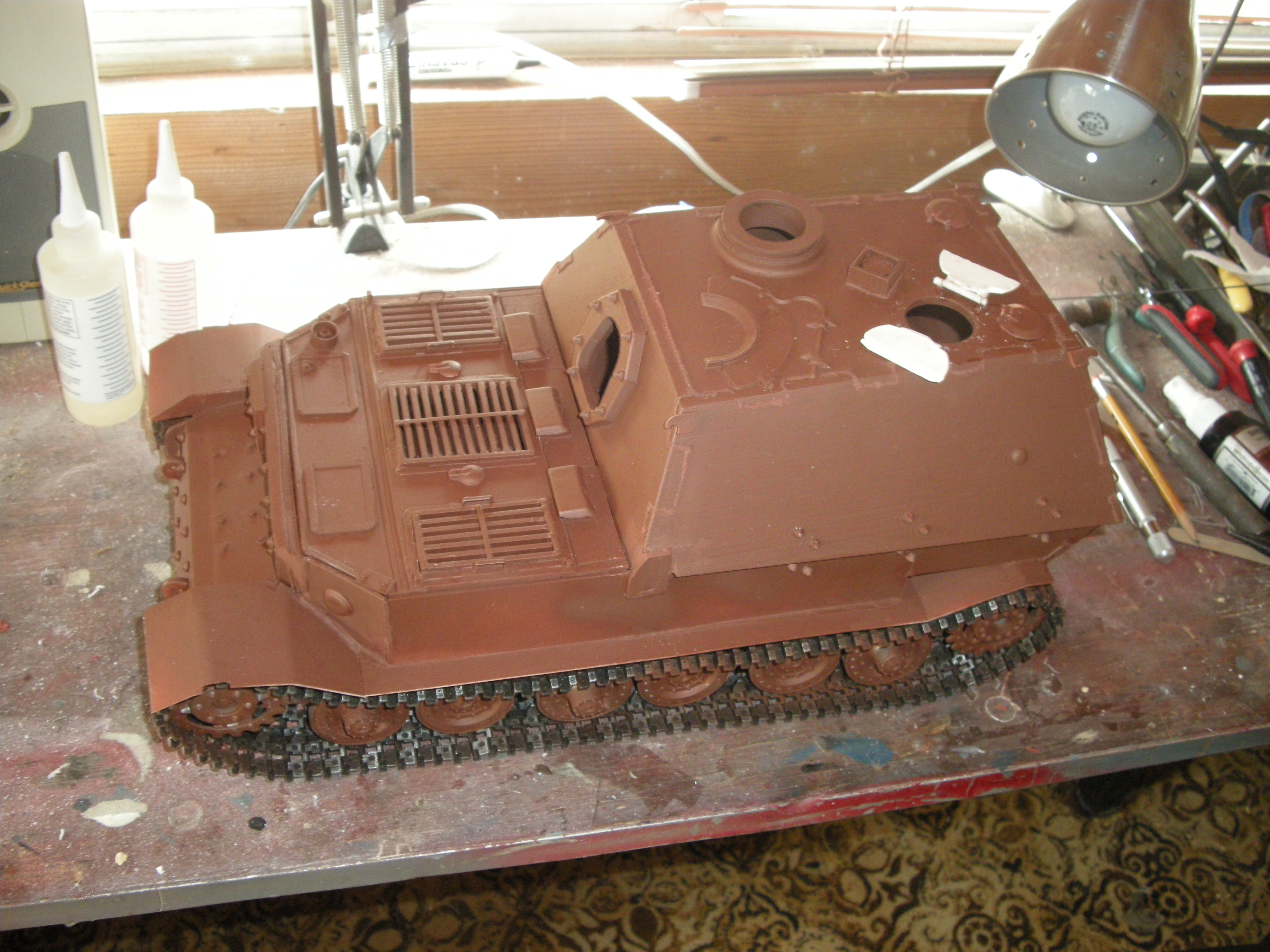

ORIGINAL: kclank

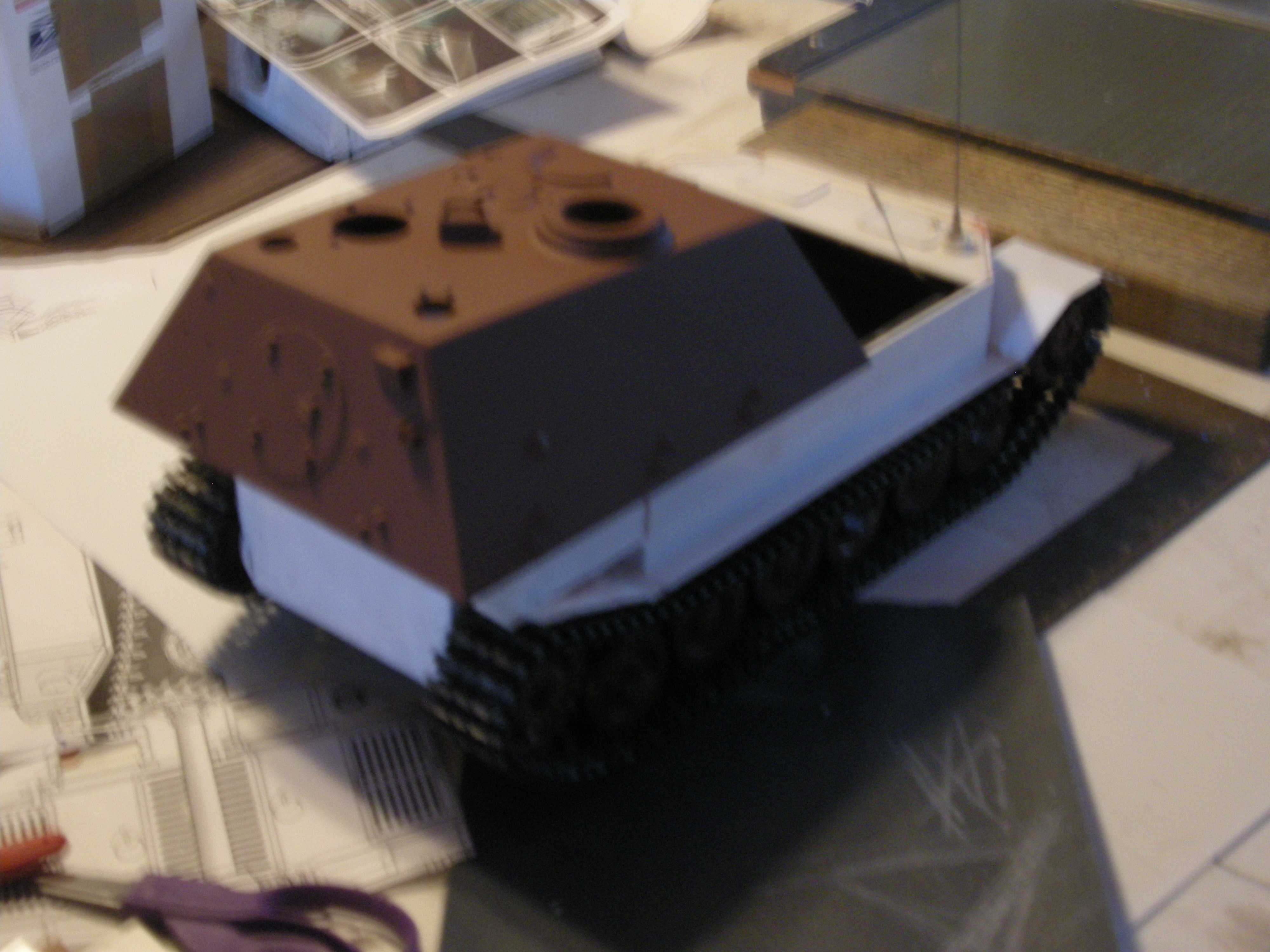

I am sure i will get laughed at for this but here are some shots of my Elefant build. Background: I am using Tanks and Trolls upper hull. The tracks will be Heng Long metal Panther tracks until impact or someone else brings out a correct set. The sprockets will be T1 with 4 spoke facades, the original plan was to begin modifying a Pantiger hull but it looks like it is easier to scratch build a plywood hull instead. 3:1 gear boxes being used. I want to make the suspension work like if not look like the real thing but i will have to see how it goes. I am using aluminum road tires with resin inserts to the road wheels. In the final form the wheels will be grroved to make them look like pairs of wheels but the will only have one bearing per set. So all comments, critiques, suggestions, praise and laughter are welcomed.
It has been a while since i have worked on this project but with the imminent threat of Hooben producing one i thought i would get back on the stick. I have thrown away most of the Tanks and Trolls parts as they were way to brittle and would not have lasted in tank battles. I purchased the Asiatam tracks and suspension parts, discarding my previous ideas on making the wheels, etc.
The running gear has been tested and works real good. A friend ran me a new fighting compartment on his rapid prototype printer (i dropped and shattered my other one) but it required lots of finishing, still needs more work but it seems to be coming in. i have used about 3 pounds of styrene to build up the lower hull and the fender substrates. I am now working on the upper front deck (what you see is mostly paper), then the lower rear end pieces. Lots of little brackets, clips, holders, restraints and mounts; holes to drill and bolt heads to be installed. the fenders will be finished with tread-plate. i have not done much thinking about the gun assembly yet but i am planning elevation, traverse and recoil. The electronics will be Tamiya. With the size of this beast i could probably put in a 6" speaker but we shall see. here are some updated pics. comments are welcome, but be kind.

Nice!! Quite a project, but I see it's coming along well.
How good are the asiatam tracks and suspension? Are the rear drive sprockets set up for Tamiya TU's? Do the wheels have bearings? Got a project I'm considering...

The drive shaft diameter is the same as tamiya so it should work, you might have to file a flat. The aisatam quality is excellent. all wheels including idlers have ball bearings. the spring rte is a bit heavy so i have wound my own springs for the center suspension set and removed some metal from the outer sets. In reality there also should be a set of torsion bars for the main mounts but unless this was a full metal tanks weighing 30 plus pounds it would have been way to much so i elected to not put any springs on the chassis mounting and just let them rotate freely. If that does not work in the field i will come back and install a light wire torsion bar. I can recommend the aisatam stuff most highly.- It is also best to disassemble them and reattach using lock-tite on all screws.

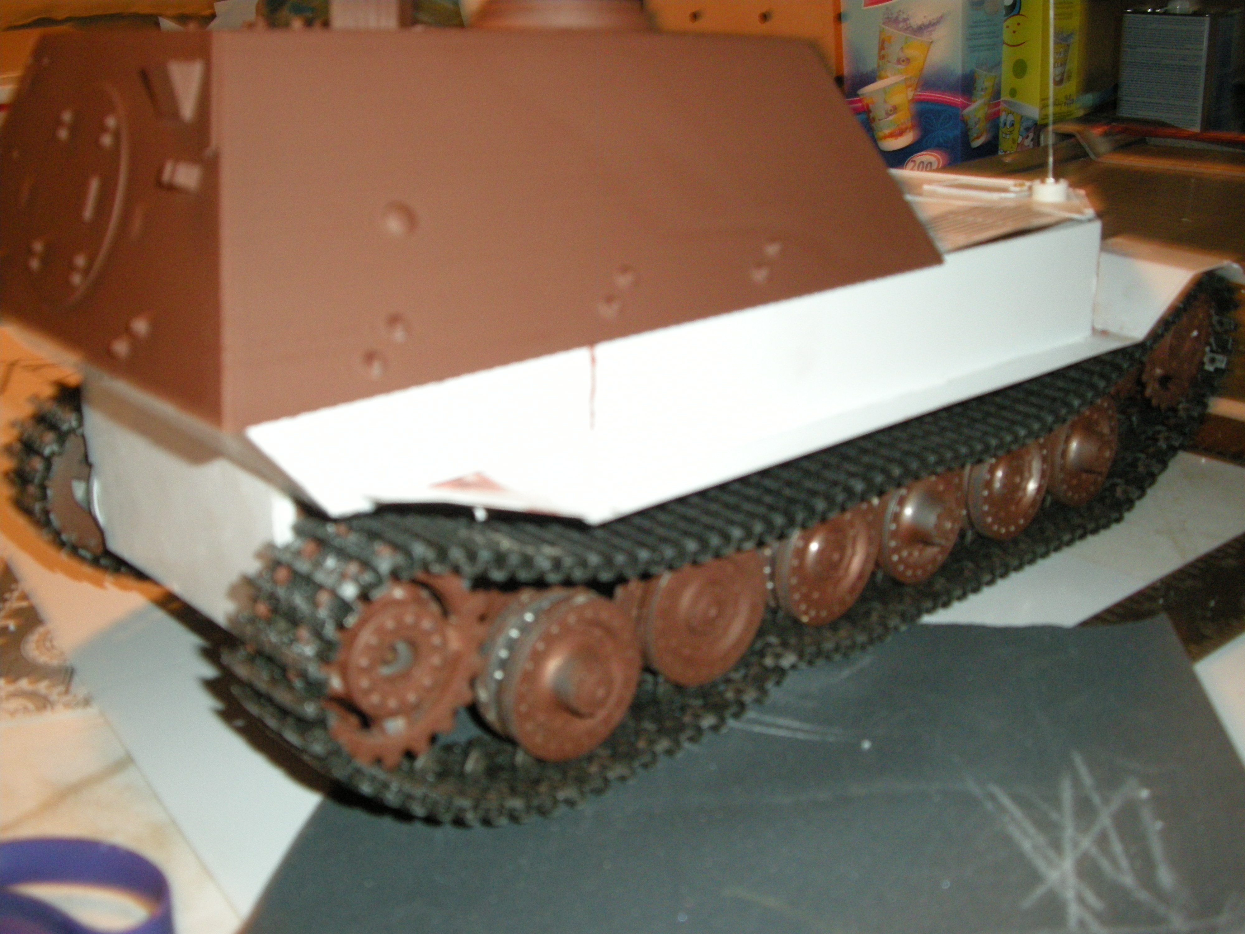

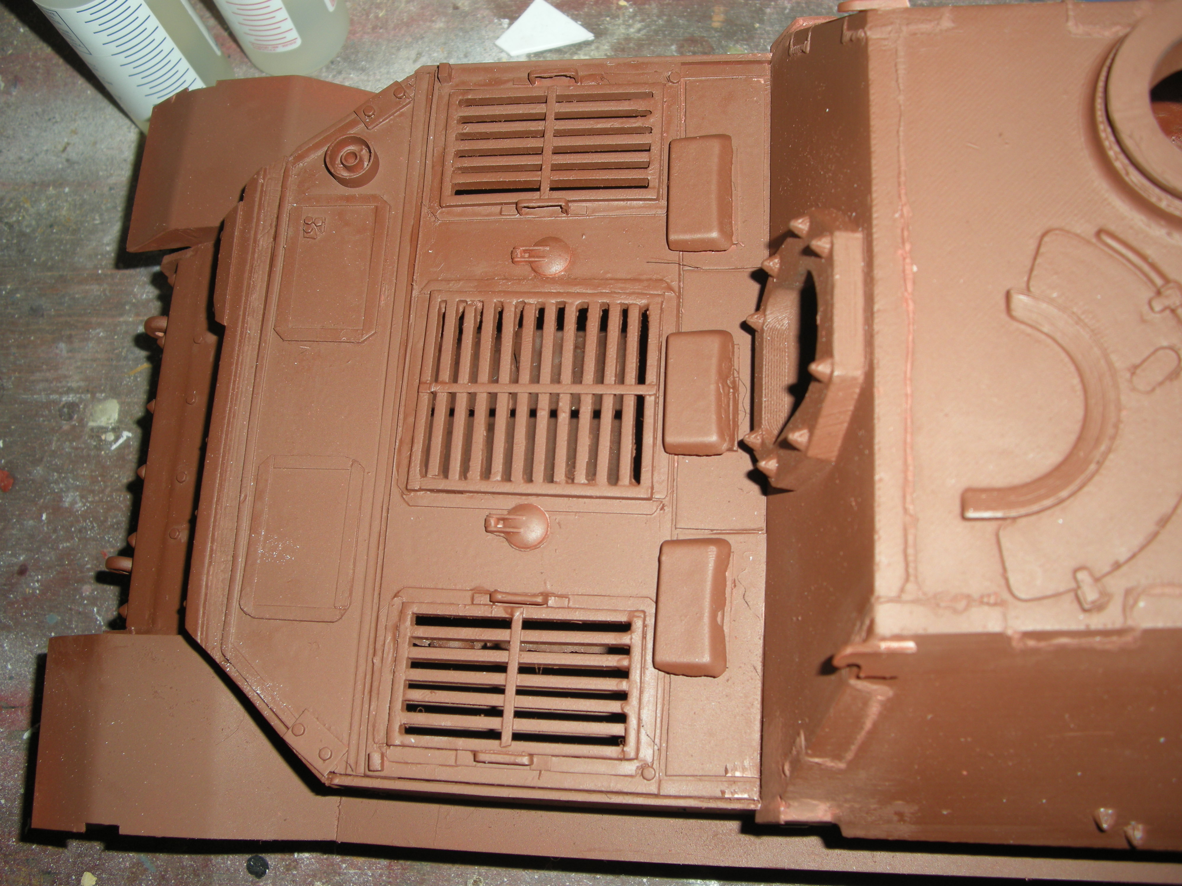

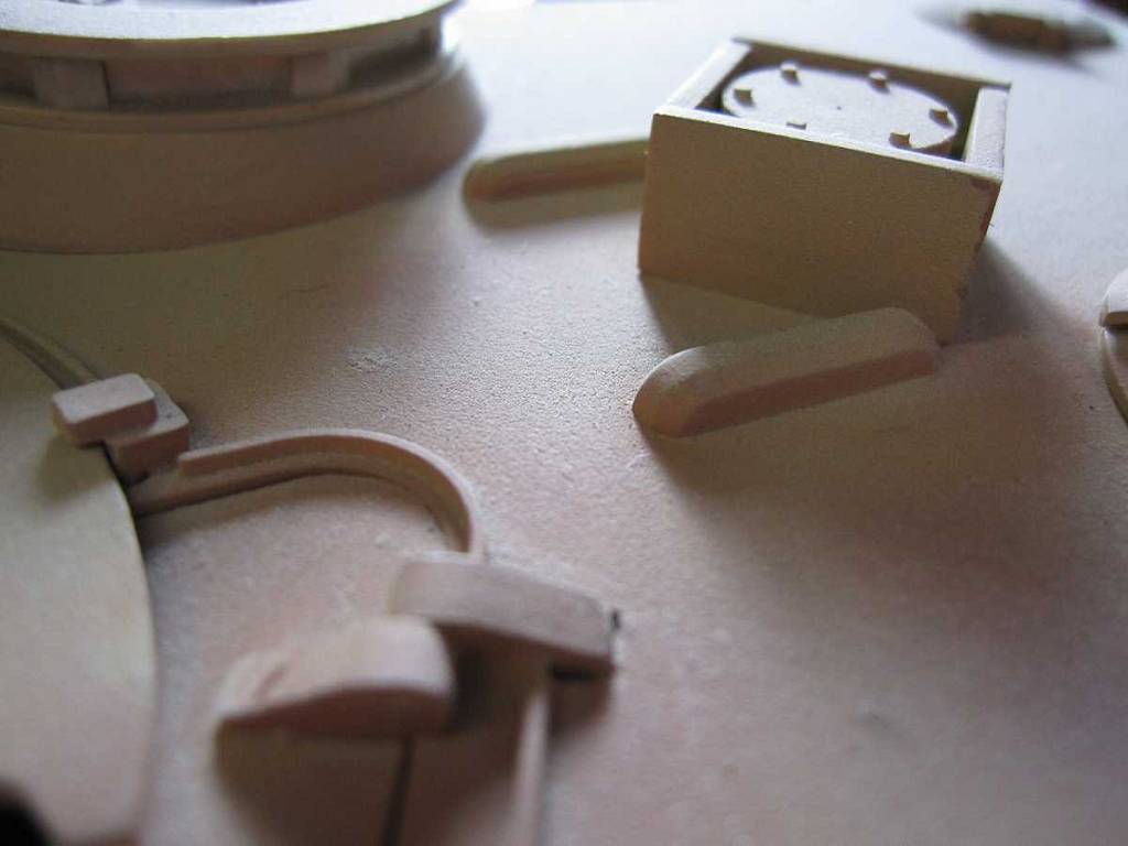

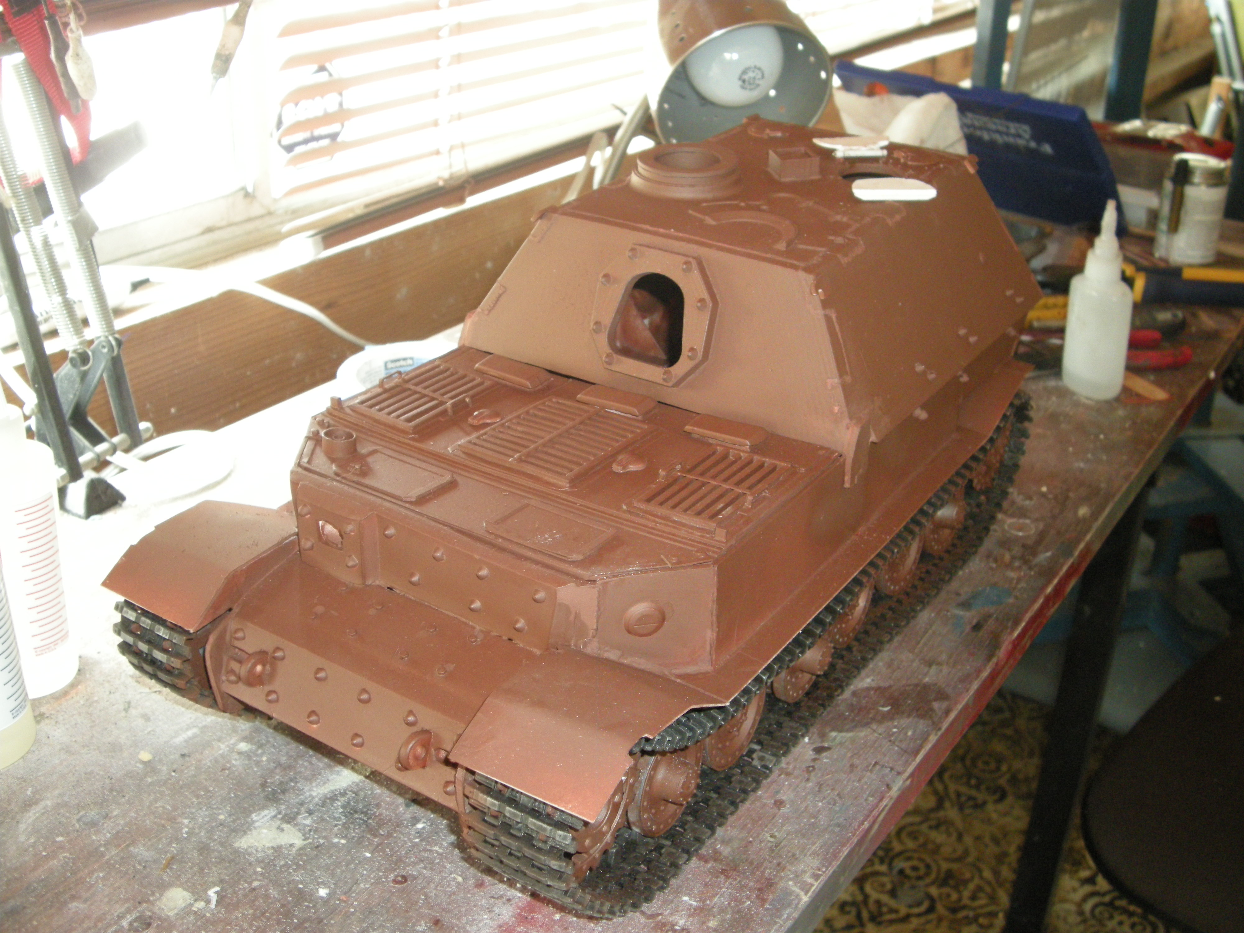

a bit more progress. still have the rear exhaust area to do, plus hinges, bolts, periscopes, cables, clamps, hatch details, fender tread plate, tools, and of course the main gun assembly. I think most of the tedious stuff is coming to an end. Hope you enjoy.

What are you smoking? It never ends, it's all tedious! You know that! Sometimes the details take longer than the big chunks, at least on my stuff.
Your joints, seams and welds look great. If you found some kind of magic paint that makes a model look great, send me a few gallons.

That REALLY is looking great Ken. I'm glad the Asia Tam tracks are good quality. I'd like to make a recovery version of the machine and possibly an example of Porsche's original version w/ turret....
but then there probably isn't any machine I wouldn't like to build.

Ken I know you asked for some info offline but perhaps the photos I took may be useful for someone else.
I successfully uploaded the photos of the Elefant's roof here I usually move photos to my website and reference them there but I thought I'd try something different.
Jerry
