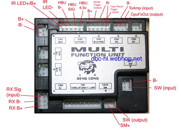

On the RX18 board, what does the HBU connections do?

Heng Long Battle unit! As in IR sensor TBU, DBU

So my five and two to eight pin connector harness plugs in here, but what does the eight pin side plug into? I've gotten the upgrade to HL IR BAttle, but this does not make sense to me....
