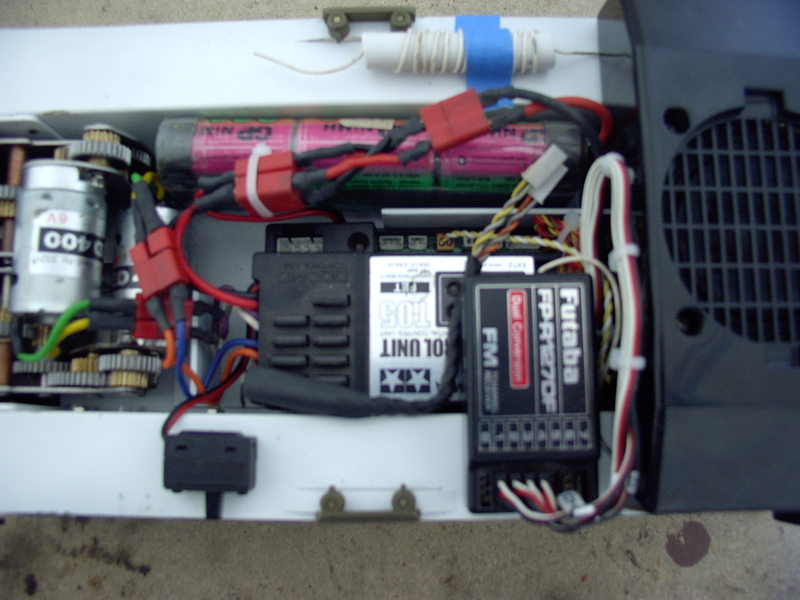

Get rid of the antenna and put it inside. Pzrwest had a thread about putting one inside, so you don't have yet another wire going up to the upper hull.

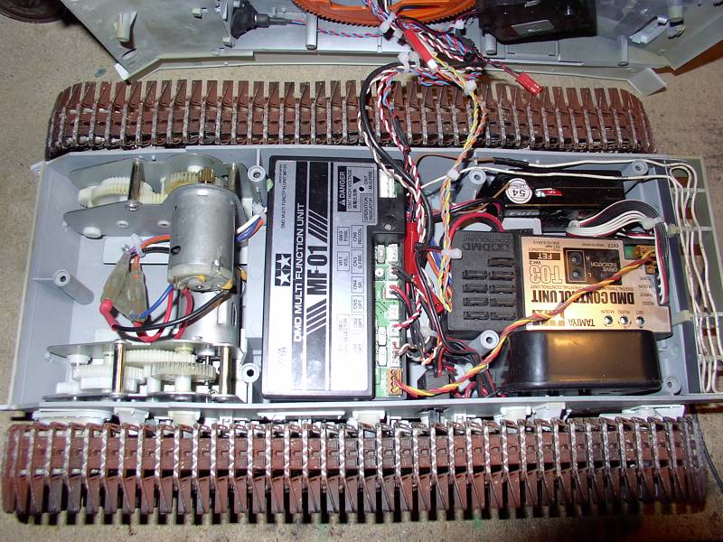

Or you could do this. Whatever you do, try to keep the length of the wire/antenna the same length. The P3 antenna will fold down automatically, and can be used as a functional antenna or cosmetic. Coiling the antenna lead around the plastic tube does not affect the range at all. Just keep the coils seperate. The photo is of the system installed just for fitting in my article about eletrical hygene. On the P3 innards photo, I just notched the rear extensions and put the wire there. He will be changed on my next P3 to make the prototypical antenna functional.

Nice internals. I am that way myself. A rat's nest of wires looks so unprofessional. Zip straps and wire routing, look so much better. Good job.

Like wise, I have shortened the antenna to approximate correct length on several of mine with no discernable adverse affect on control, but mine rarely get more than 50 ft away. I have to agree with Panther F on keeping the antenna inside. On suggestion, I have done this with 4 of mine, keeping away from the motors and it eliminates the eye injury possibility. I like the idea of coiling around a plastic tube. Only external antenna on those is a a soft, very flexible one to fit the model.
