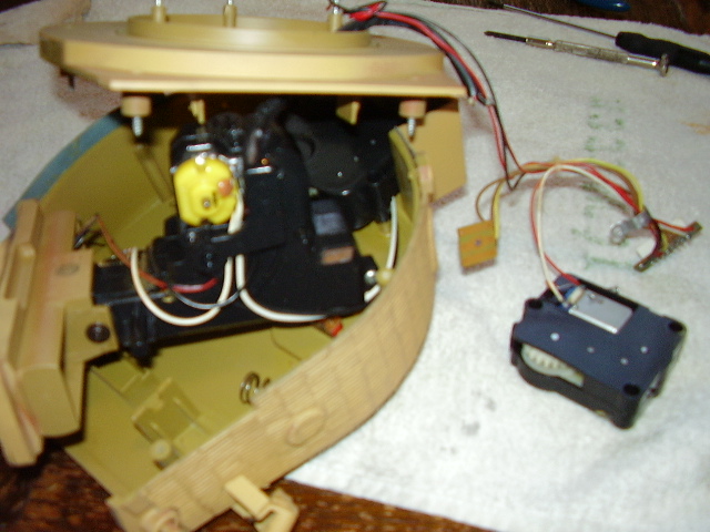

Fellow Tankers, I am trying to figure out what wires do what on my tiger. I was on here a while back and was instructed to try the new airsoft gun first by directly wiring it to the battery I did that and it worked.My problem being when I wired it in the tank nothing. I have eliminated the red firing light and wired the gun to the red and black wires coming up through the turret ring (they are smaller diameter than the gun wires) is this wrong?I can't get the elevator or gun to work.[]Please help???????

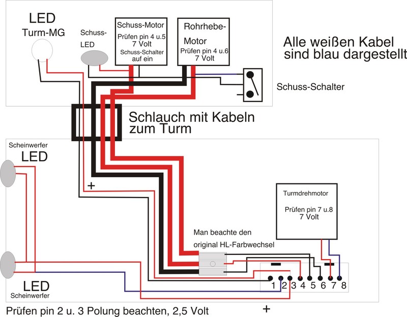

these pictures any good,don't go off the colours, trace the wiwing
regards Jack.

Thanks for the replies. I think the wire coloring is confusing me the new gun has blue and yellow and the old wiring is black and red.Not sure how to hook it up with out gun light?What goes to the elevator! Already tried the switch under hatch nothing.......[&o]

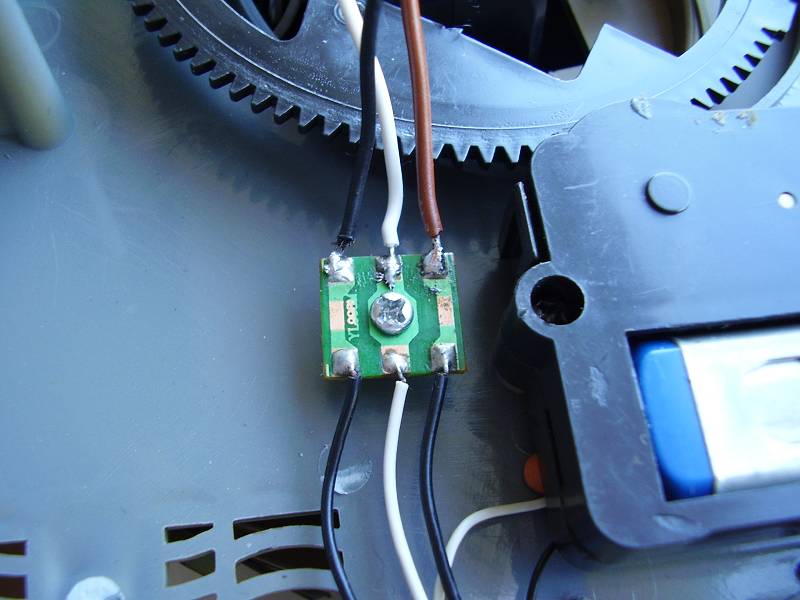

These any good, but as i said be careful of the colours
regards Jack.

Ok, I surrender I cannot make this gun and elevator work.[&o] This tanks gun never worked from day one . Everything going to the elevator is still hooked up and did work the new gun works as long as it is not in the tank.There are only two wires to hook up both from the gun but I just don't know where else to try to solder them.Beyond frustration .......[]

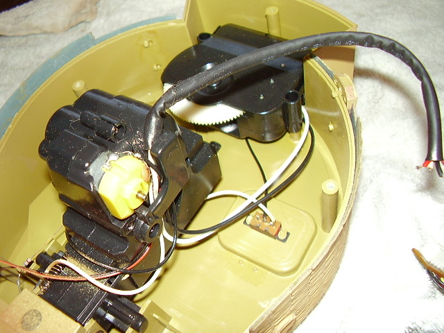

Sorry M-E 109 my camera is not working. In your pic is the white wire that is hooked up under loaders hatch is that the hot (pos) wire? My wire from elevator is hooked up in middle of here(Blk) .There is a red and yellow that come up thru turret ring and are fastened to the elevator in turret. My gun has a blue (neg) and yellow (pos).If the yellow goes next to black under hatch where does blue go? There are NO Leds so thats not in question.Thanks, I am electrically challengedJay

Found some more pictures, different tiger than the last pictures so the colours may differ again
regards Jack,
