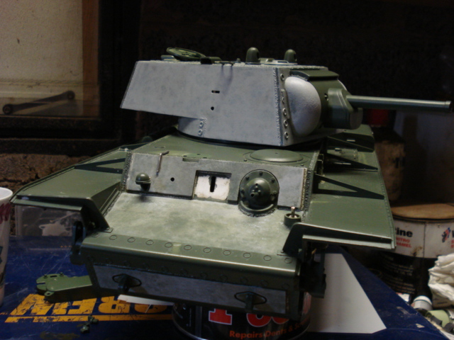

my heng long kv-1 as it stands while awaiting upgrade parts to become avalible,converted to a different production model i didnt like hls Ehkranami armour as all the nuts were off center and i prefer the cleaner turret
turret done with the exeption of a scratchbuilt pistol port plug,periscopes and new gun mantle(waiting on order from tankzone) hull still needs lots of work yet and im not happy with the upper hull welds the upper deck welds should be higher not level
opinions welcome

Nice work so far! Yeah, the HL KV-1 is a great blank canvas to start with. When I get up the nerve I want to start cutting up mine too!
Nice pics!

from what i have information wise there were a huge nuber of variations just to production models let alone the prototypes/projects ....lots to be working with

Like what you are doing here. I am back dating mine to a first production KV-1, by stripping the EK. armor, grinding off bolt heads that should not be there, filling lots of slots and holes, and looking for other small details to get it looking as right as possible. Glad HL chose not to go overboard with glue when they stuck on the armor.
I have put in a 6 volt gel cell battery, and modified the springs to make it move better and slow it down. It works super. still plenty of torque and a more ponderous suspension movement. Added in the HL strobe, larger speaker and waiting to finsh up the RCC battle unit installation, then it is final paint and off to war. I have also ordered some of the Modellbau track adjusters and front shaft bearing mounts as well as a few other items. It should be a great tank.

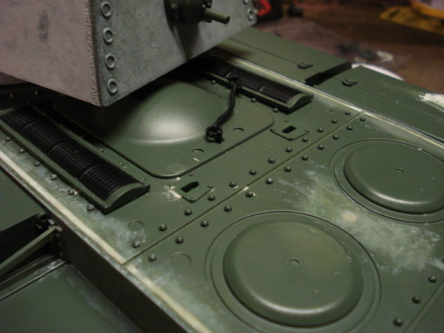

ok another update on my kv-1
filled in those holes behind the armour plates,with the armour plates cut to fit the holes
replaced all the nuts with styrene hex rod that got sanded off in the process
fixed the odd arrangement of the front fender supports
added more styrene nuts
finished off front plate minus working headlight im trying to get hold of and horn which will go on together as i want to see were all the wires go
widened engine decks
beefed up weld seams to look more like photos
not much more to do before i have to stop and wait for parts to become avalible i may add the "hump" to the rear rounded plate depending on which model i complete the tank as
