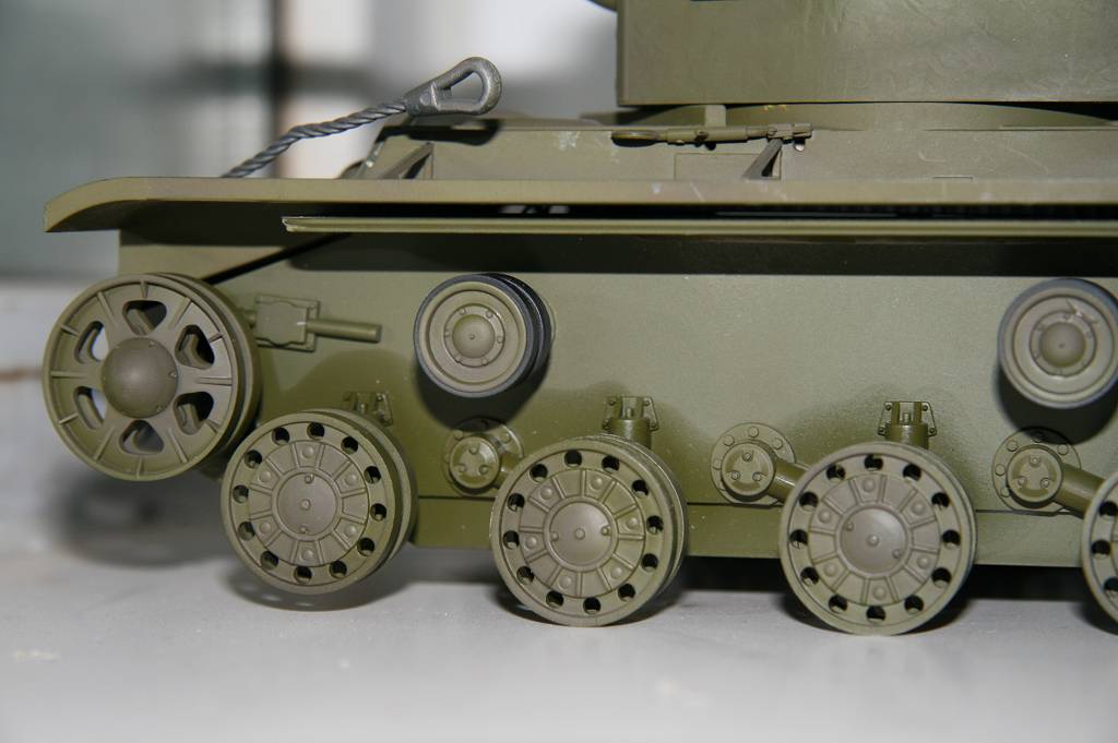

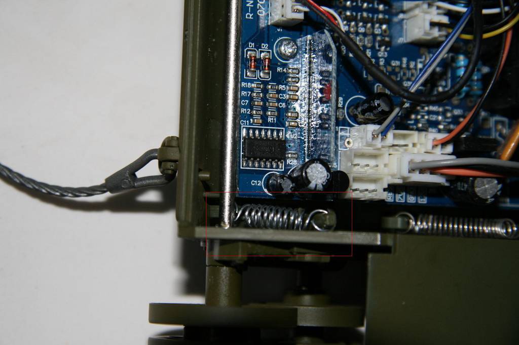

I have 5 vstanks which are almost perfect. But one problem makes them not so perfect is that the first running wheel can not touch the ground. At first I think that the tight rubber tracks cause this problem. But after I removed the tracks I found that the wheel still can not touch the ground. The picture from vstank.com illustrates the issue well as below.

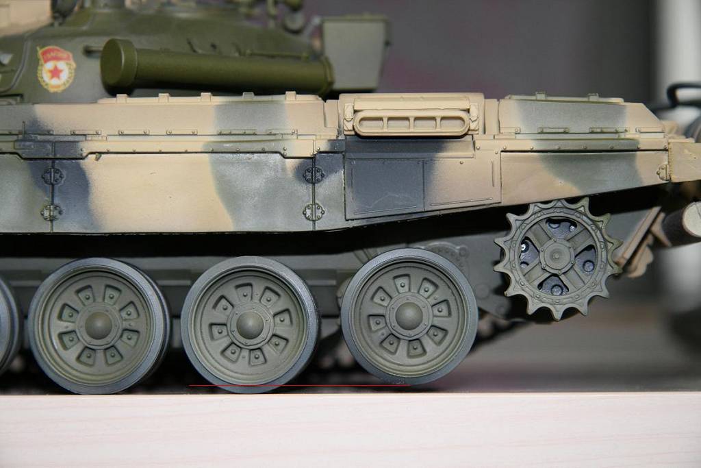

Old 08-24-2009 | 09:54 AM
Joined: Jun 2009
Posts: 28
From: , CHINA
Default RE: A problem of VS tank
The first and the last running wheels (track removed).

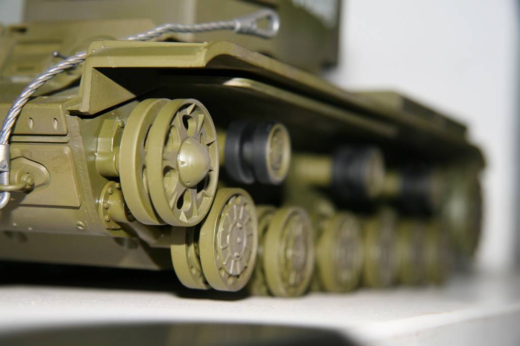

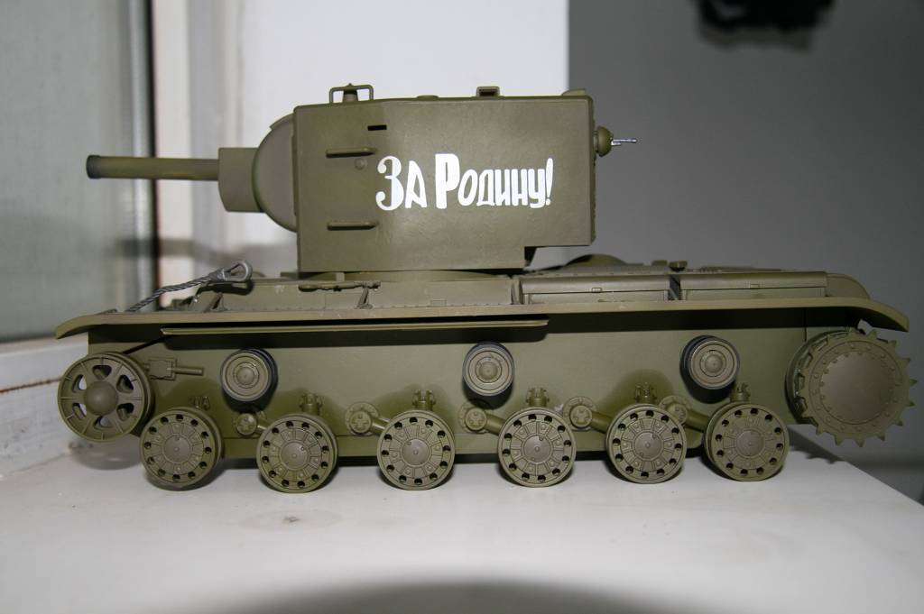

Old 08-24-2009 | 10:02 AM
Joined: Jun 2009
Posts: 28
From: , CHINA
The same problem in KV-2.

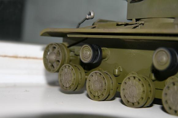

Old 08-24-2009 | 10:07 AM
Joined: Jun 2009
Posts: 28
From: , CHINA
remove the upper hull of KV-2

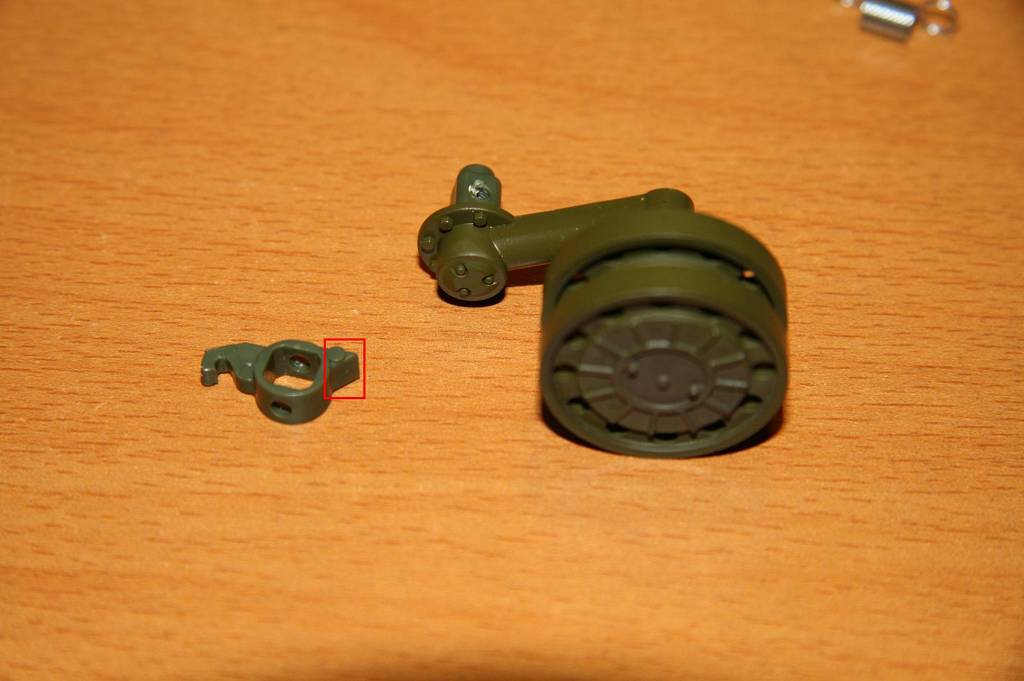

Old 08-24-2009 | 10:09 AM
Joined: Jun 2009
Posts: 28
From: , CHINA
After sawing the part in the red box off, I fixed the problem. Now the tank looks better.

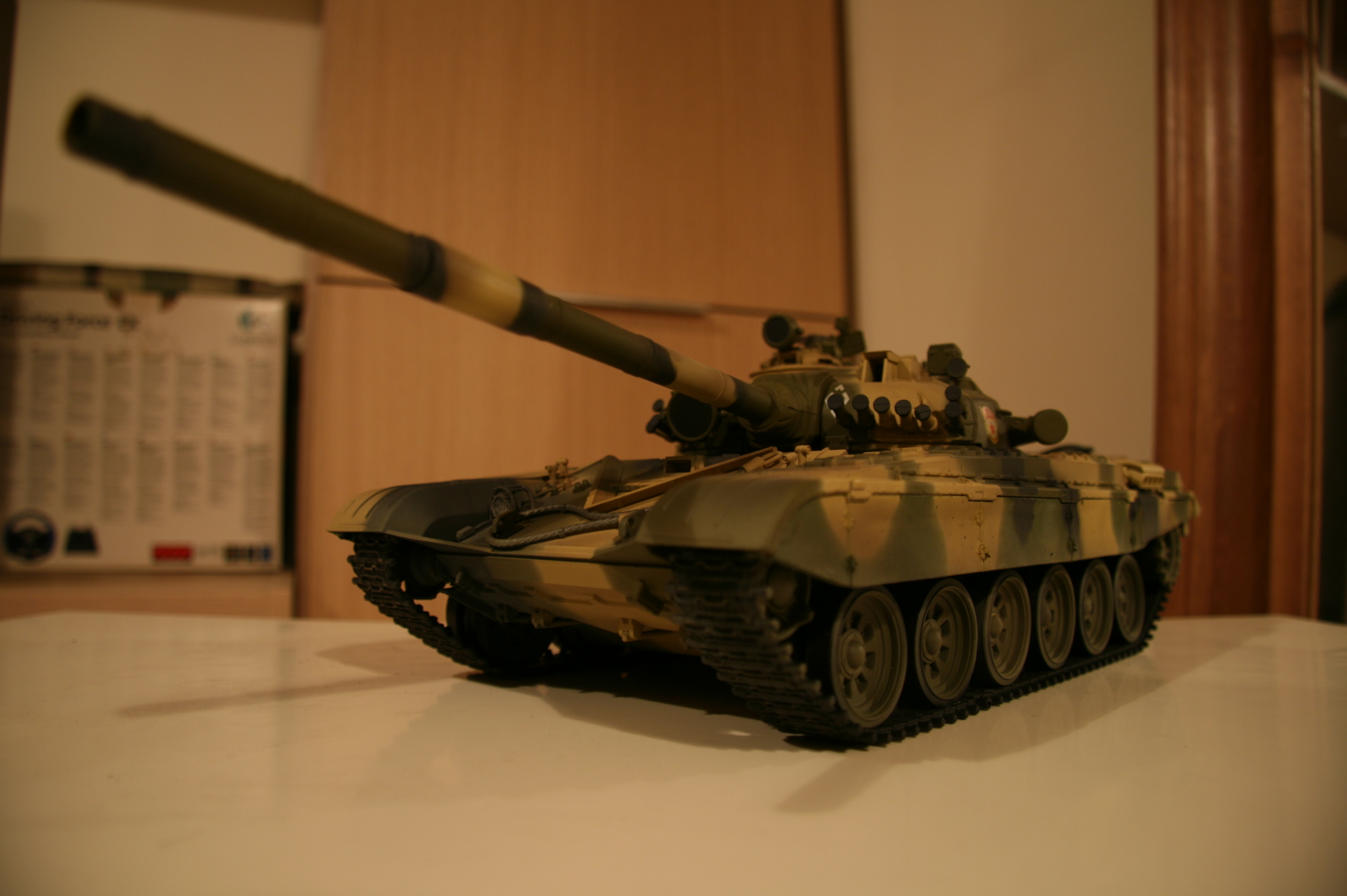

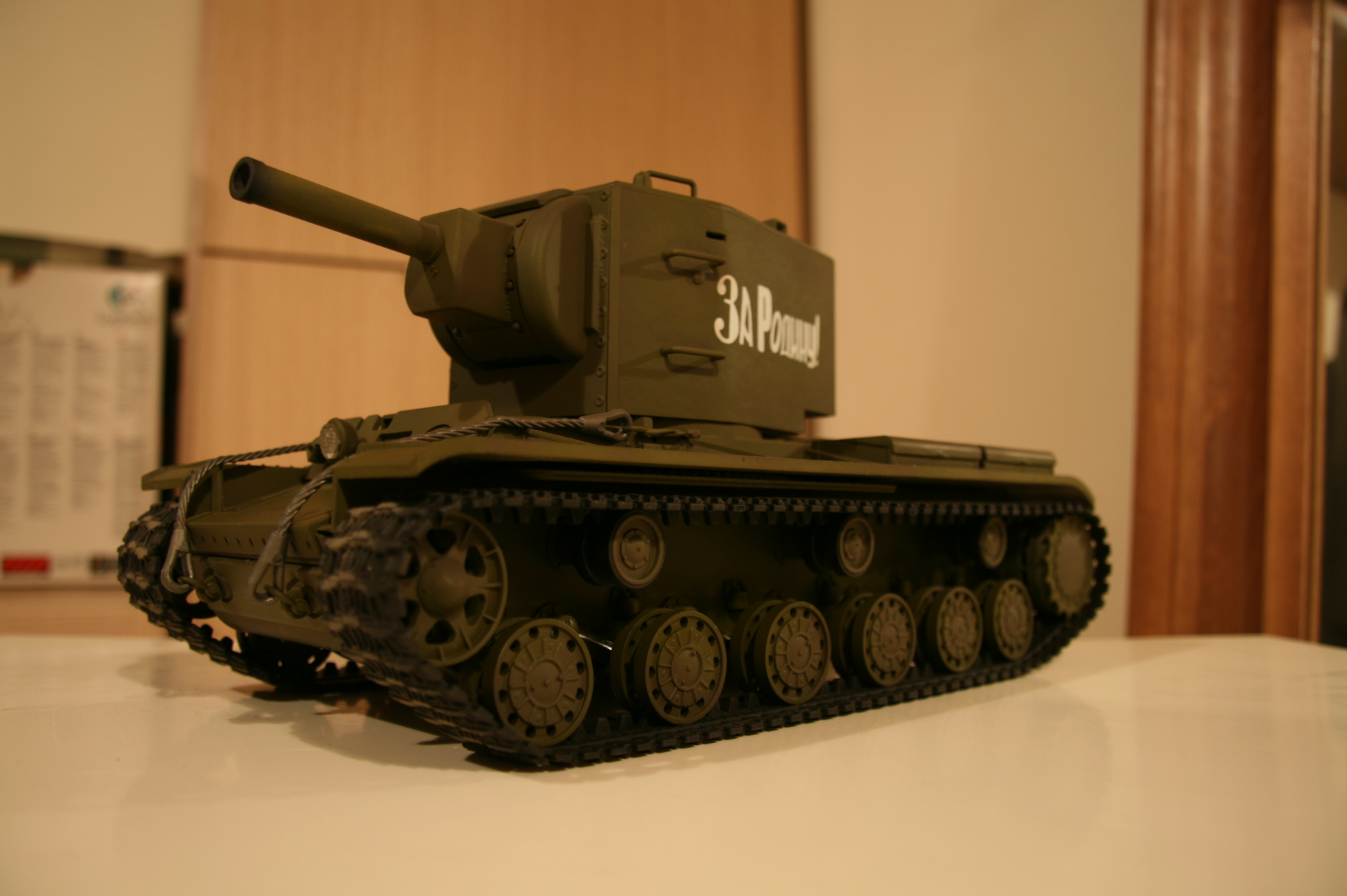

Old 08-25-2009 | 08:30 AM
Joined: Jun 2009
Posts: 28
From: , CHINA
Now both tanks look great! They show the strong feeling of very very heavy with all wheels touching ground solidly.

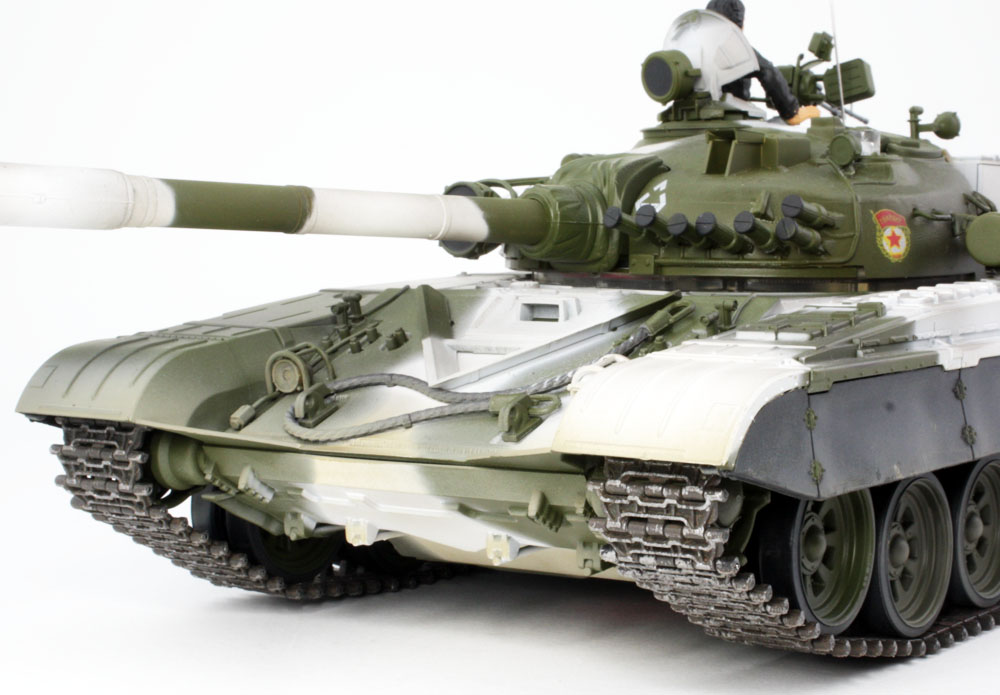

Old 02-03-2011 | 02:30 PM
Joined: Jan 2011
Posts: 2
From: Glasgow, UNITED KINGDOM
Brilliant mod Type99! I've just bought my first vstank (T-72) and it's currently stripped down, mid mod.
If you don't mind me adding a few extra additions, I notice that after sawing the parts off, I notice that the tension of the springs would 'pull' the suspension arms, forcing the front and rear wheels to 'move down' when the tank isn't under load.
To rectify this, I wanted to fit a sort of stopper postioned just above wher the part that was sawn off used to be.
So using a 2mm drill in a dremel rotary tool, I drilled at 90deg to the fixing screw into the plastic collars and the suspension arms.
Then I fitted a small 2mm bolt into these holes which sits just proud of the collar (I'm going to post photos to illustrate all of this).
I'm now going to build some layers of plasticard which will be superglued to the inside of the hull just underneath these bolts. When the plasticard is built up to the correct height and the bolt is resting against it under spring tension, all wheels should sit perfectly level whether the tank is under load or not.
Old 02-04-2011 | 02:05 AM
Joined: Dec 2008
Posts: 192
From: Leeds, UNITED KINGDOM
VS Tank fashion the wheels and suspension this way so as to make them neutral steer easier. With all wheels on the ground there is more resistance and load on the gears. The easiest and most realistic way I've found to deal with this is to just soften the suspension springs on all but the first and last road wheels. This way you get great looking realistic suspension movement while the tank sits at the correct height with all wheels touching the ground.
