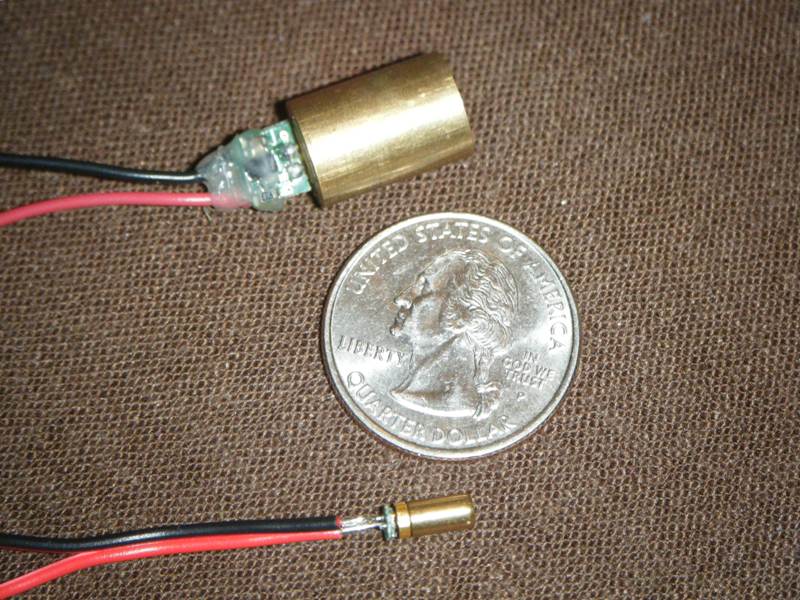

I just wanted to pass this along in case anyone is looking to add a laser to your tank to help aim your airsoft, or I guess IR too. I've bought three from this guy over the past year, and the larger one worked great in my HL Tiger. Recently my nephew asked me to put one in his Bulldog and the mantlet didn't look like it had enough room inside to move freely with the laser installed, so I picked up one of the smaller units... wow - the picture in his auction didn't really do it justice. This thing is small and would probably fit well into a 1/24 scale tank very easily. Should go into the Bulldog with no problems! Both operate at 3v [2.5 - 3.3v], so swapping it out with the HL machine gun LED provides sufficient power, and gives a nice effect of a pulsing laser when you push the machine gun fire button with no other modifications needed. Works great!
http://cgi.ebay.com/ws/eBayISAPI.dll...=STRK:MEWNX:IT
Almost forgot.. he had it listed for #12 + free shipping. I made an offer of $10 + free shipping and he accepted it

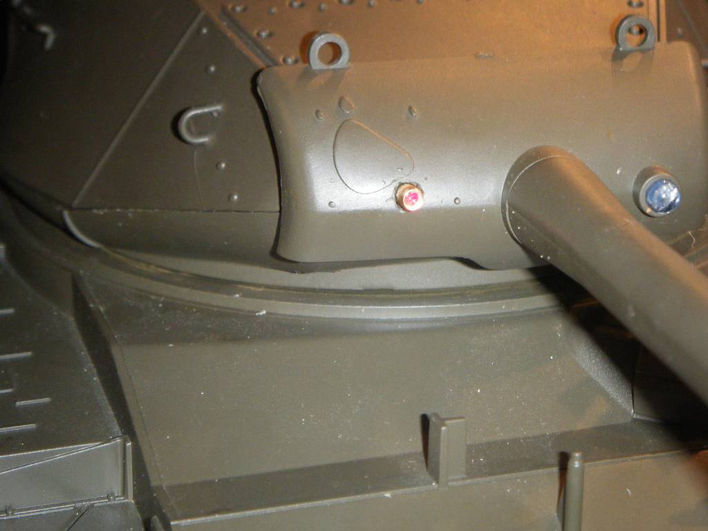

Put the small one in the Bulldog tonight. It fit great in the mantlet so that it can move up and down with the barrel. Remember if you are going to put one in that this will just get you in the area. These guns aren't accurate enough to bother spending the time to try to boresight them at a certain range
I was going to mount it flush, but thought that since it is for a 10 year old and not going for historical accuracy I would leave it out a bit to look like a gun barrel.

Ern, glad to see that it works well and the size looks perfect. However, the laser is where the gunner's sight was. The other side of the gun tube where the LED is right now is where the coax gun should be, assuming you're using the laser to double as a coax gun simulation.
