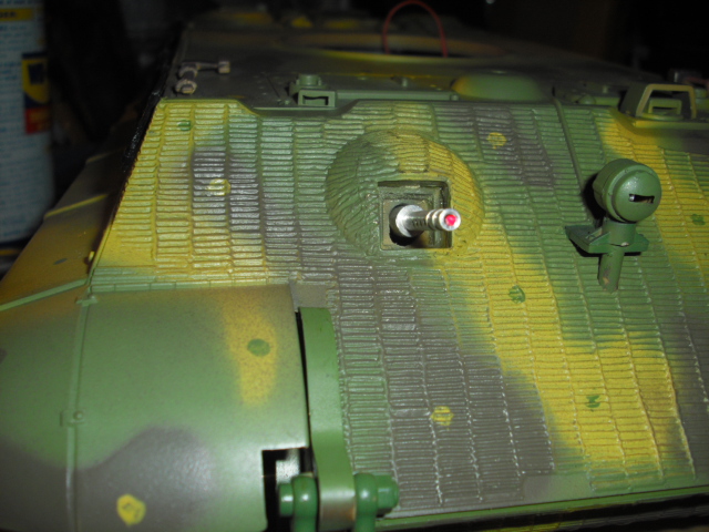

here is the paint job she is going to have!

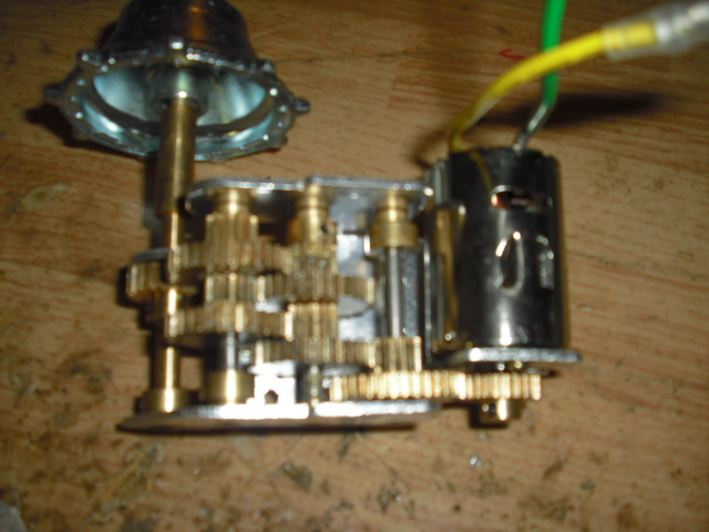

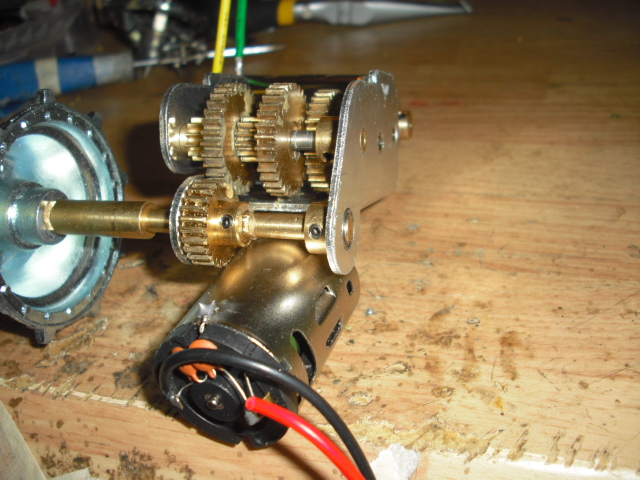

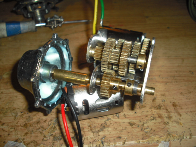

Gotta hit the road today, so I'll be offline! But here are a few pictures that are not olnly teasers but the New 3:1 brass Gearbox from Mato may need some tightening up! Below I show you how the drive axle is loose because not only the last drive gear was loose, but also the coupling that is needed to keep it secure and space correctly to the side brackets!
You will need to alig and re-tighten the allen screws and use a tiny bit of CA (super Glue) to keep them tight! Also for Viper he is getting the Tamyia 380's so this front end needs to be secure!

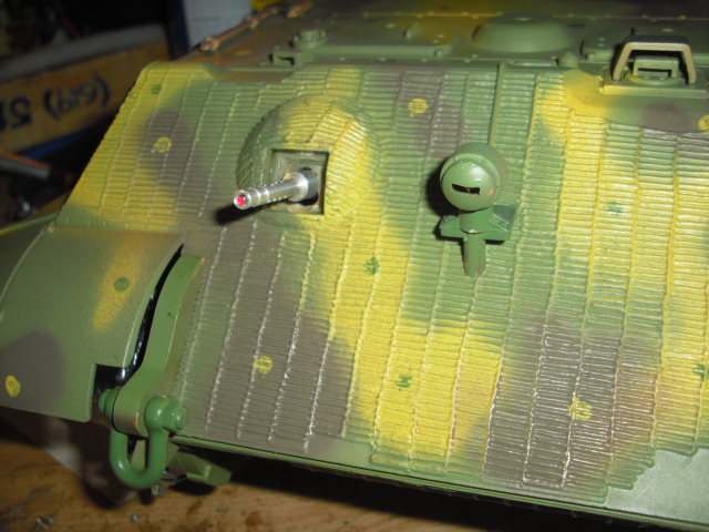

This is the paint scheme that my KT will be painted #222
