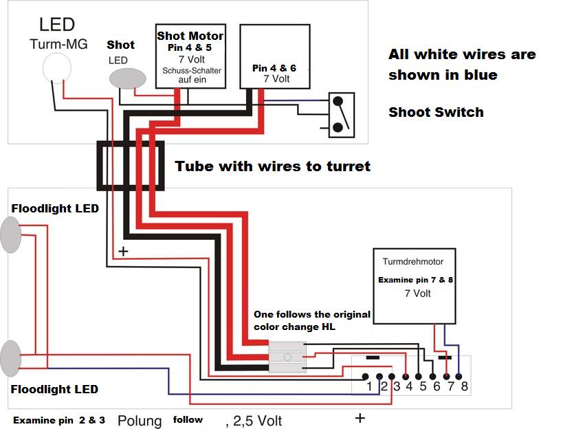

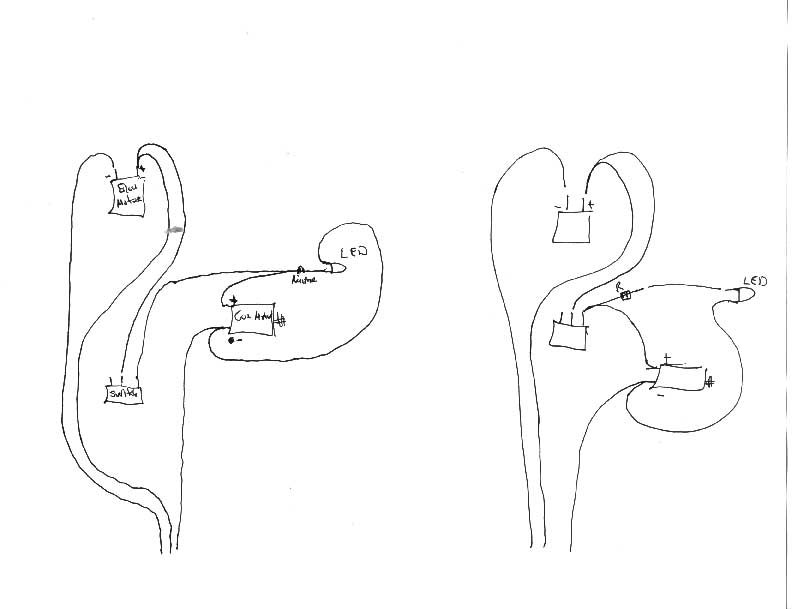

Hey all
I need to know were the red & black wires go for the air soft shot light (LED). MY GUN AND LED ARE NOT WORKING

swathdiver's Avatar
Joined: Mar 2006
Posts: 5,031
From: Port Saint Lucie, FL
Default RE: need help on pershing wiring !!!!!
Which end? Here's my detailed and highly technical turret wiring diagram from several years back:
The writing is in German, but it's not that hard to figure out what is what...
I used an online translator and started converting the writing in the second one.
ID:	1320956   Click image for larger version

Did you check the FAQ? or the search function? If you search, you will probably find a post with pictures. Are you talking about the red light on the mantlet that lights up when you fire the main gun? Alot of people remove this light because real Pershings didnt have a big red light that lit up when they fired [img]{akamaiimageforum}/image/s2.gif[/img] I actually painted over it when I painted my Pershing.
I know that there was no big red light on mantle,___What I didn't. say, was that i moved it to the mantle machine gun position, so I could eventualy use it for flashing machine gun. But want hook it up like the mantle led just to check wiring, this way it will light up (even though its in a new position MG)
