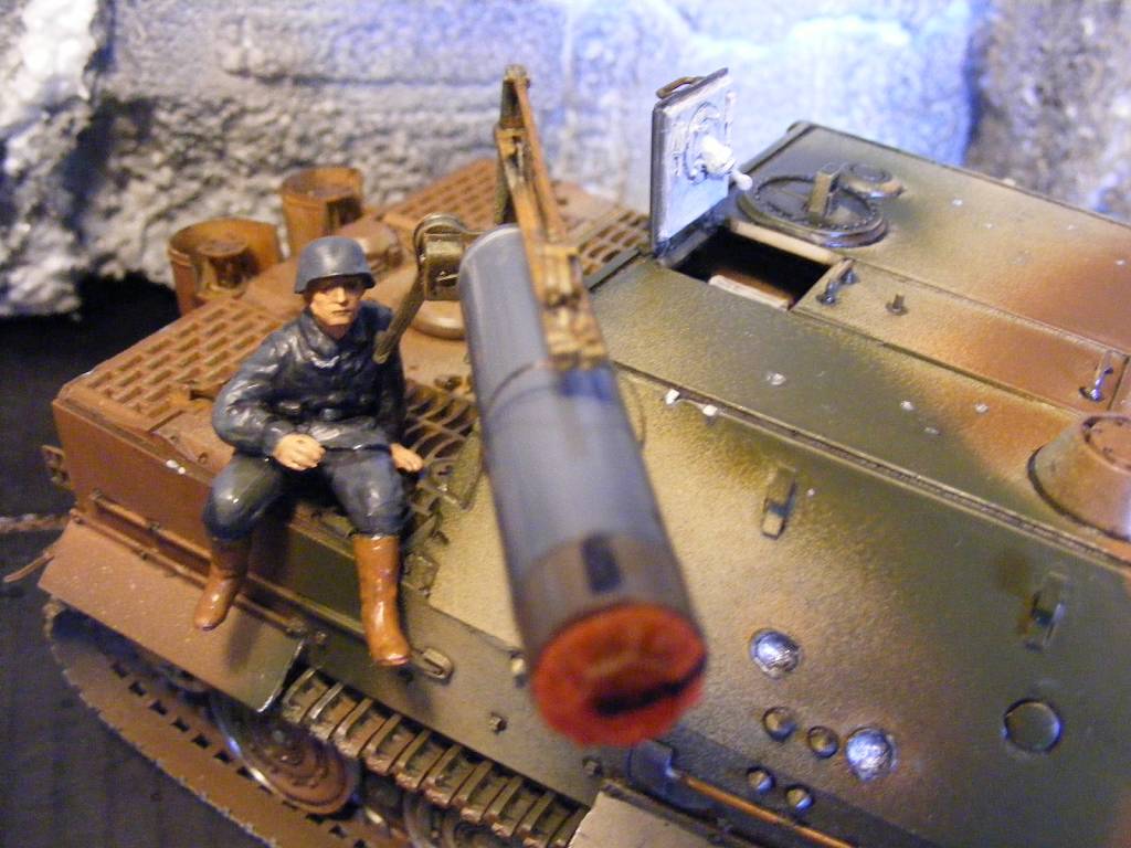

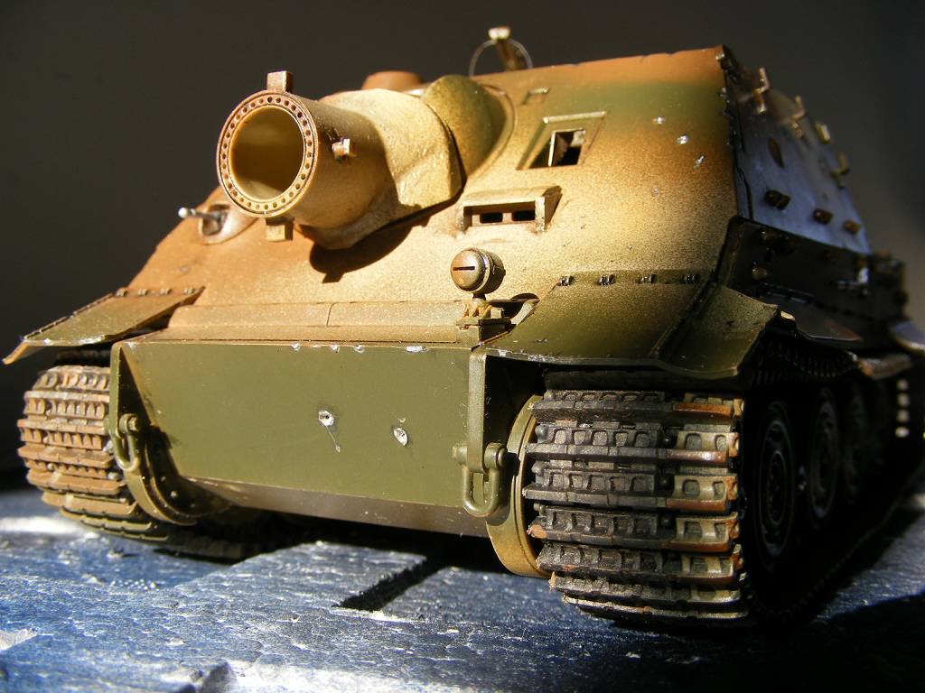

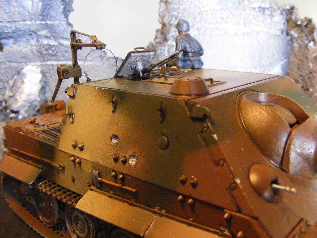

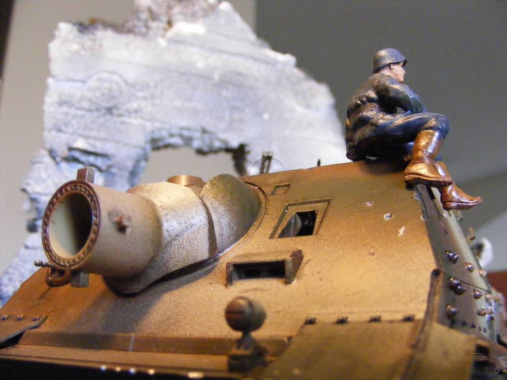

Sturmtiger RC conversion that shoots non-explosive mortar with good impact, instead of tiny light pellets that cannot knock out anything.

It does a good job at decapitating that Sherman. What are you using as the projectile?

Only a cheap toy gun ammo with a strong spring.

Nice job , one the first Stumtiger that i've seen shoot and knock out the enemy's tank! can you tell me how u made your torsional bars suspension. thanks Wayne

Use a slow moving drill to drill thru the axle. To secure the piano wire inside the axle, I bend 3 mm of the tip of the outer end of wire and anchor it into the axle . After secured with glue, and put into position inside tank, I bend the other end so that the bent wire rest on the inside of the opposite side of the tank. It is easily seen from the photo in the video.

DIFFERENT TANK HAS DIFFERENT ROADWHEELS SETUP. The above ' Piano wire method ' can be modified to suit different tanks .

Ok thanks,piano wire and glue,and pieces of plastic to hold it in place opposite the road wheel i'm guessing? I'LL HAVE THE SAME ROAD WHEEL SET UP,it to is a Strumtiger
