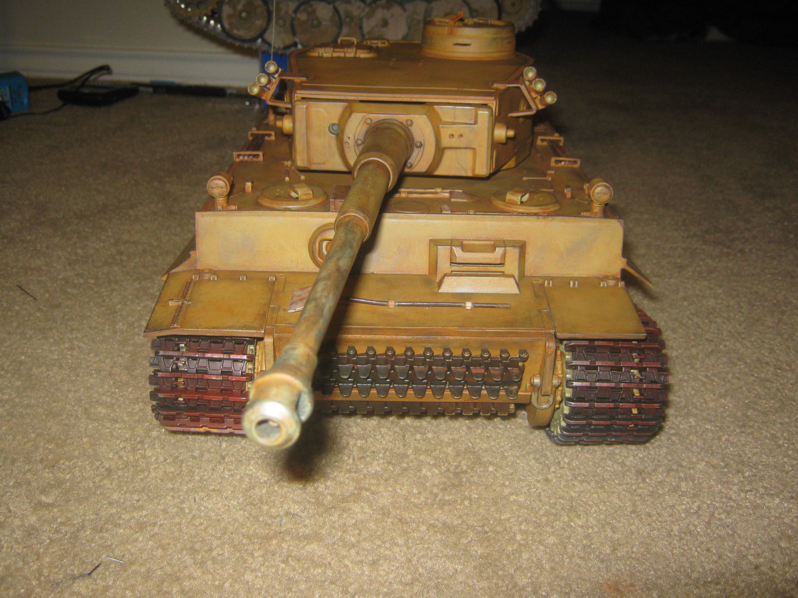

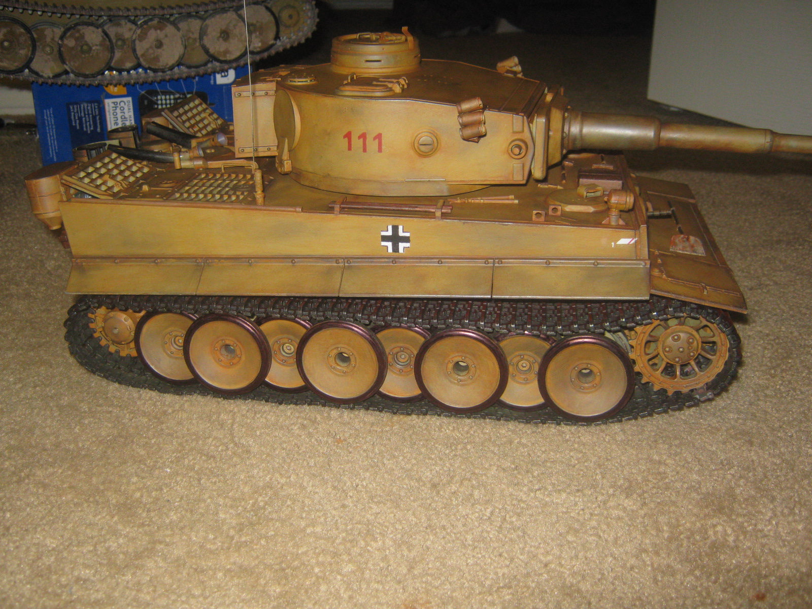

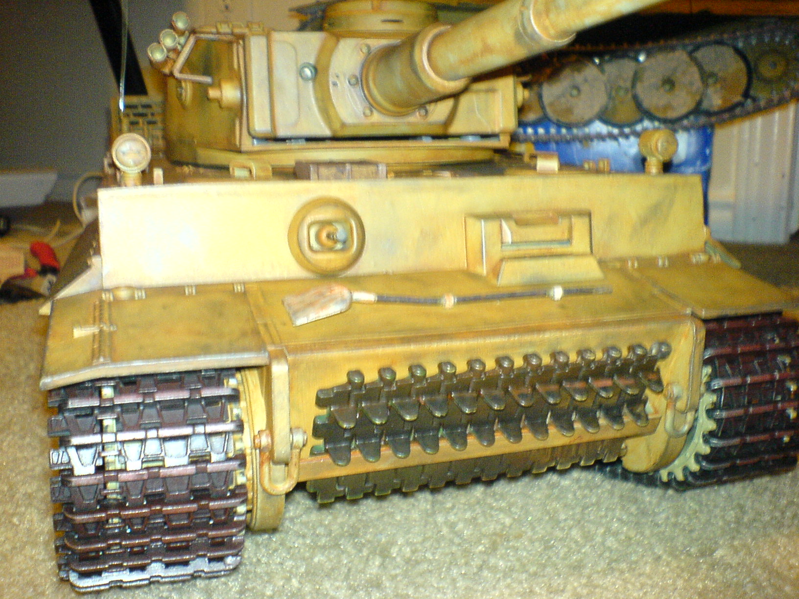

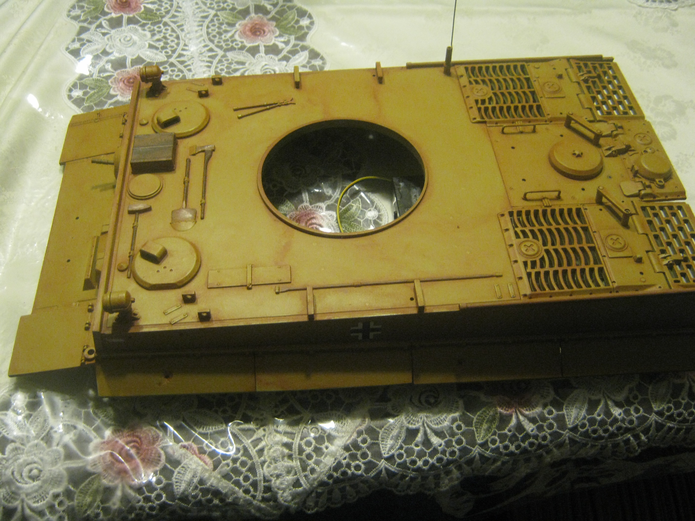

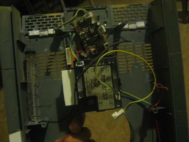

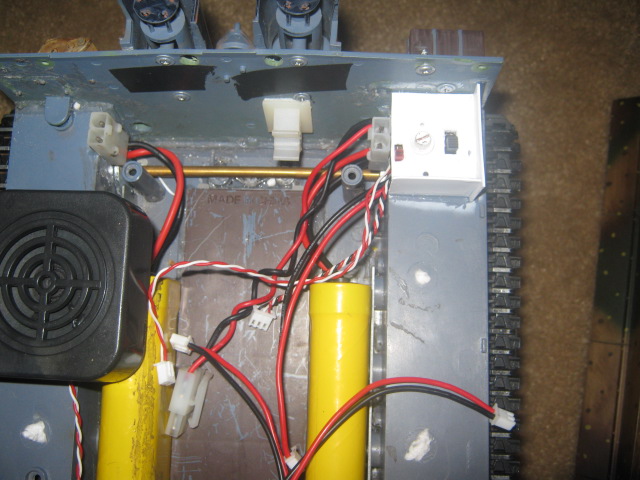

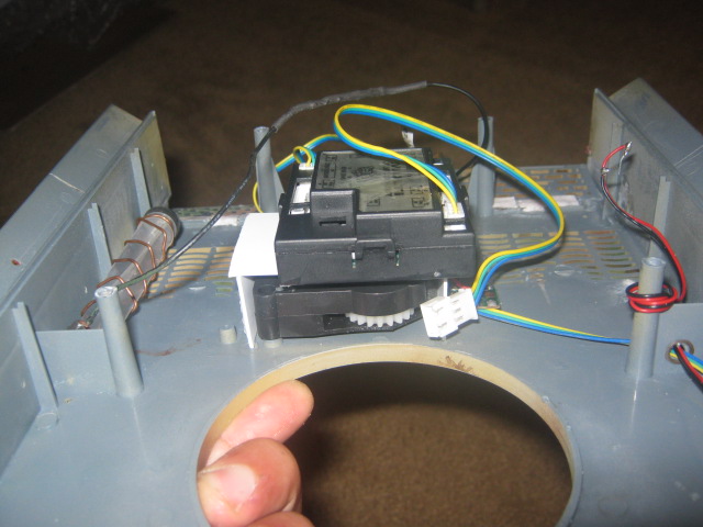

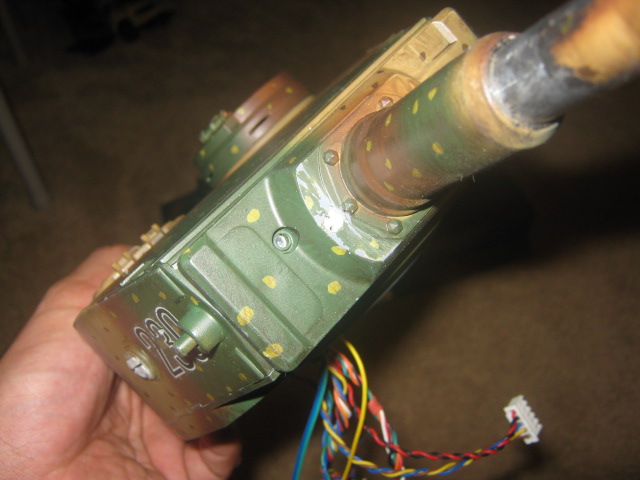

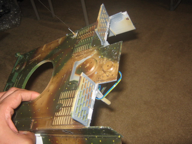

hi guys.. got this tiger from evilbay from one of our member here... got it in pretty good shape..
added front fender and side fender..
removed the battery container
made the two rear engine hatch functional
mode the electronics to the upper hull
move all the switched to the back so that it cam be access from the functional engine hatch.
fixed the suspension arms like the asiatam metal hull.
and more...
cant get the final paint yet. was thinking of another tunesian tiger tank (141 or 111) like my 131 tiger..or battle of the bulge tiger tank with white wash... any suggestions?

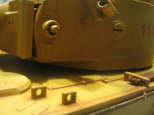

Old 12-30-2009 | 11:03 PM
chinito_03's Avatar
Joined: Mar 2009
Posts: 432
From: -, TX
Default RE: tiger WIP

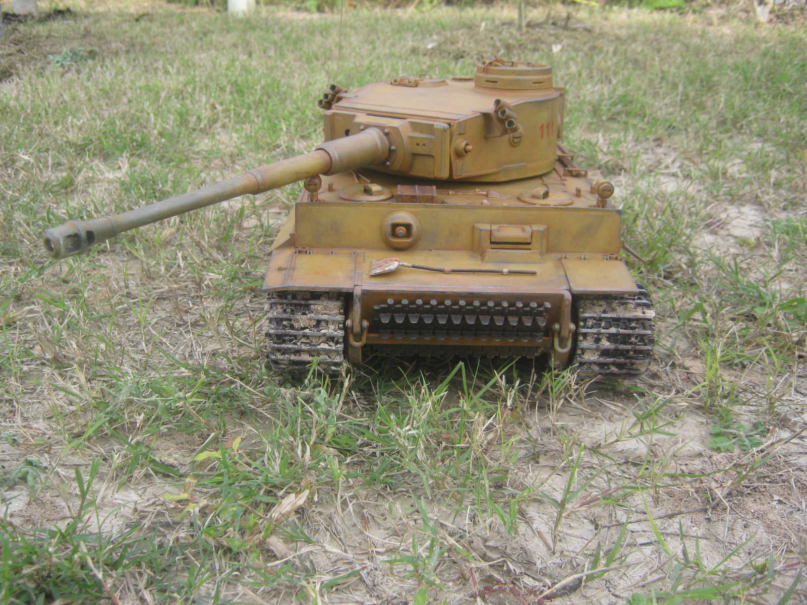

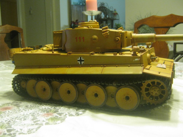

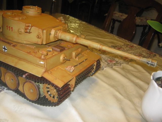

almost done..
just wating for the lower hull's paint to dry.

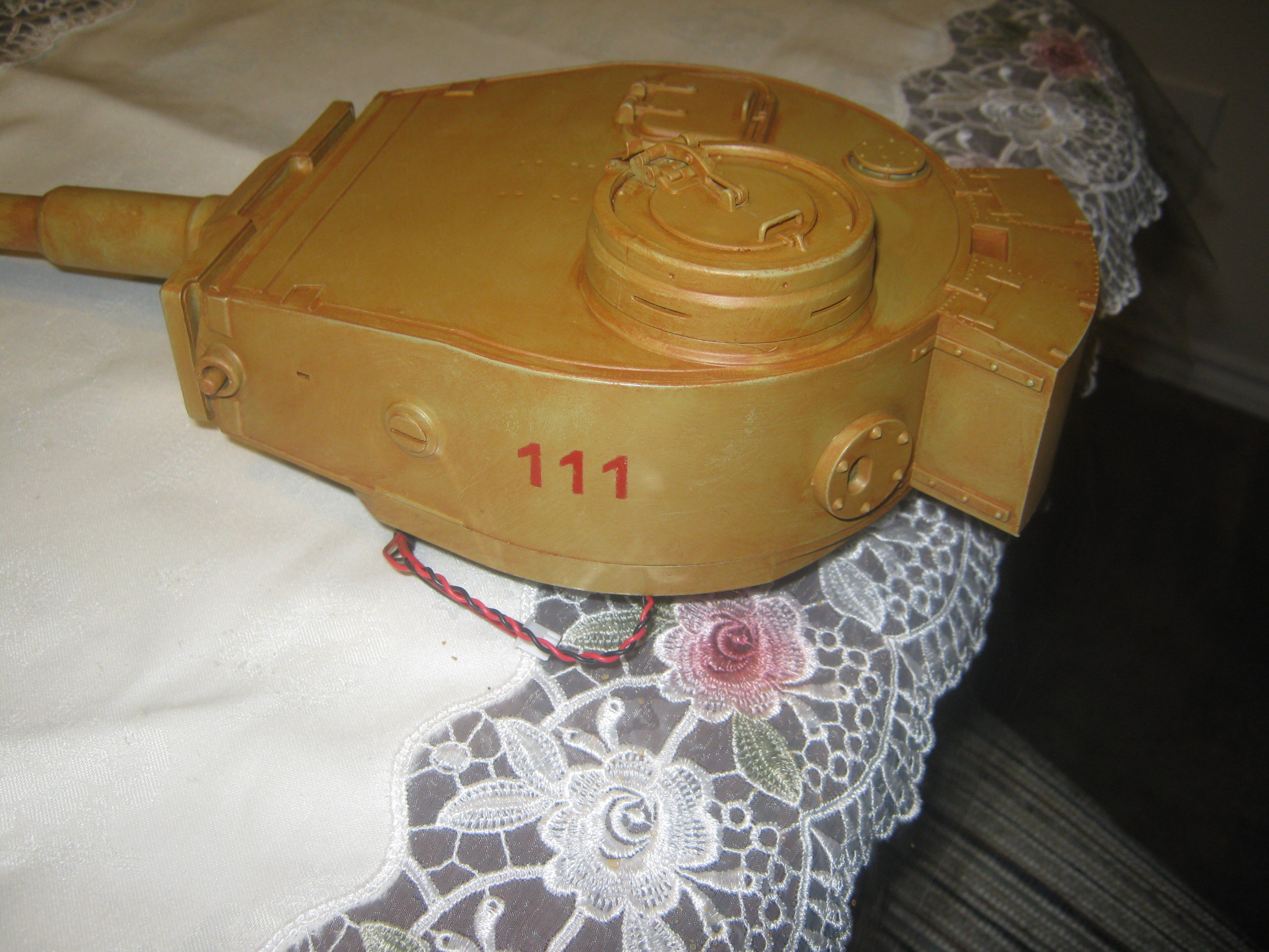

Old 01-01-2010 | 11:26 PM
chinito_03's Avatar
Joined: Mar 2009
Posts: 432
From: -, TX

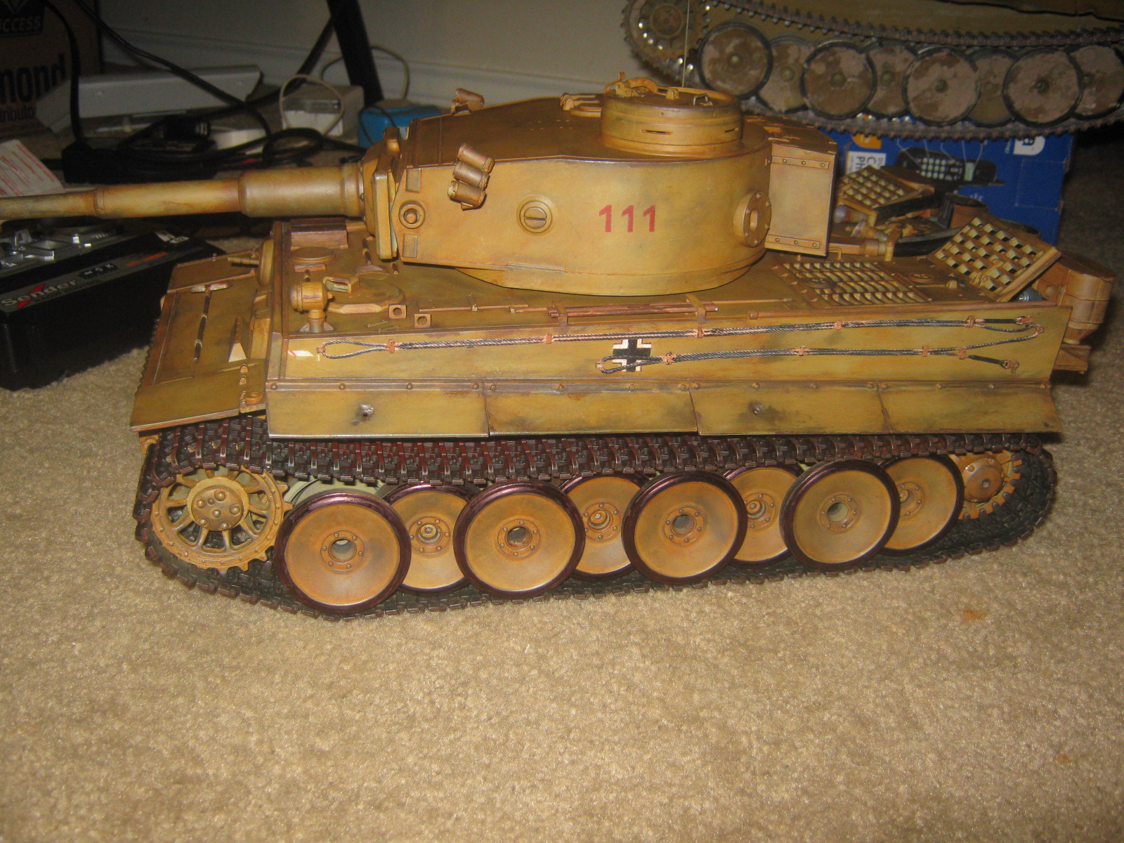

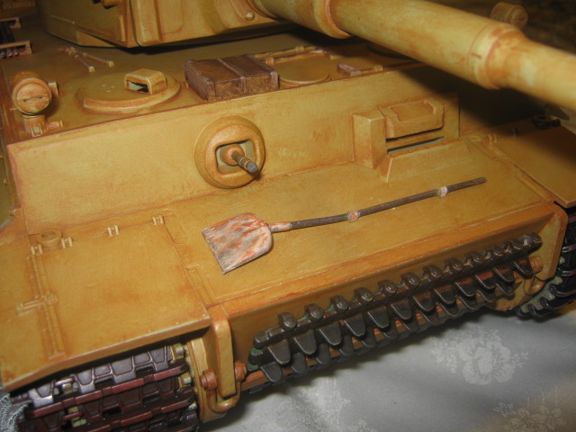

done with the wash... now have to figure out the weathering style....
no ready made decals are used... all painted.. samething with my other tanks.. =)

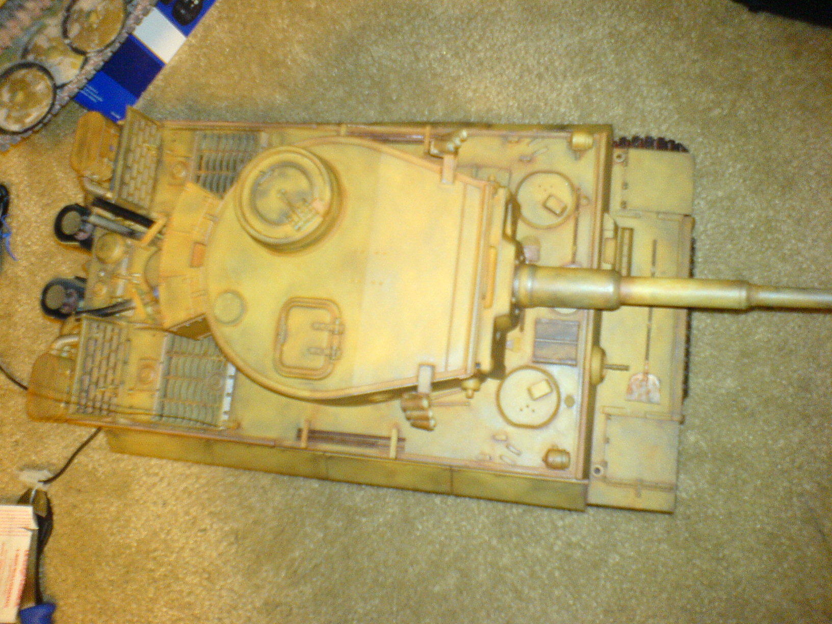

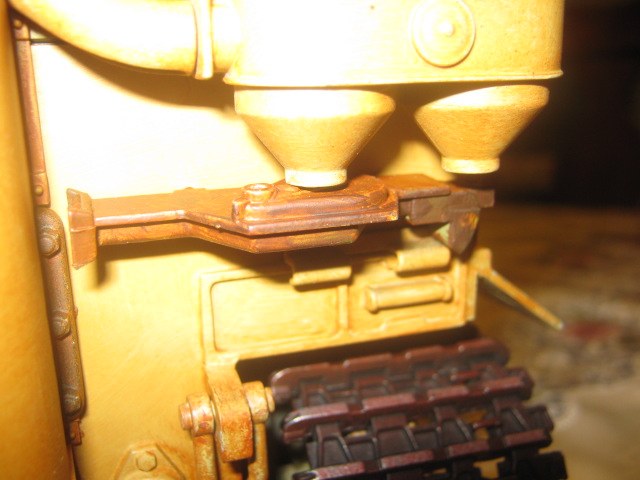

Old 01-03-2010 | 12:16 AM
chinito_03's Avatar
Joined: Mar 2009
Posts: 432
From: -, TX

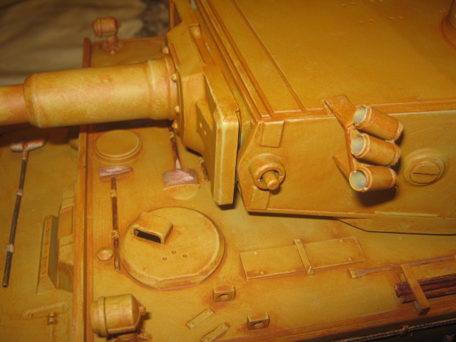

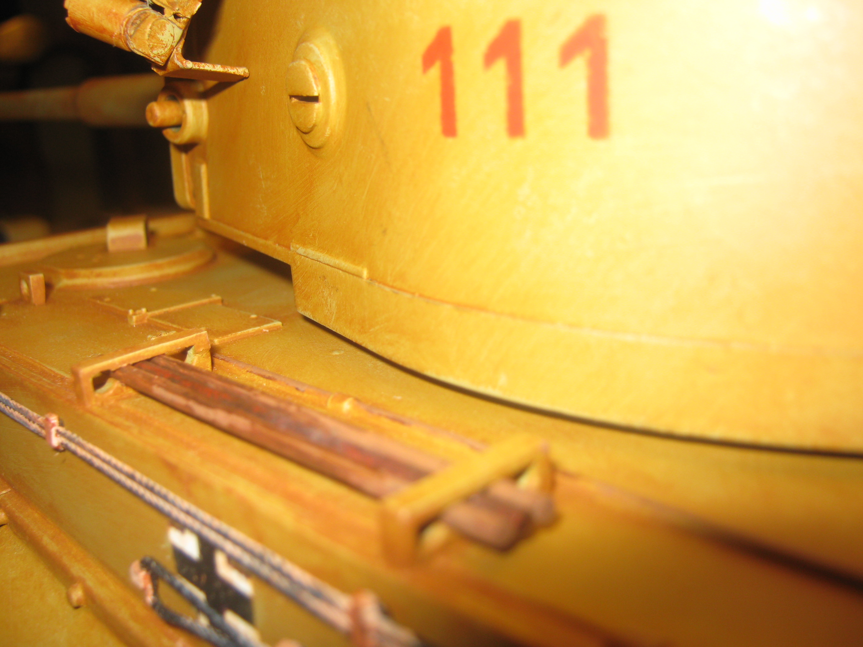

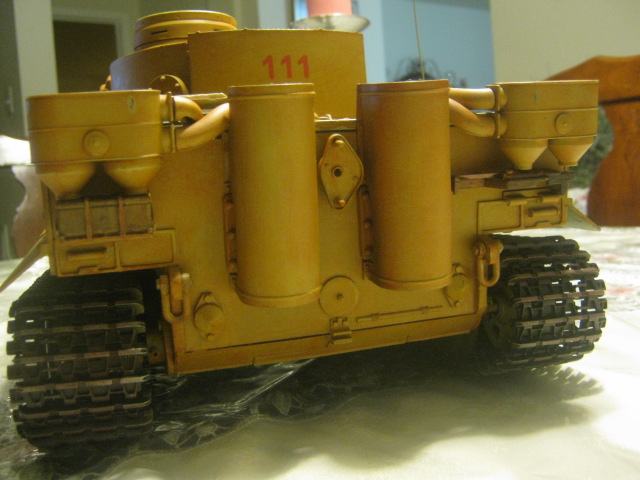

i guess am done.. hehehehehe
brshed it with a grey powder....

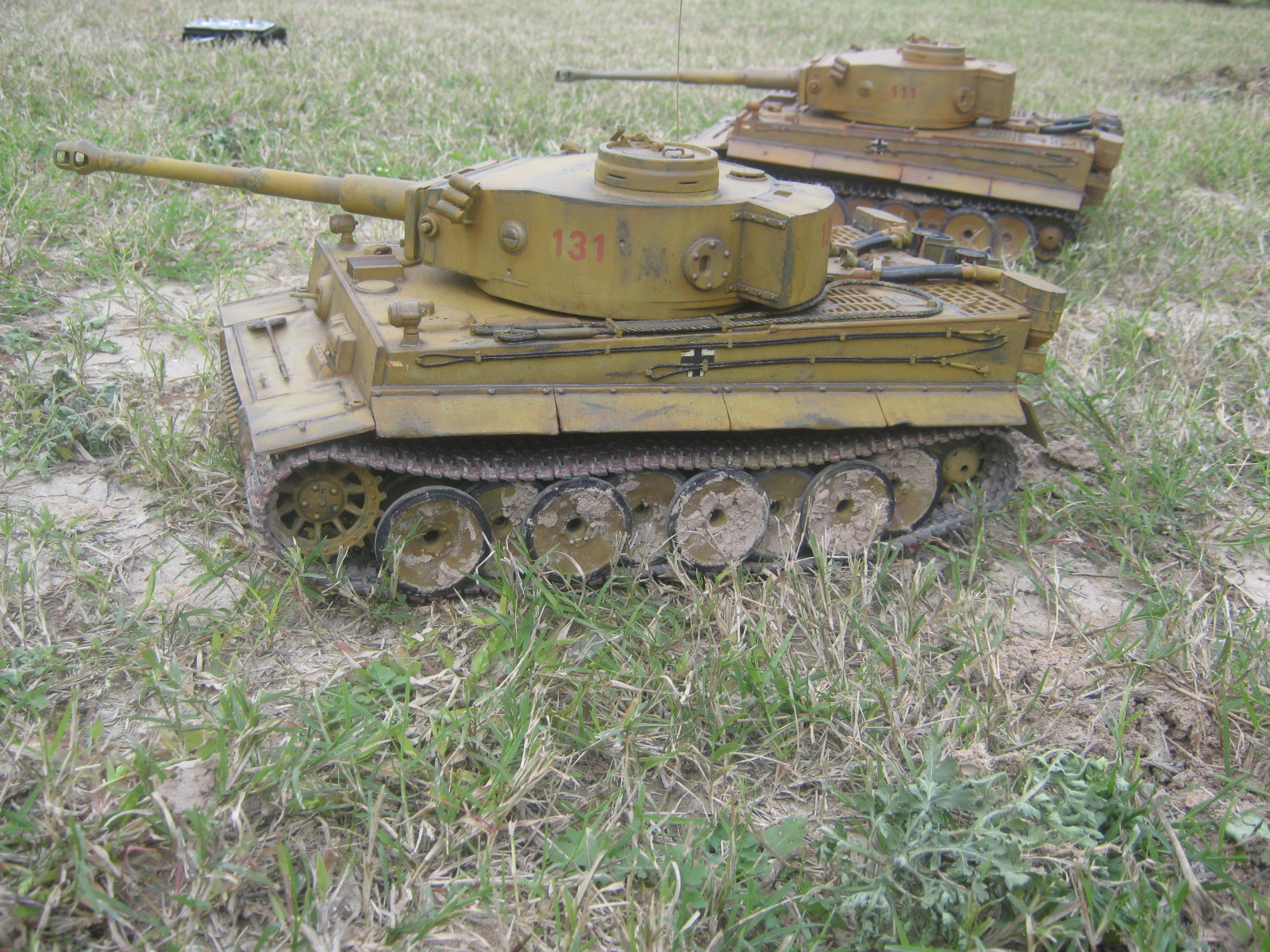

thanks don.. heres the 131 and much clear pic of the tanks
daryl

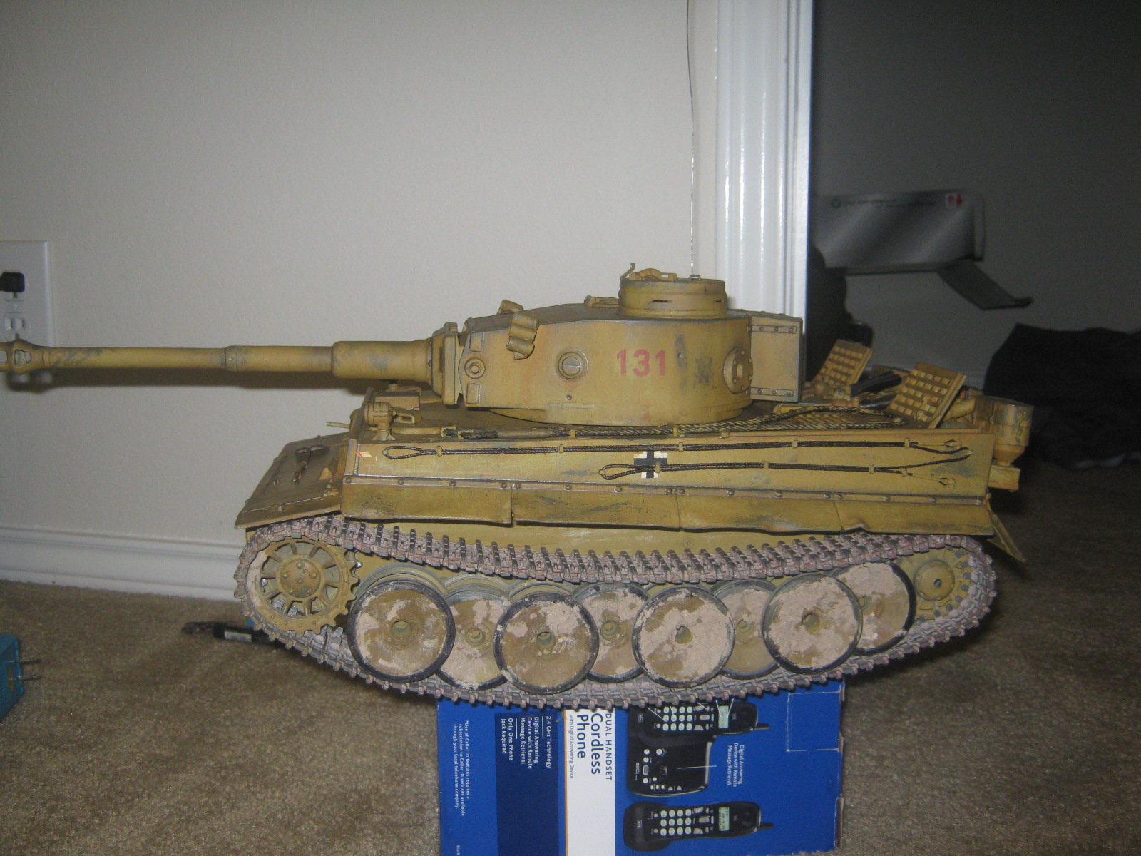

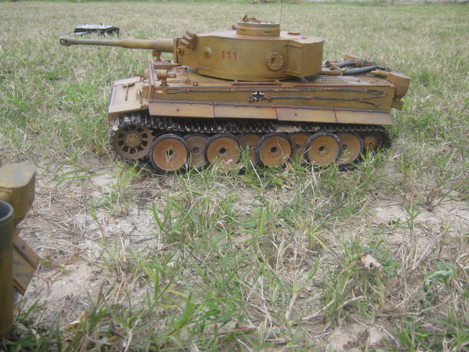

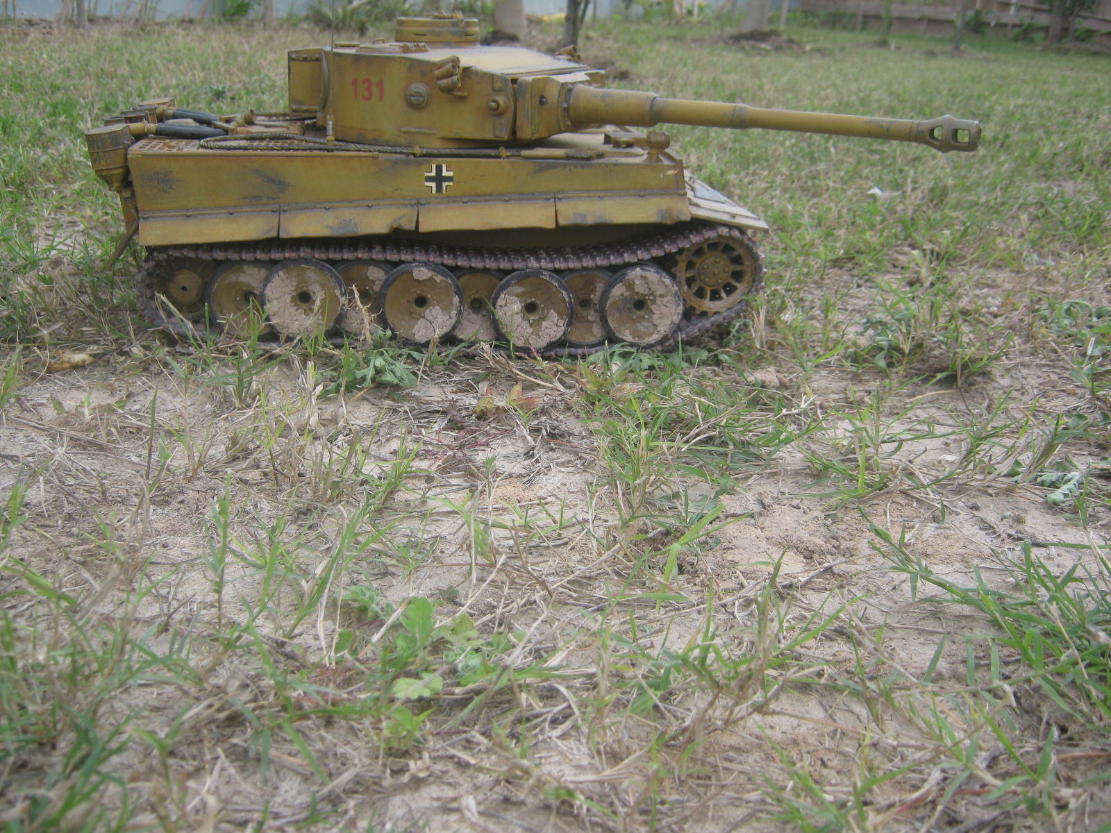

Old 01-04-2010 | 06:24 PM
chinito_03's Avatar
Joined: Mar 2009
Posts: 432
From: -, TX

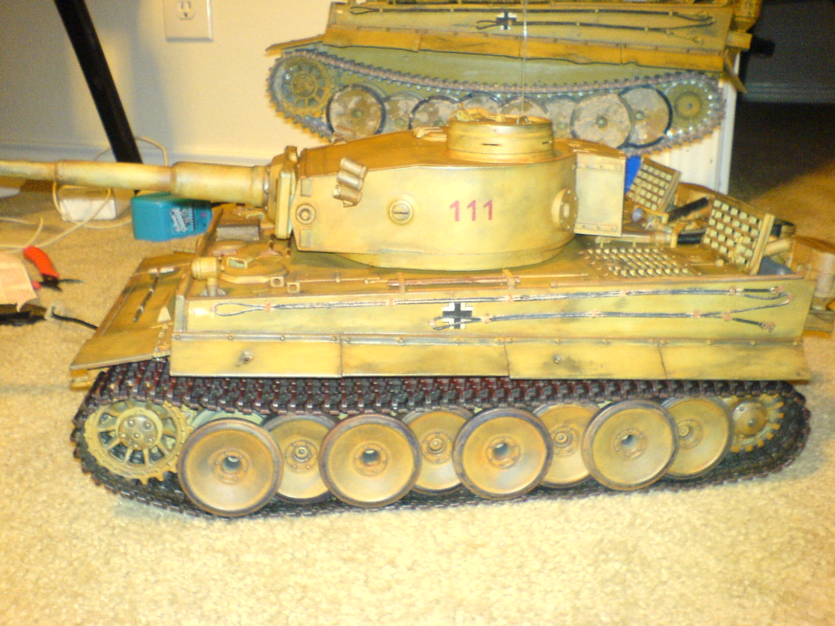

just read your post don..

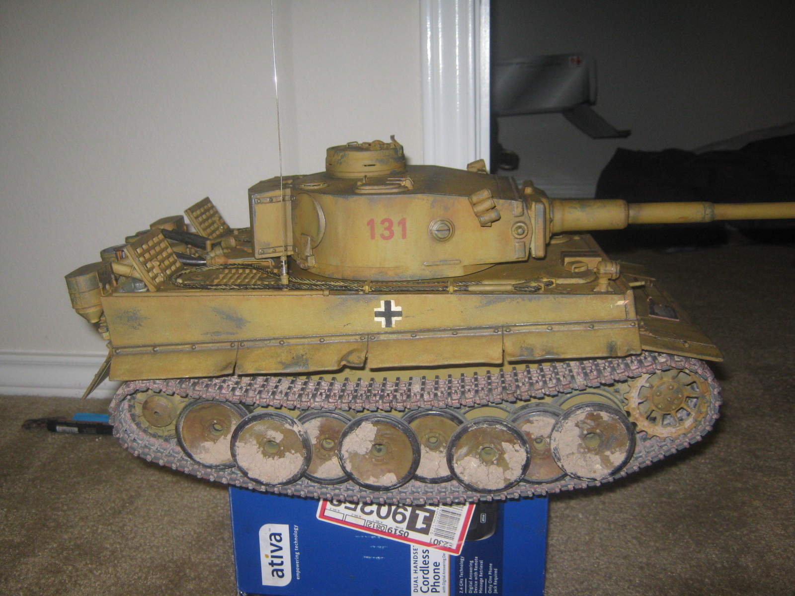

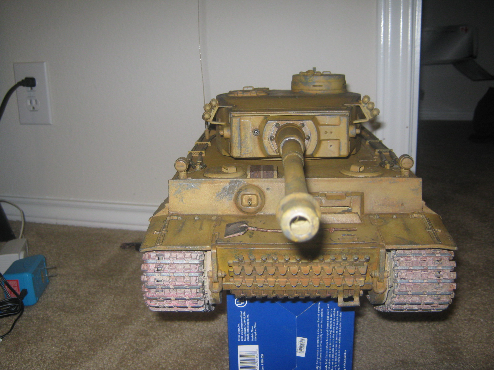

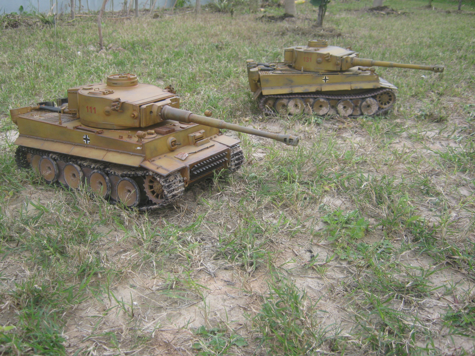

heres the pic i took ysterday
131 has the metal hull and the 111 has the stock hull.. but i modified the suspensions so that it'll be more realistic in height and when its running. copied the metall hull's suspension pattern and the correct height. also installed another homemade metal gearbox reduction. rcc turret is pretty cool also blitz track tensioner noise while the tank is running even thought it doesnt function the same as the metal hull tensioner that swings back and fort... in the end the tensioner is pretty good..
daryl

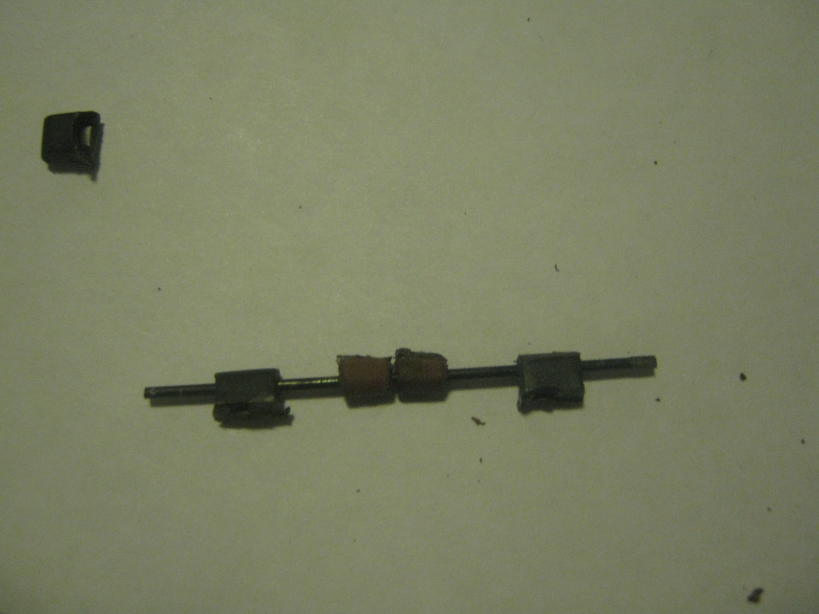

ORIGINAL: CHIEFSONN
Fantastic work on both tigers.. thanks for all the pictures,i picked out a few good things to do with mine.?and if can you tell,or show me how you made the hinges to open and close the engine grills then i would be able to finish mine.thank you chinito_03. good job on the tanks again.
thanks chief,

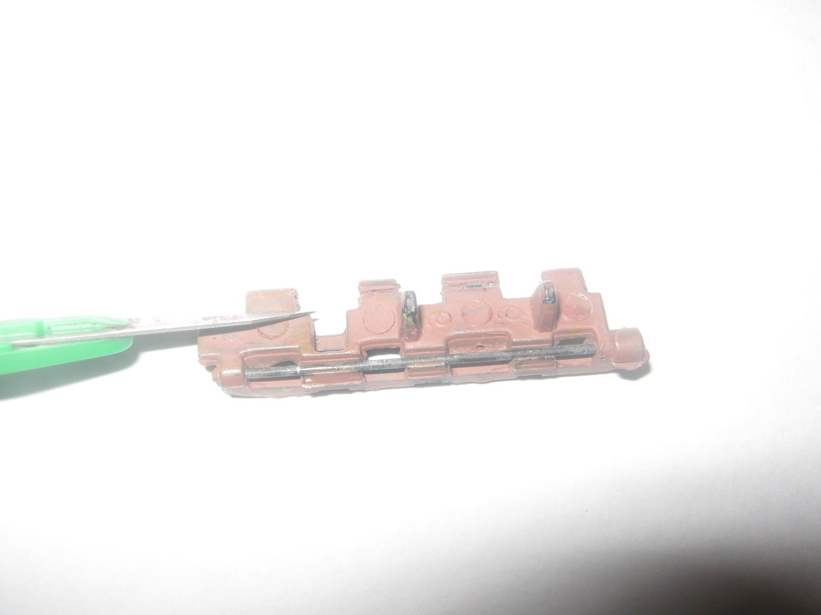

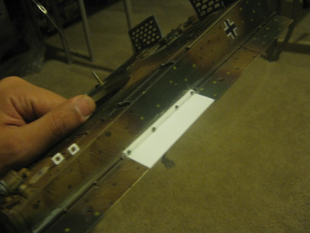

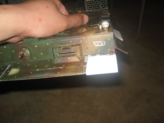

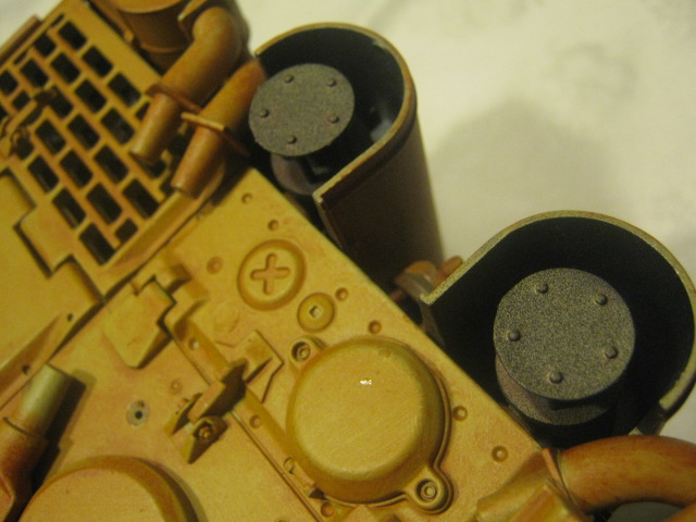

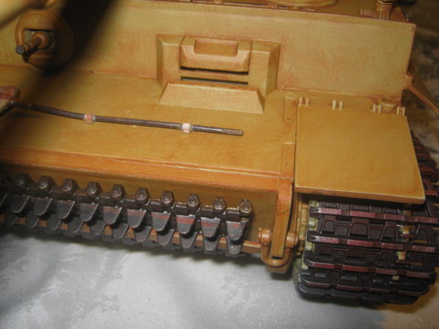

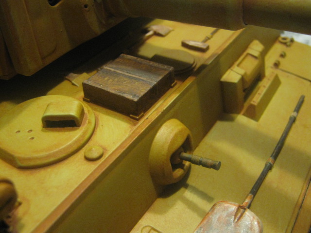

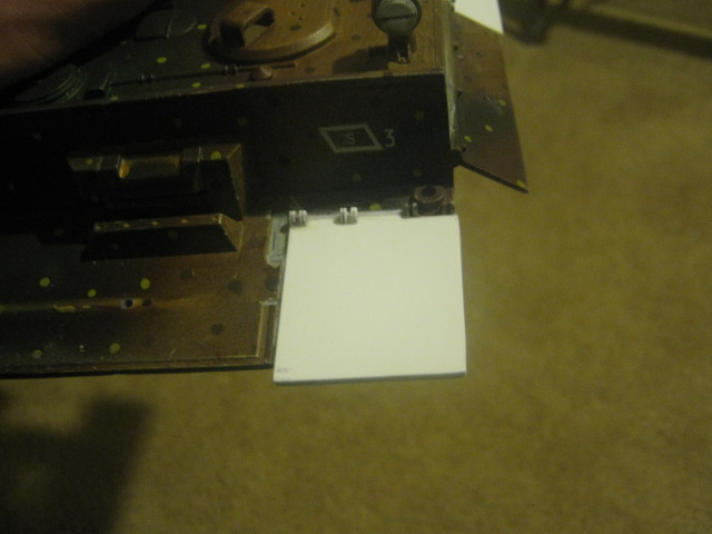

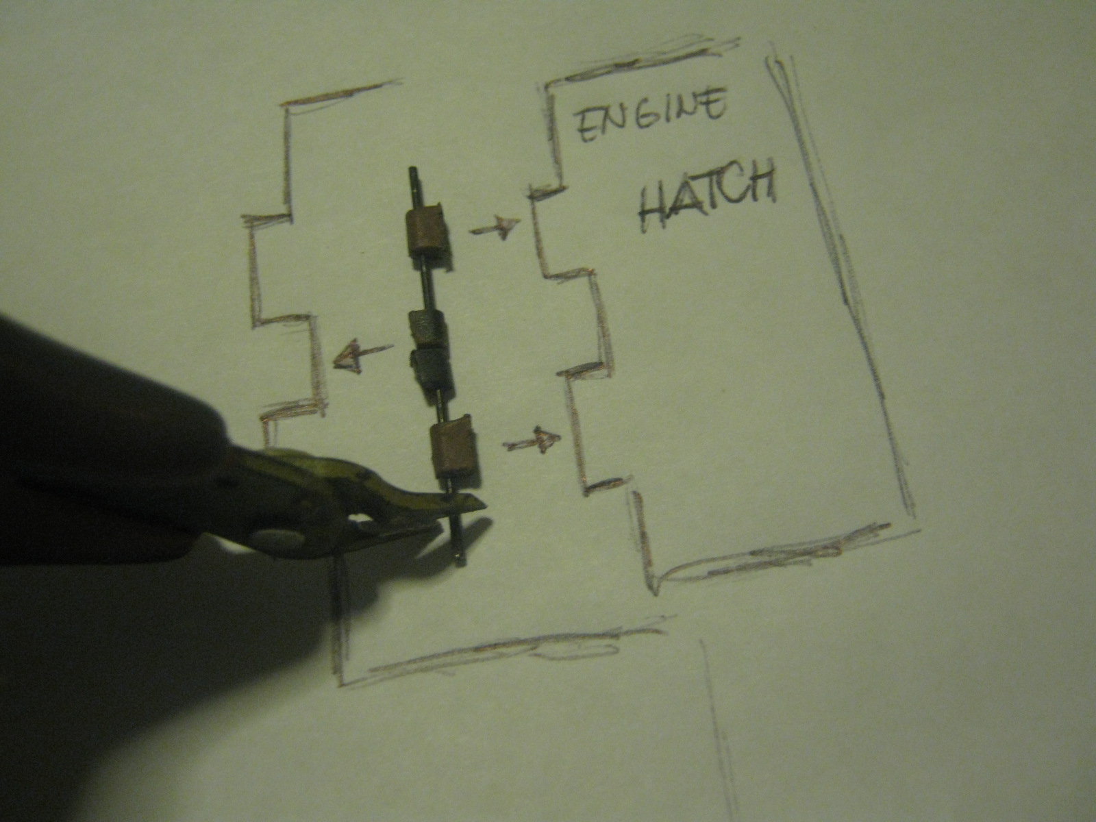

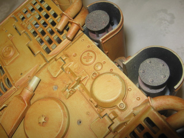

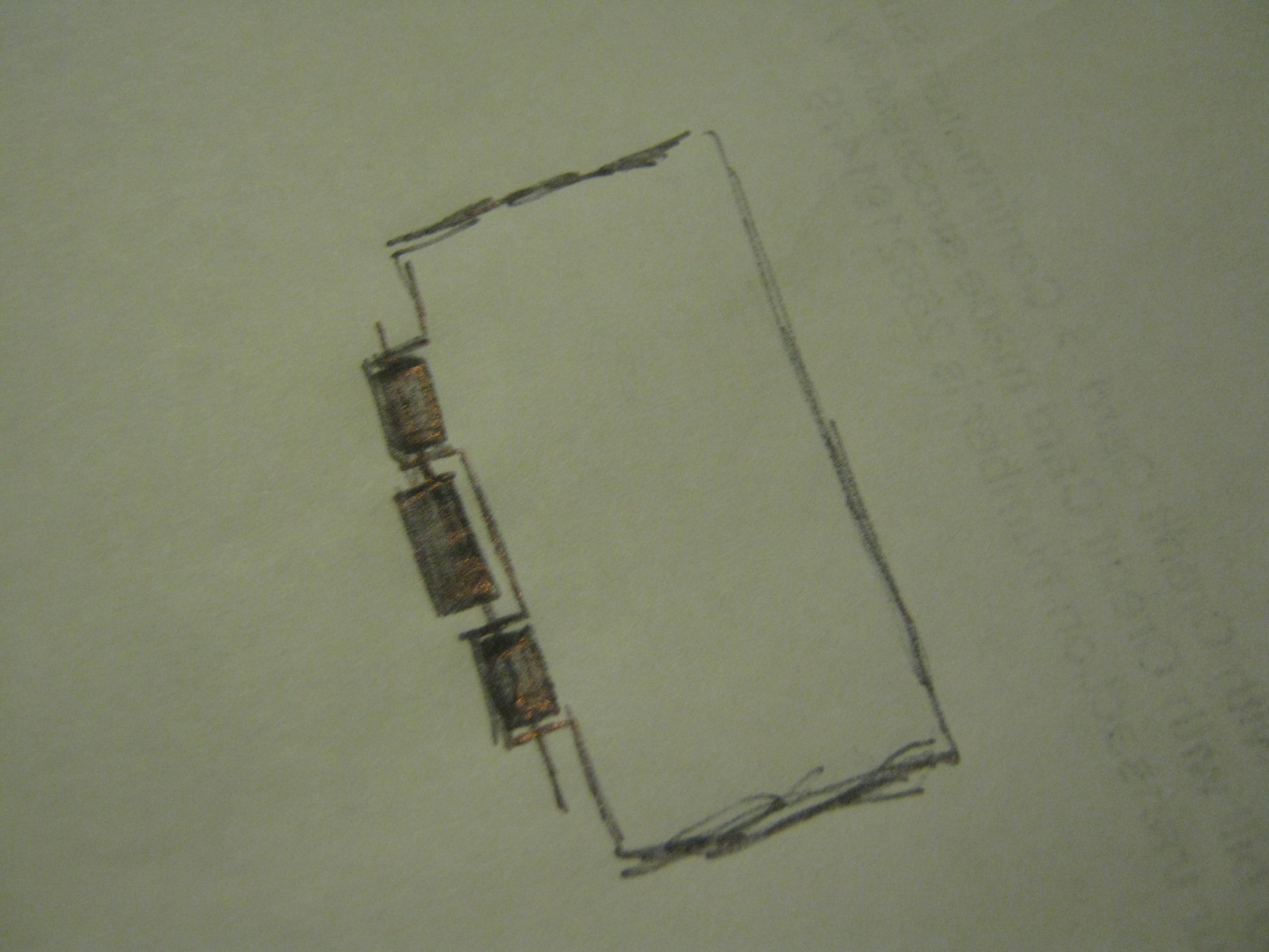

heres the step by step in how i made my engine hatch functional.
1. youll need 1 or 2 track links
2. cutter/hobby knife/scalpel 10 (i used scalpel 10)
3. few pieces of styrene sheet
4. glue
5. san paper.
now use the cutter or knife to separate the hatch from the hull.. follow the seam line it might take a while to cut it.. do it slowly because you might cut yourself or ruin the cut.
took m3 about 45 minutes.
once its separated use sand paper to clean the cut line and make a lil angle on the bottom part so that it wont touch or it will creat a few cm space from the hull once you put them together.
now get the track link (SEE PICTURE BELOW)
after putting it together i used a piece of styrene sheet to cover glued part...
daryl
