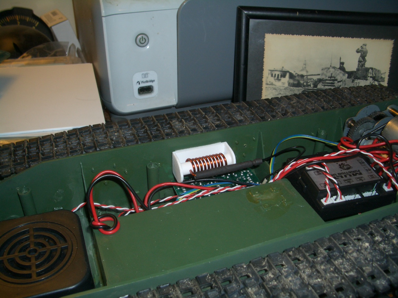

Hello,
I was really impressed with the internal antenna mod that pzrwest (sp?) brought to the board. Here's my implementation of it. I made up ten for my tanks pretty much for free.
The wire is 14 Ga magnet wire. Varnish finish. Cut it to the same length as the HL antenna and wound it around a hollow plastic tube. Glued up the rest and put double sided tape on the back for mounting.
As you can see the wire thickness is ideal for connection to the stock HL connector with no mods and the stock heat shrink can be reused.
Range is the same as the stock HL antenna and now I mostly cover the big eyesore rivet hole on the decks of my tanks.
Perry

Thanks Perry, although I always thought that the antenna had to be extended and a certain length to pick up the radio waves, if your idea works then I must be thinking too old school or something.

Hey Armchair,
Not my idea here, mostly dumb fiddling on my part. My admittedly unscientific conclusion is that this is equal to the standard HL antenna. Usually old ideas are good ideas so your probably right but this gets us close enough.

I use the wire that comes in the crappy HL battery chargers. There's enough in there to make it 1/4 wavelength.

Nice execution on this idea. I've had mixed results with these internal antennas. Some work, some don't, which is really strange as I build them all the same. None of them look as good as your example though. Maybe the thicker wire is the answer.

As mentioned before, magnet wire is just high conductivity copper wire with a baked on varnish insulator. I use it for home made alternators in my wind turbines. 14 Ga is pretty thick but thinner Ga could be used, it just won't hook to the stock connector as well.
I bet you could take apart the stock charger (who uses them anyway) and find some in the transformer in there.
I have noticed that they can be finicky as some have stated. That is why I use the double sided tape on the back. It allows me to 'tune' its operation by putting it in different places or orientations. Placement is by trial and error but generally vertical mounting as far from the esc/motors/speaker as possible.
Perry

I tried your approach today of using 14ga magnet wire for the internal antennatoday. I drilled a small hole in a 1/4" dia styrene tube, inserted one end of the wire, and tried to wind it, but the 14ga is tough to bend easily and uniformly. Any tricks to wrapping it around the styrene core? I kinda mangled my first styrene tube core because its just not rigid enough to stand up to wrapping the wire over it.

I just took the stock HL antenna and wound it around a piece of plastic tube and connected the wire to it.  It works great, I'm converting all my tanks over.
Just place it as high as you can and as far away from the internal motors, speakers etc...

I supplied the Hobby Havoc online store with 100 on my HL antenna mod units can't say if they still have them yet. On panzer 3's Iplace my coil on the right side of the hull beside the main board ans works perfectly, on Tiger 1's I placed the coil on the back left side of the back panel with the same results. I got 100yrd line of sight responses
