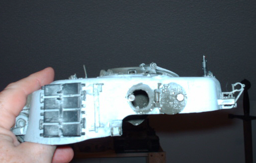

Okay,
First American tank.
So far I have given the turret a coat of Mr. Surfacer. Before it dired I stippled to produce the cast effect. I likethis product as you can add more or reduce the effect as you need by a bit of sandpaper or you scrape it away completely.
Ihave bored out the periscope windows in the cupola. Once painting is completed I will go back and insert bits of clear plastic to replicate the ballisitc glass.
I cut off the barrel at the mantle. I exctended the barrel to pass through the mantel by using an old the large end of a Tiger barrel.
I found this thing I am using for a recoil in box of parts. I don't know what it is or was used for but I have modified it with a micro switch to act as a recoil. Works good!
I made another High Voltage Flash from an old disposable camera. The flash is activated as the barrel begins it's rearward motion. Whenthe barrel returns to the battery position another switch isdepressed that allows the flash to recharge.
A seperate micro switch is attached to the flash unit activation, this second switch trips the cannon sound sound module in sync with the flash unit.
So far so Good!

I made the shell ejection hatch operational.
I pryed the fitting off the turret. Using very small drill bits I drilled out the corners of the the hinges. I also drilled a hole through the hinge to accept the pivot.
With a #11 Blade I scored the plastic until the hatch sperated from the hinge.
A bit of clean up with a file, and Iused a bit of wire to act as a pin.
The purpose of doing this was to provide a placetoputthe switch forthe high voltage flash and sound unit.
To keep the hatch shut I recessed a small area just forward of the opening and CA'd a small Rare Earth magnet.
With a grinding bit in the Dremel, I hollowed out a small depression in the hatch. I changed over to a cut off wheel in the Moto-Tool and cut the tip off of an old Tiger metal axel. This was then CD'd intoplace so that the magnet would catch the hatch and hold it shut.

Nice work...I like the "shell door". Only thing is it looks like the door is too large. Isn't it just the oval part that opens? The rest of the circle is the housing? Maybe not...that's what I've always thought looking at.

Good eye! Yes the small part is the door and the rest is a surround. However I needed it big enough to get my fat finger through so I used the whole thing.
