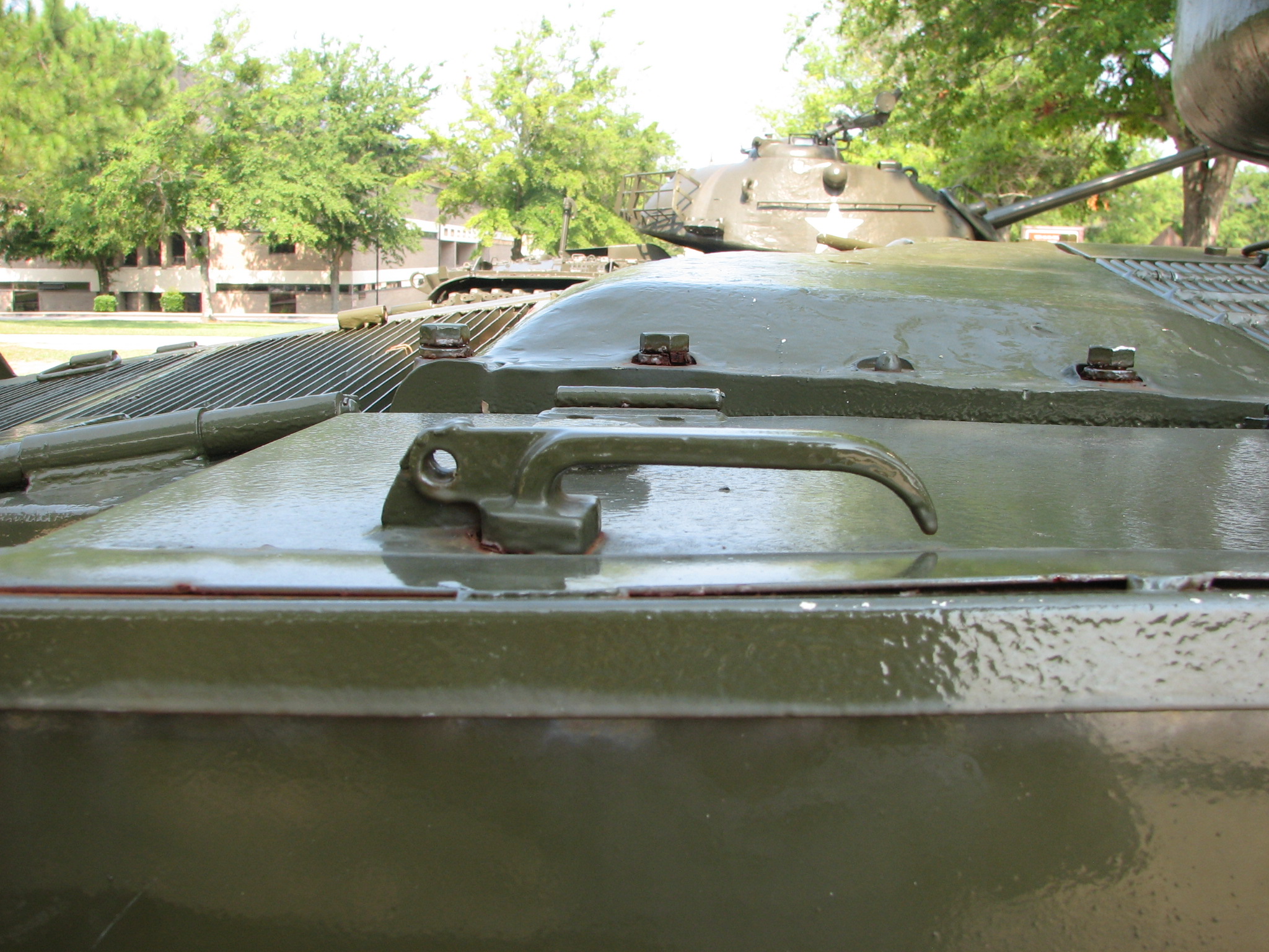

Torsion bars work by the arm twisting the spring steel torsion bar. When the wheel, arm and bar are installed, there are splines on the bars end that lock into the mounting anchor location on the opposit side of the tank.. The arm is installed with the arm pointing almost down. As the tank is lowered, the arm/wheels are forced up into thier proper alignment. The torsion bar provides the spring action as
the wheels and arms want to twist down. The driver bow gunner hatches on the M-26-45-46-47 also use a torsion bar to open. The photo shows an M-26 hatch.....the bar running along in the slot is the torsion bar and the anchor is at the rear of the hatch. When the hatch is installed, it is open, and the torsion bar and anchor are fitted and bolted in place. As the hatch is closed, the torsion bar is twisted and takes most of the weight off the hatch for opening. With a broken bar, one man cannot open the heavy hatch alone. Suspension bars work the same way.

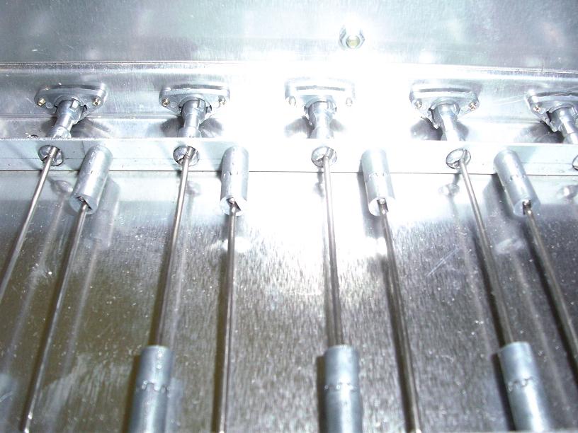

This is the Asiatam version,perfect torsion bar suspension with splined attachment bracket for the spring bar.The early hulls like this one had to strong a spring rod,Asiatam marketed a softer spring.But as the wieght of my TIGER VI passed 20lbs. ths original spring rods were just right.

Hey Perry,Glad you got involved as soon as MOPAR was mentioned guess who came to mind.you told me about the challenger what else is in the garage? And I guess i should mention that the size and type of wire determines it spring tension strength,and the Asiatam spring tension rods are a very small gauge but seem to be very rigid,if I push a control arm to the stop it spring back perfect every time and they sell the rods seperately so maybe you could try the Asiatam torsion rods?

My Asiatam PzIII bars are perfect, but over time, they weaken. I now store the tank on blocks to take the weight off the bars and have noticed an improvement in performance. The KV-1 hull is a different story. Mine came to me with the rear swingarms fully compressed and they never really recovered. I switched the bars around until the front & rear were stiff and the middle were softer. With all the weight in the butt, I had to install a spring inside the rear stop to get it to sit level. This works great, but when the rear bottoms out, it'll bounce just a little.
