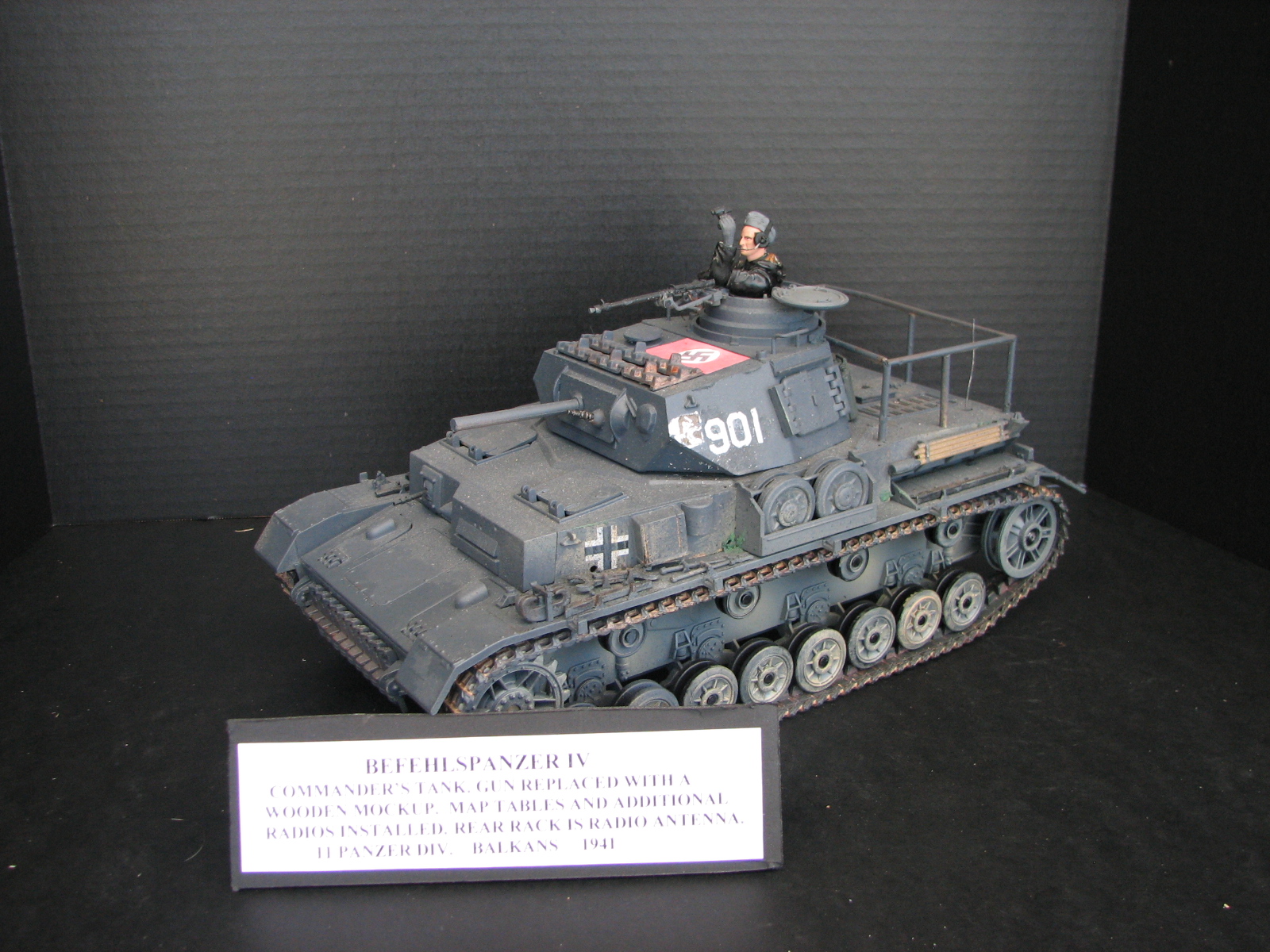

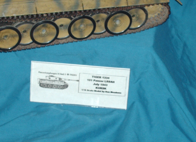

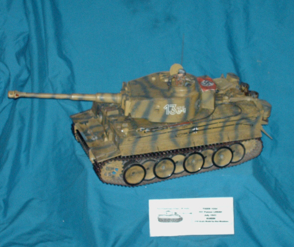

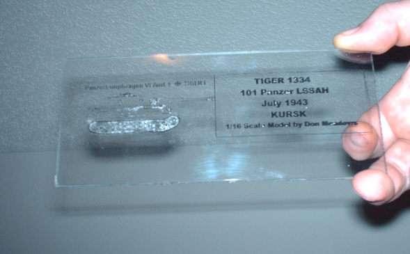

Do you want a really great looking name plate for your pride and joy? Be nice at a show or a battle.
Here is something anyone can make for little or even no money.
Here is what you need.
1. Clear Lexan or Plexi-glass cut to the size you want your plate
2. Clothing Iron
3. Imagination
4. Page from a magazine or sells flyer...like the ones that come in the mail. If when you touch it the
coating starts to come off on your finger, that is perfect.
5. Blank piece of paper X3
6. Masking tape
7. Your Computer
8. Access to a LASER Printer
9. Clear Tape

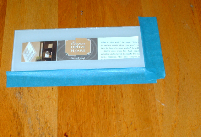

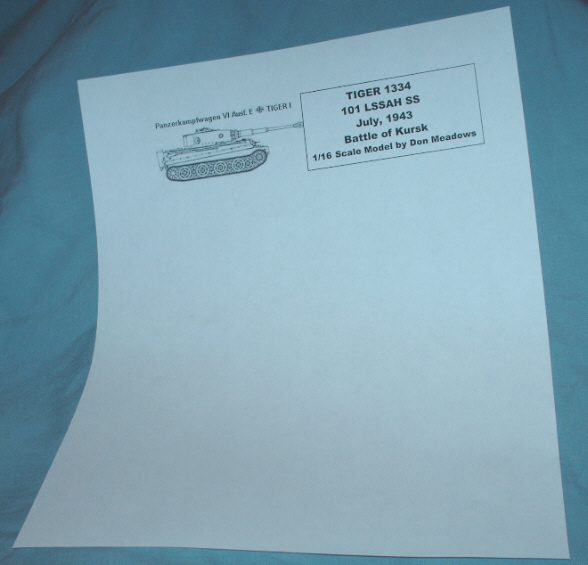

Now use the computer to design whatever your heart desires. What ever you want.
Print a test page so you where where and what side the printer will print on.

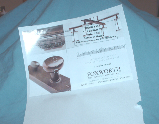

On the spot of a fresh sheet of paper use clear tape to place a piece of the magazine paper to the blank sheet where the image will print.
Note: Use a sheet with mostly text on it. Better yet if you can find a piece with no writing at all.
Feed the sheet with the magazine page taped to it into your Laser Printer. You might have to try this a few times.

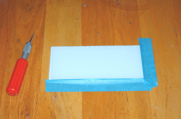

Now lay out your lexan or plexi and secure it to your work surface on two sides.

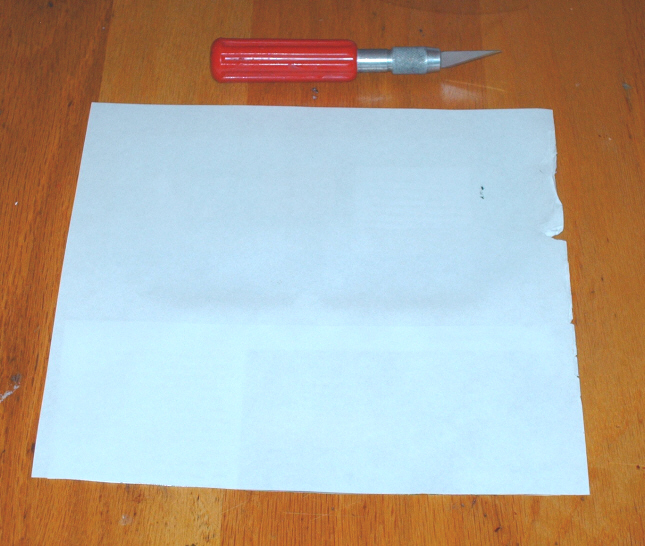

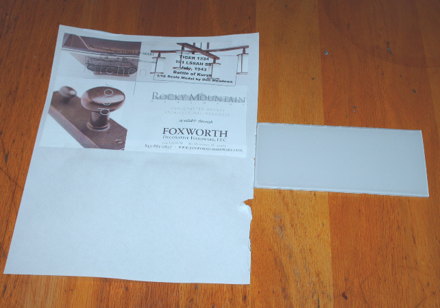

Remove the magaine page from the sheet you used to run it through the copier.
Place the magazine page with the image you printed face down on the Lexan. Static will help here.
Carefully cover the image with a blank piece of paper. Make sure the magazine page does not move.
Take you iron and heat it using the polyester setting. DO NOT USE STEAM.

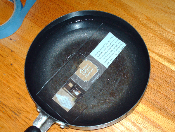

Once the iron is heated press down on the cover paper. hold for 10 seconds, Then begin moving the iron back and fourth. Continue ironing for about three minutes.
Take the iron away and let the lexan or plexi cool to room temp.
When cool remove the cover sheet only!
Remove the hold down tape and place the plexi in warm water. Let it soak about 30 miutes.
You will seethe paper from the magazine disolving and your image clear as a bell on the opposite side.
Some paper will be tough to get off. Use only your fignerto gently rub the paper until it all comes off.
Blot the lexan dry. Use deluted window cleaner to get any residue off.
Now you can use it as is or you can place a background behind the lexan or you can paint it. If you are an artist you can paint the tank, whatever you want.
Enjoy!

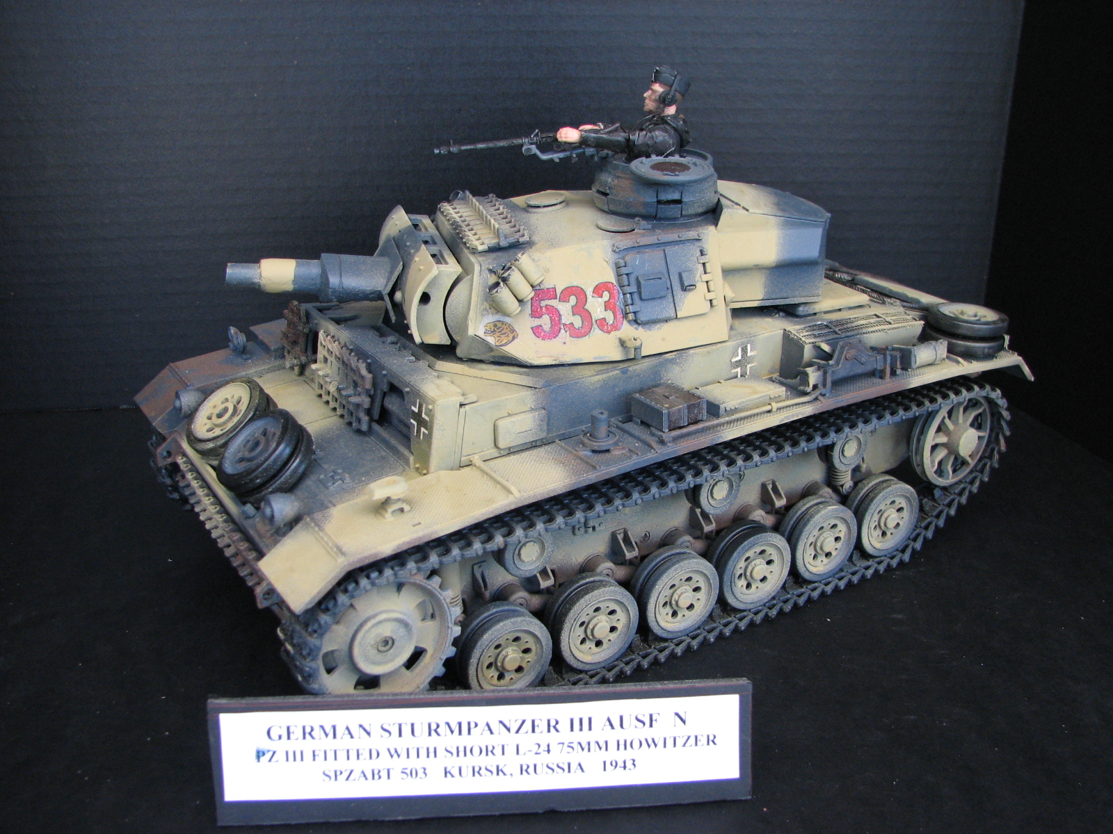

It's a lot easier to do it museum style. Use black foamcor, cut the size you want for the info, print on a white paper leaving 1/4 to 1/2 inch border and spay glue it in place. Very simple, fast and looks neat. To stand it up, simply put a pin at the bottom rear, or prop it against the track.

I had a real hoot doing this. I got the idea while making PCBs for the working tank commander
The idea was not to be easy....not that easy. "We do not choose to go the the moon because it is easy." JFK.
The idea was to add another diminsion to the hobby, to make the display an eyecatcher. I plan to make some more of these and use various backings. This one just had a bit of paper stuck behind it to show how it looks. What I really want to do is have the little tank painted, and a scene in the background and have the name plate section in brass or gold. I have a graphic artist just dying to try one.
