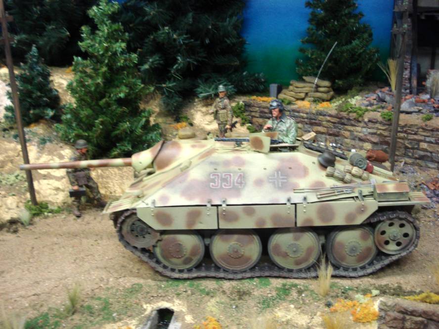

Gentlemen: Thought I’d share with you my recently finished RC Hetzer and tell a little of how it was created. There will be 7 posts in all, so please do not comment until I get these all in sequence.
This model is essentially a resin top hull, metal lower hull, reinforced running gear and lots of brass PE. I also made up a kit of this model and sent it to one of our compatriots in Spain, so in the future I hope we can enjoy some of his pictures as well. If anyone else is interested …..let me know by PM.
I chose the paint scheme loosely based on another model that I had pictures of. It didn’t turn out quite the way I had hoped, but is none the less pretty nice looking. The pictures in this initial post are of the Hetzer setting on the diorama I created for photo shoots. Some of you have seen this before.

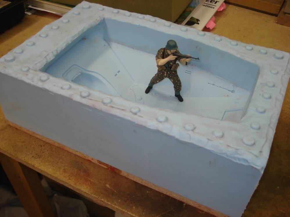

These next set of pictures show the basic kit that I can produce. Its of a “craftsman” nature, meaning that the faint of heart should not take a crack at it. It requires good modeling skills for drilling & tapping fastners, installing all the electronics and radio system (you have to acquire these yourself), modification to the tracks so they are durable, brass fabrication and soldering (if you chose to go the same route I did), and of course painting, detailing and weathering.
I hope these pictures post in the order I have written them up. If not, hope you can figure it out: Pix 1 shows all the basic parts for the project. Pix 2-4 is the Upper Hull casting and rubber mold I made (very heavy and took 3 lbs of RTV). Pix 5-6 is the template and resulting Lower Hull metal pan (only took 4 attempts to get this right….. …..) Pix 7-9 are of the mounting bracket for the Gearbox and how it sets in the metal pan. And Pix 10 shows the cast pewter Return Roller assembly. I had intended to make the Drive Sprocket out of pewter as well, but was unable to come up with a crisp enough casting, so I changed over to a powdered aluminum/resin casting and that has worked just fine. You can see that result (gray color) in the first picture.

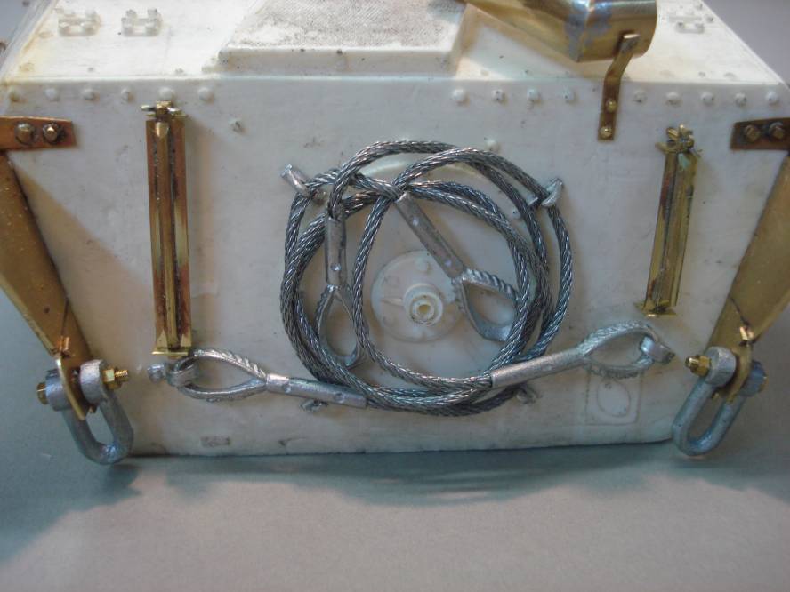

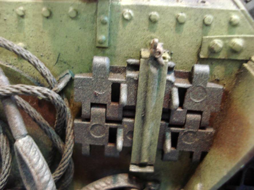

These pictures will show you the brass PE parts I elected to make as substitutes. Someone else may not want to go this route, but I enjoy creating parts in brass, although there is a real challenge to soldering. I like the feel and look that comes with metal, but styrene fabrication can also achieve a durable result. Or one could just use the cast resin parts in the first place……its all up to the modeler. Pix 1-3 show the 4 Fenders. Pix 4-5 are of the Muffler. This was challenge as it was so thin, but I was able to bend and solder it around a wood dowel, and then mate the two cylinders. Pix 6 is of the side Schirtzen and Pix 7 is the MG armored plates (also note that I made miniature hinges for the hatches). The Hetzer had a fixed mounted MG that was controlled automatically from inside. Pix 8-10 are of the wood Jack Block and Tool Box. Pix 11-12 are the Gunner’s Scope bracket and one of the extra Track link Retention Brackets (total of 3). Making the Butterfly Nuts was a real challenge….soldering 3 tiny parts together (see final picture set).

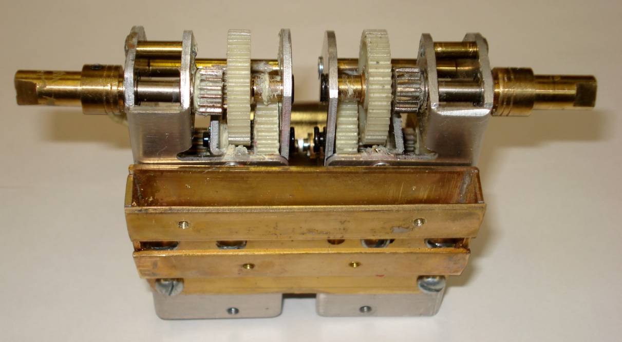

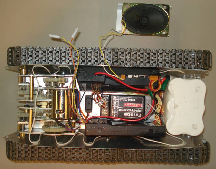

This set of pictures is mostly of the inside electronics and track. I prefer Tamiya controls over HL or Mato, so my design was to accommodate these, but I will add that there would probably be more room inside using HL electronics. Pix 1 & 2 show all of the Electronics and Gearboxes fully installed. Everything is hard wired to save room and to limit excess wires getting tangled. Pix 2 is with the Speaker in place. Pix 3 shows the styrene frame for holding the speaker. This is not the speaker that comes with standard Tamiya models. Because of space limitations, I bought an oblong shaped one and mounted it so it could be easily removed. Pix 4 shows the entire underside of the Upper Hull. I used 2 “mini servos” for MG and Barrel control. The MG servo was rewired so that it has 2 wire actuation (just like a regular motor) and power/speed is limited with a Potentiometer(Rheostat) (see Pix 5-7). There was no room for a design to make the Barrel move both up/down as well as sideways, nor for recoil, so I elected to go with sideways movement only and the second mini servo does that. It still has 3 wire control, so it is plugged directly into the radio receiver. Pix 8 shows the Battery configuration. This is a standard 7.2 volt rechargeable, reconfigured to fit the small confines of the Hetzer. I also installed a charging jack into the circuit so that it can be recharged from the exterior. Pix 9 shows the Track Links and Pins. It was not practical to make 144 individual cast links and to drill 288 holes, nor did I think that resin would stand up under operational demands, so I chose to use Tamiya’s 1/25th scale plastic Panther tracks (bet you could not tell that in the diorama pictures). These are the only ones I could find with the correct double guide fin pattern for the wheels. Using these tracks also required a retooling of the Drive Sprocket to have a couple less teeth and afforded the opportunity to beef them up a bit. The true Hetzer drive sprocket has more pointed teeth, but the modified one still looks good. I cut off all the original plastic hinges in each track link, drilled out two holes in each one and inserted steel pins so that the track would hold together under operation. The Track result is a bit stiff, but runs nicely and slows the Gearbox speed down somewhat. Pix 10 is of the rear of the Upper Hull with most of the brass and cable parts installed.
This model is also wired for Tamiya's TBU which can be seen in Pix 4

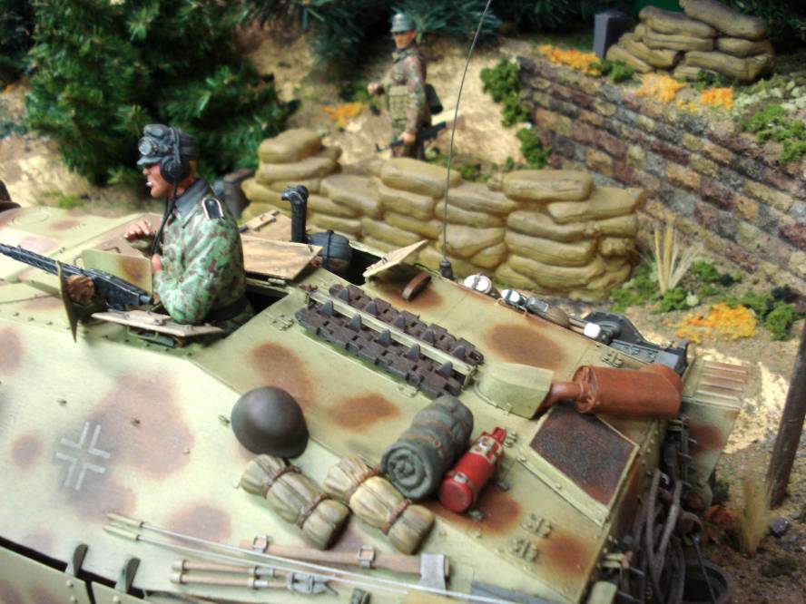

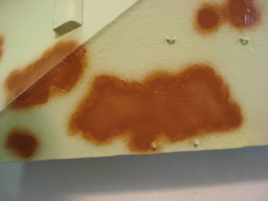

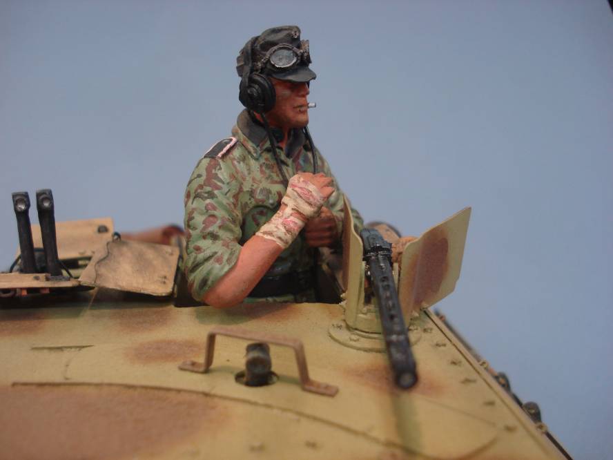

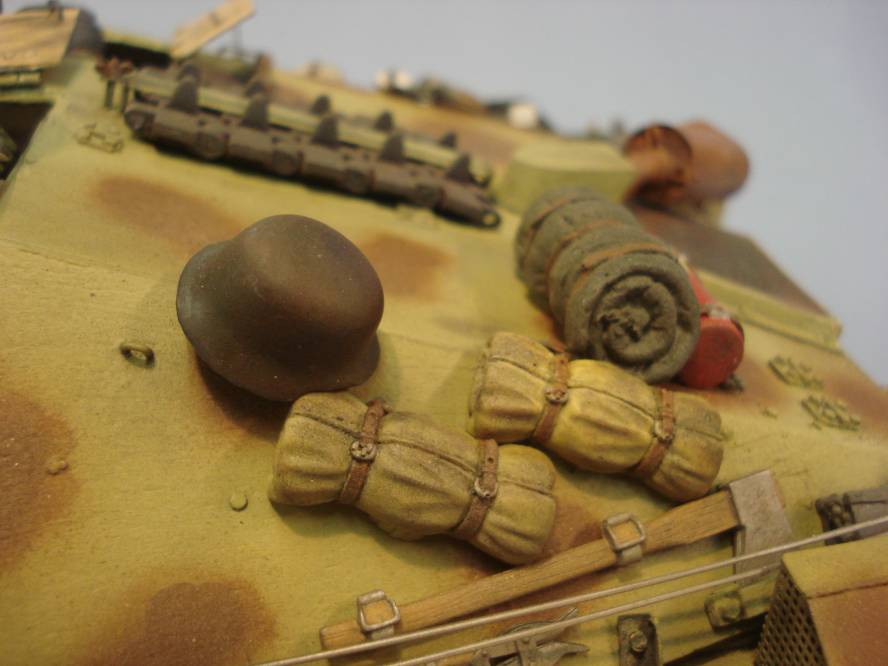

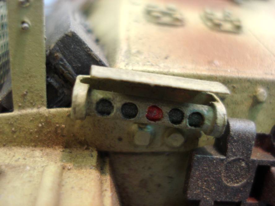

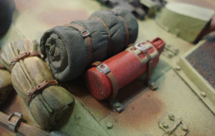

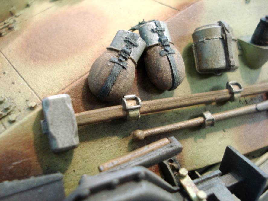

I’d like to show next what was required for the painting design. All the basic work was completed with an airbrush set at about 12 psi. The intention was to have a brown “dot” pattern over a light green base. I don’t normally use acrylic paints, but it was the only choice for the green color I wanted. The brown pattern was done in enamel and over this was added chalk weathering (affixed with Testor’s Dullcoat), with final coatings of very light brown and dirt color sprayed directly from cans. Be careful here, as you have to move the spray can very quickly from side to side so the coating is light. Don’t over do it, wait for it to dry to see the actual effect, and if you are then satisfied, spray the whole model in Dullcoat one last time. In a couple of close up pictures you will note a few small paint spots on the muffler. This is what happens if the can was not shaken well enough and/or the spray can is not moved fast enough sideways.
Pix 1-2 show how the Upper Hull was taped with the pattern. A small hand held hole punch created the hole pattern. Pix 3-4 show the brown paint over-sprayed. The dots were very definitive in Pix 3 and 4, but in Pix 5 shows where I tried to blend the dots and buffer the hard lines some……resulting in pretty much obliterating the dot pattern. Not what I had wanted, but “oh well” once done, you have to live with it. Pix 6 shows the overall model weathered with chalks so that you end up with a dirty diffused look. Pix 7-8 are of the Drive Sprocket, and the rest are close-ups of various final painted and weathered parts.
I like my models to look dirty from operation, so I tend to add chalks in heavy doses, coated by Dullcoat. You can see this effect in a number of the following photos where dirt seems piled here and there.
The next 2 posts show a bunch more of the final painted and weathered parts for your viewing pleasure. As said before, I can make up these parts for you if you want a Hetzer too…..just contact me by PM. Hope you enjoyed all the pictures. Panzerpaul
