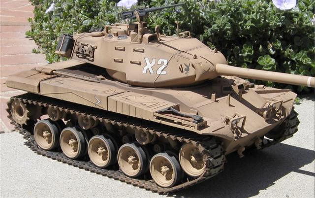

Well guys here it is...just about finished...just need to shorten the antenna and make an Israeli pennant for it. Also might do a little more work on corroding up the little muffler on top a bit, but other then that it's all done...."Baruk Hashem" baby!

Wow, Kev....sick work! You've spared no attention to detail, now I want a bulldog....your's as a matter of fact!

lol... thanks...... I told you the M41 was an underated model....with a little attention I think I like it better then a lot the other WW2 models that are available....I decided to run the plastic tracks/w metal sprockets for now as they look more realisitic(metal tracks wear the paint through where the rubber pad would be and it just doesn't look right),since I cant find metal tracks/w rubber pads anymore.....but my next project is to get some metal tracks and possibly an old inner-tube and cut individual rubber pads and glue them to the metal tracks...but I need a break after this endeavor lol..

Yeah its scaled a bit bigger then it actually was(I'd bet it's more like a 1/14), plus the tracks are a little wider then they really were, but hey these are all just "toys"(I know a few rivet-counters are probably having heart-attacks right now), but hell I just want to have fun and have something that looks "relatively" realistic..... and although this tank never existed its still a nice "what-if" (I do know that the IDF did play around with a few M41's but never had them in mass)....in fact there is currently a company in Isreal that sells updated m-41's(or at least use to), to 3rd world countries so they are very familiar with them..

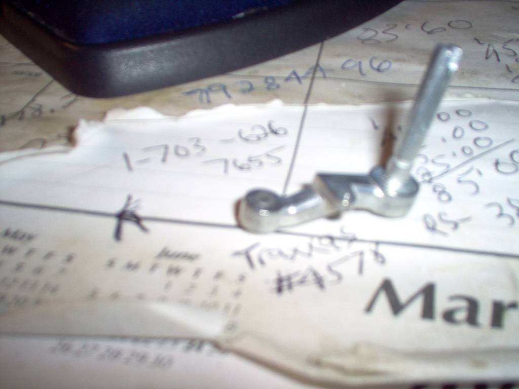

Here is one thing you can do if you have a drill press it makes it easier now it will cost some but you can buy the Tamiya Pershing metal wheel arms and cut off the spring rod on it then dill a center hole the size of the wheel bolt thats on the bulldogs arm now you have metal suspension arms on the bulldog . Then after that get the Tamiya Pershing wheels and buy the ball bearing set also and the mounting shafts and you will have just added better wheels to the bulldog . I had picks but lost them when had to switch from win7 RC2 to win7 final .
Jimmy
Old 06-01-2010 | 07:35 PM
Joined: May 2008
Posts: 2,327
Received 147 Likes on 115 Posts
From: jackson, MI
Default RE: Custom IDF M-41
Ok found them pics I said I lost . Also you may have to do some reworking of the suspension stops they are to long after changing to the Tamiya Arms.
Jimmy

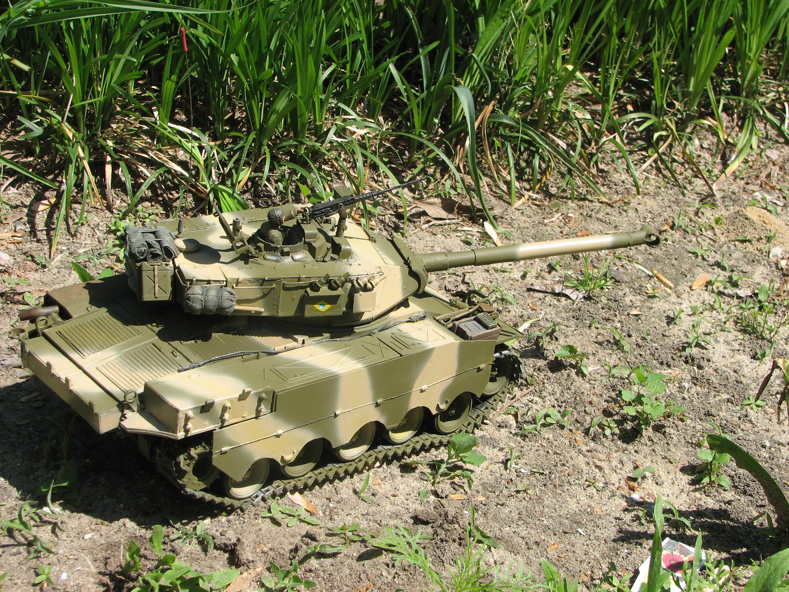

how 'bout this Bulldog..looks even meaner...and was!
