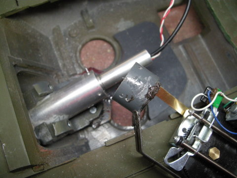

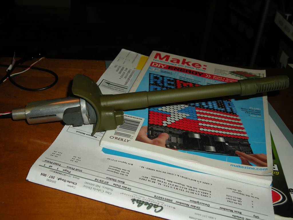

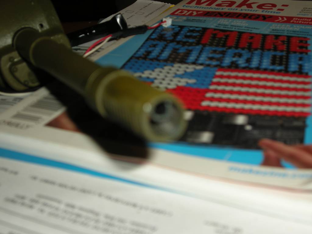

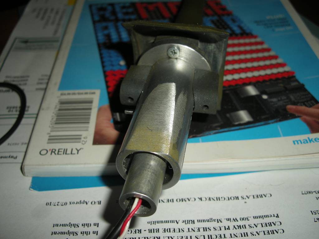

Got a few more details done today. Here are some pics' of the gun tube.
I opened the bore near the breach to allow both the firing emitter and the gun flash to pass through the barrel. There is a pic. of the muzzle, kind of blurry, but it shows the emitter in a black tube and the flash next to it. I also have been fitting and selectively grinding on various parts of the mantlet and the upper portion of the breach to allow a greater and smoother gun movement.
I am also working on the interior to set up recoil and gun movement. i will post some pics later to show how that is coming along.

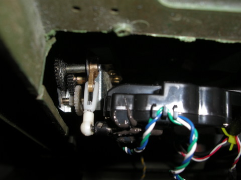

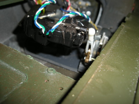

Ok the lower hull is done. not elegant but functional. I have driven it around my battle field and it runs real nice. here is a pic. I located the DMD in the Heng Long battery compartment and put the battery forward for better weight distribution. The speaker box is an integral part of the hull to increase stiffness. It should work fine.
I started on the recoil, elevation and traverse mounts this morning. The gimbal provided with the kit is a bit hard for me to work with but i have not given up on it yet. lots of tweaking to make the mantlet traverse without binding. i will post pictures of that later.

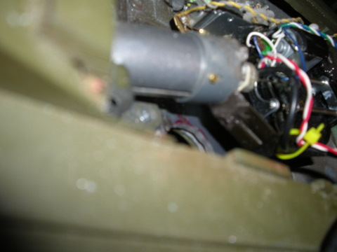

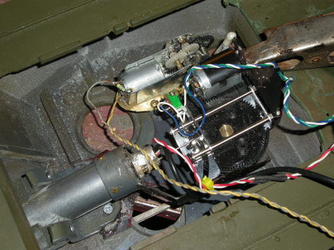

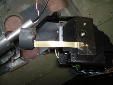

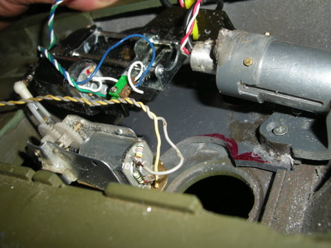

A bit more work done. I have extended the trunnion that came with the kit to allow a mounting base for the elevation. I made an adapter to mount the recoil stay n the back of the cannon assembly. In the picture i am bonding a swivel mount at the back of the recoil assembly to attach the elevation arm. I originally was going to use modified servos for elevation and traverse but i had couple of tamiya units that i thought to try before going the servo route. Sorry for all the dust in the photo as i have been doing lots of fitting and grinding to make sure everything fits. For a large area everything still seems real cramped. The black goopy stuff is J-B weld, one of my favorite epoxies. After this batch sets i will try the elevation and if it works as it should i will start fitting the traverse motors. Hope am not boring you guys too much. I hate close up pics as they how work being much more crappy looking then it really is.

I added some pics to my previous post for you Duane. A couple of things. 1. in the second pic. you see a metal pin in the side of the which is used as a locator to keep the barrel from rotating and to limit it's forward aft movement. That pin caused me nothing but heart ache when used with the tamiya recoil so in my final version i took it out. 2. in the 3rd picture there is a brass strip bonded to the recoil stay. because of the pin problem i mentioned the stay was twisting. after removing the pin i removed this brass strip as it was no longer needed. I hope these pics help you.

After seeing stuff from volvospeed and yellowshaker i am embarrassed to continue but i will. here is the traverse mechanism. It is a low profile servo with a standard ball and socket arm but i use a camera controller circuit from Dinoysus Design. This adapter allows the servo to move slowly and stays where it was positioned last. I have these in my Elefant and my Panther F. I included reference info for the adapter in case anyone wants to try them. I also finished mounting the IR receiver so I can now begin to finish detailing, final paint and get to war. I have been doing interim testing so it should complete pretty quick. BTW i blasted off all the grinding and sanding dust.

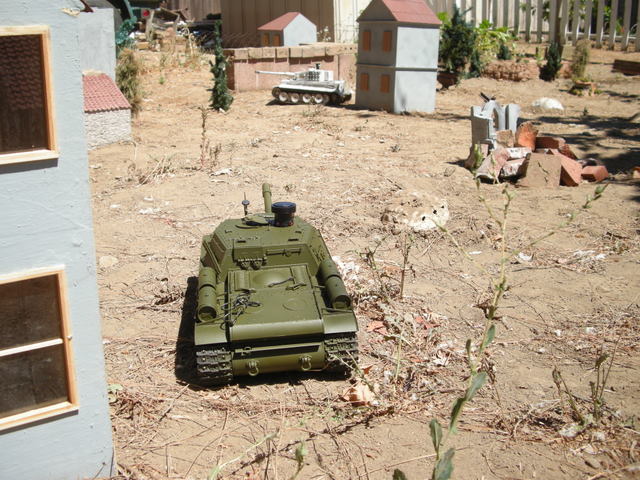

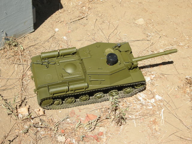

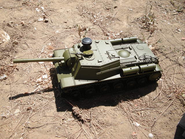

Pretty much final pics. Just need to add some graphics and perhaps a light weathering. most of my stuff looks like it has been around 100 years so i might consider this a fresh factory issue.
For the slightly faint of heart, IMHO, this is not the easiest kit in the world. There are lots of thing in the El-Mod kit that plain old "do not fit" such as the railing stanchions and a few other bit parts. The assembly 'guide" is a bit vague and could use some improved graphics as it is not real easy to see the correct placement of some items. However casting quality is quite good.The elevation/traverse trunnion is D** ***T in my opinion and i will do a go back and make it better later. But here it is on the field of valor stalking a big kitty. Anybody have an idea of the interior color needed, for the inside of the hatches? I am thinking of a buff or yellow white but i could use input.
