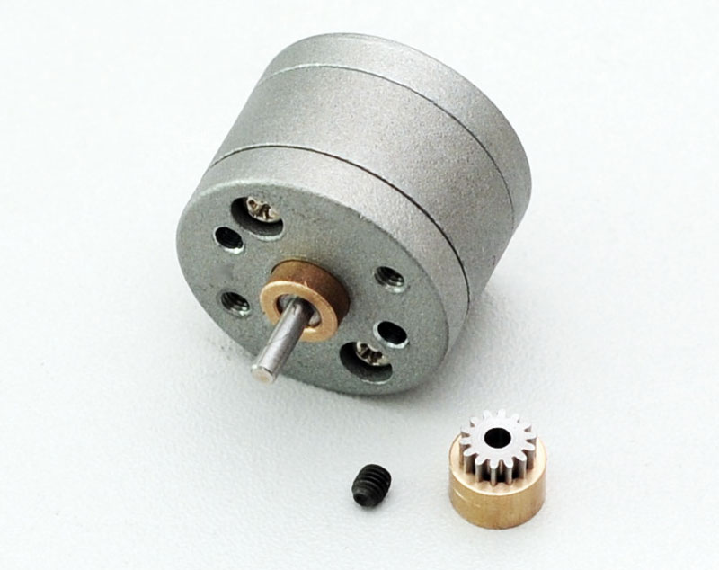

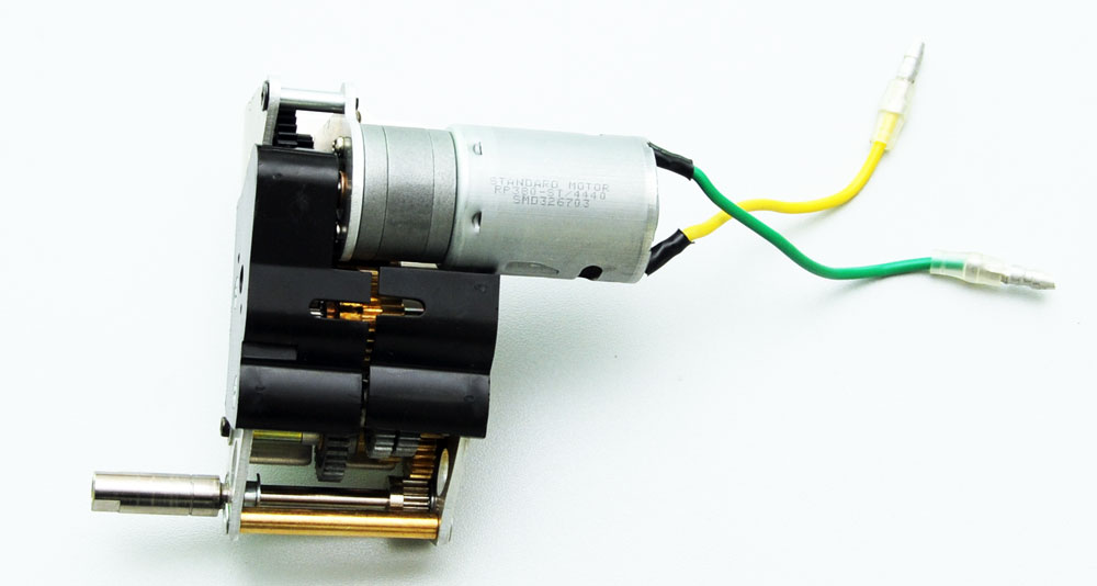

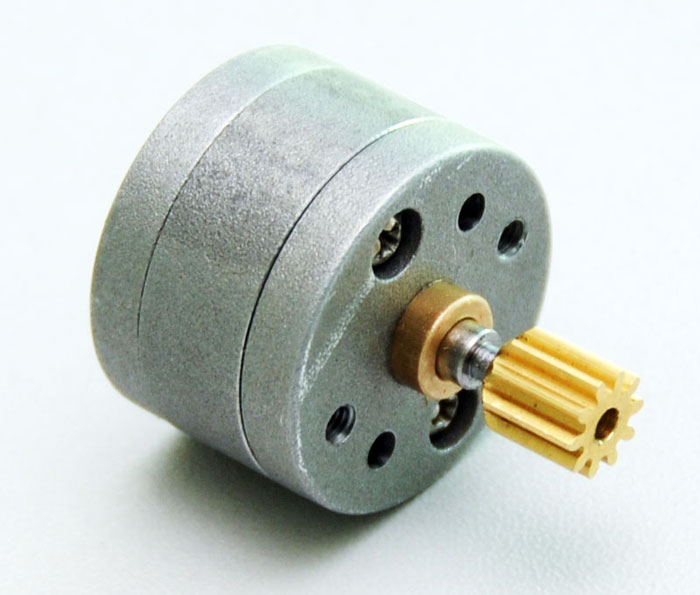

Hi I am getting a Jagdpanther and after adding the 3:1 from ETO and seing here that they will not fit i started to do some looking and found this.They are from <font size="5"><font color="#666666">RC4WD Ultra Compact </font><font color="#3366cc">2:1 Gear Reduction Unit for 380 Motor.
What do you guys think ?</font></font>

10 tooth pinion?

Say Bob I looked at the RC4WD site and found this would this work for the Jagdpanther or do it look like it would make the motors to long .
http://store.rc4wd.com/products/3%3A...540-Motor.html

Jimmy, as long as you are using short cans it should fit in a Panther. Panther has virtually the same usable width inside as a Tiger 1. However, our motor output shafts are 2.28mm diameter, and this one lists 3.17. Ergo you will have to either bore out your existing pinion gear to the 3.17 diameter (actually 3 mm will do it) or use their pinion gears, which you then must ascertain are 48 metric pitch. Otherwise, should work. However, I'd go more for the original listing, as obviously it bolts up to the Tamiya Type 3's as in the photo.
The only fly in the ointment besides those mentioned is, will this hold up to pulling our overweight beasts around the countryside and over hill and dale, and the rigors and abuse of combat.

I would be more interested in trying the 2:1 gear reductions before the 3:1 as the latter makes the tank too slow. The 3:1s on that link should fit but the shafts will not match the pinions so you will need to alter them. You will also soon be needing a mini gear puller as well if you want to play mix and match with gearboxes and motors. Some pnions are pressed on and some are secured with a set screw. You will also need to verify the pitch will match on the gears used. I use a heat gun to warm up pressed gears and a mini hammer or spring loaded center punch to fine set the pinions. Measure the offset and mark the shafts to enure proper alignment. NEVER hammer or press on the gears without supporting the shaft from the opposite end of the motor. I have been a auto mechanic for over 30 years and one trick that I use for the tanks is to insert a thin strip of paper between the teeth of the gears to provide the best relief or gap to eliminate binding.
